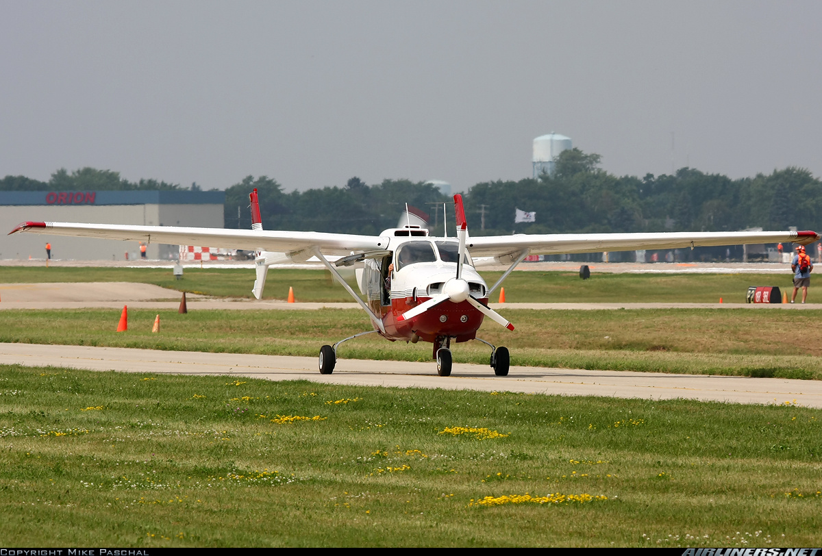

Since installing the MT composite props 6 years ago (can't believe I have had them that long) I have notice a significant decrease in vibration related issues. Rear muffler is a good example, I normally figured at least every other annual to repair cracks. I have had none since the MT's. The composite material (primarily beechwood) absorbs the vibrations caused from those lovely Continental engines. With the aluminum blades this vibration is just amplified. Great article on composite props in the new Aviation Consumer. So my suggestion is to balance things to a more extreme measure as much as possible. During engine overhauls or prop overhauls balance is the key. I would have to think that for the P and Turbo models with more exhaust stuff it would be even more important. Bottom line, composite props should be a legitimate option if it comes up on your aircraft. You have to do both front and rear at the same time and that may be a show stopper for most to swallow.

Excellent recommendation on the MT Props. For me, however according to the MT website, they are only STC'd through the F model. The later G's and H's are not yet approved under the STC. Since I fly a P337H it doesn't work just yet.
In any case, for anyone doing a pre-buy on any 337, I would suggest checking the rear cowling, engine baffling, spinner and spinner bulkhead for vibration related fatigue cracking. The spinner bulkheads are costly to replace and hard to find. On my earlier 337 (s/n0028) I replaced the rear spinner bulkhead twice due to cracking, I used to joke that i burn 20 gph and get 400 hours per spinner bulkhead.

As far as I know the MT's are now approved for the later model (G&H). Not sure why MT does not indicate this on the website. I know of one G model aircraft with MT's.

Yes, MT's are STC'd for the full 337 line, here is a link to the STC:
http://rgl.faa.gov/Regulatory_and_Gu...2?OpenDocument
