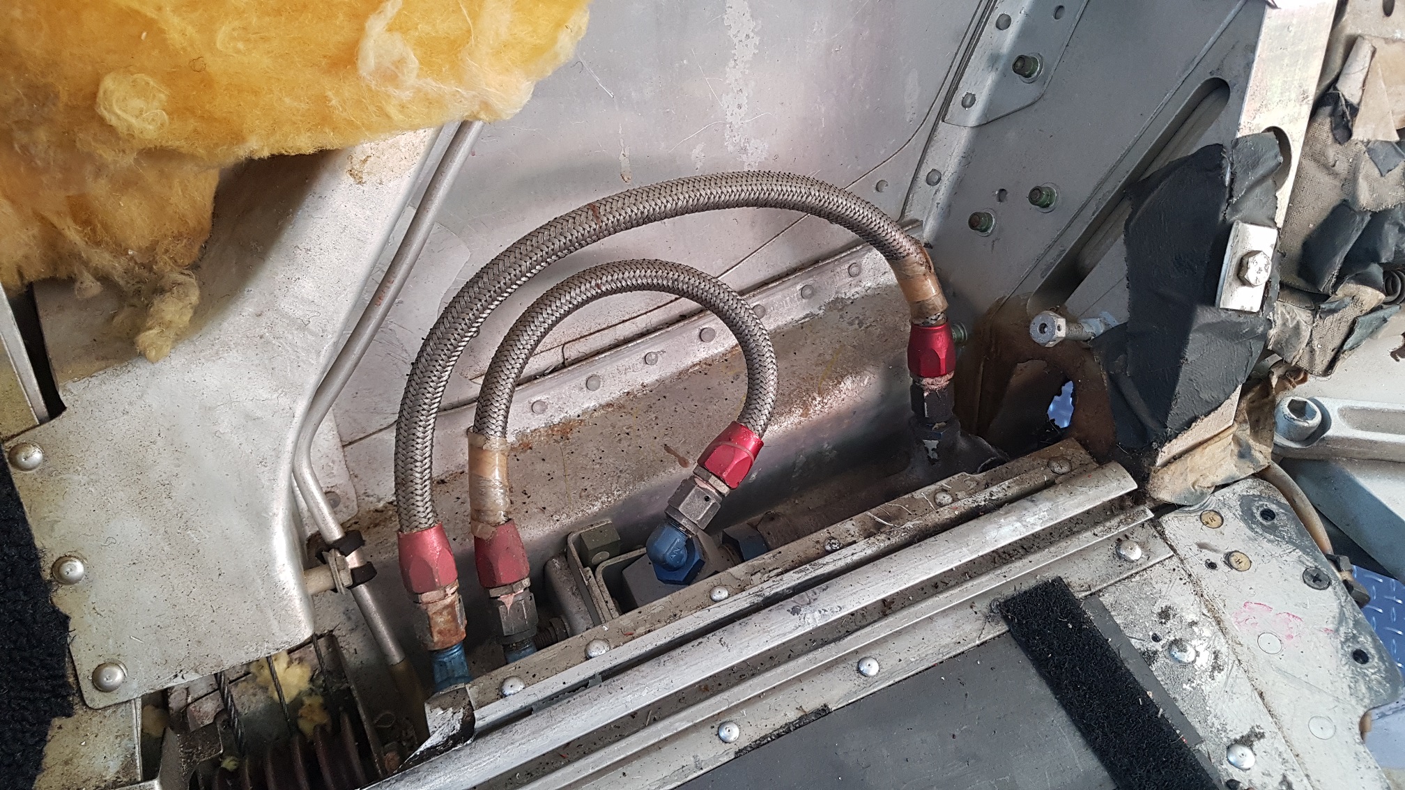

Gear hoses
Getting all new all new hoses put on for the gear Do the hoses to the main gear actuators have a braided cover or is this something some one did later
Mechanic was told this hose was not recommended for hydraulic line
Any information would be appreciated
Thanks in advance
Unread 11-19-19, 11:47 PM
Join Date: Oct 2016
Location: I64
Posts: 83
https://specialtyhose.com/aerospace-aircraft-owners.htm
Unread 11-20-19, 09:33 PM
Yes, braided cover
