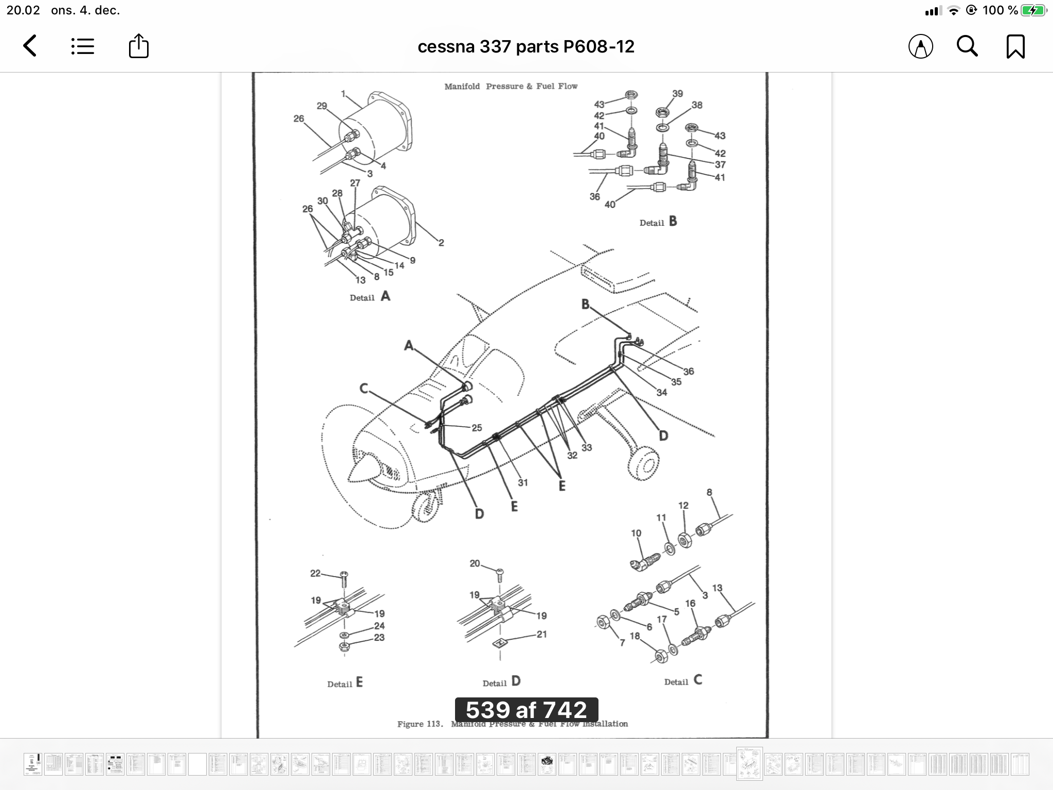

I am assembeling front and rear Engine on P337 and where the primer pipes join induction system there is similar pipes before and after throttle body on induction pipe going thru baffel and to fuel flow meter
Does anyone have a picture of where these pipes go so I don’t get them crossed.
My rear engine is turning less rpm at wot than the front and I’m looking for reasons

I do have parts catalog but not very clear re which pipe goes to before and after throttle body

If I'm understanding you correctly, the line before the throttle body is to the fuel flow gage vent. The line after the throttle body is to manifold pressure gage.

Pic
Here’s the manual schematic
