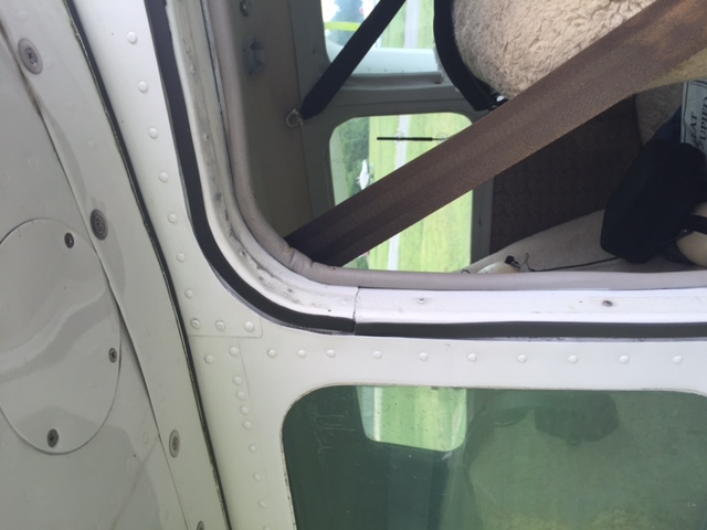

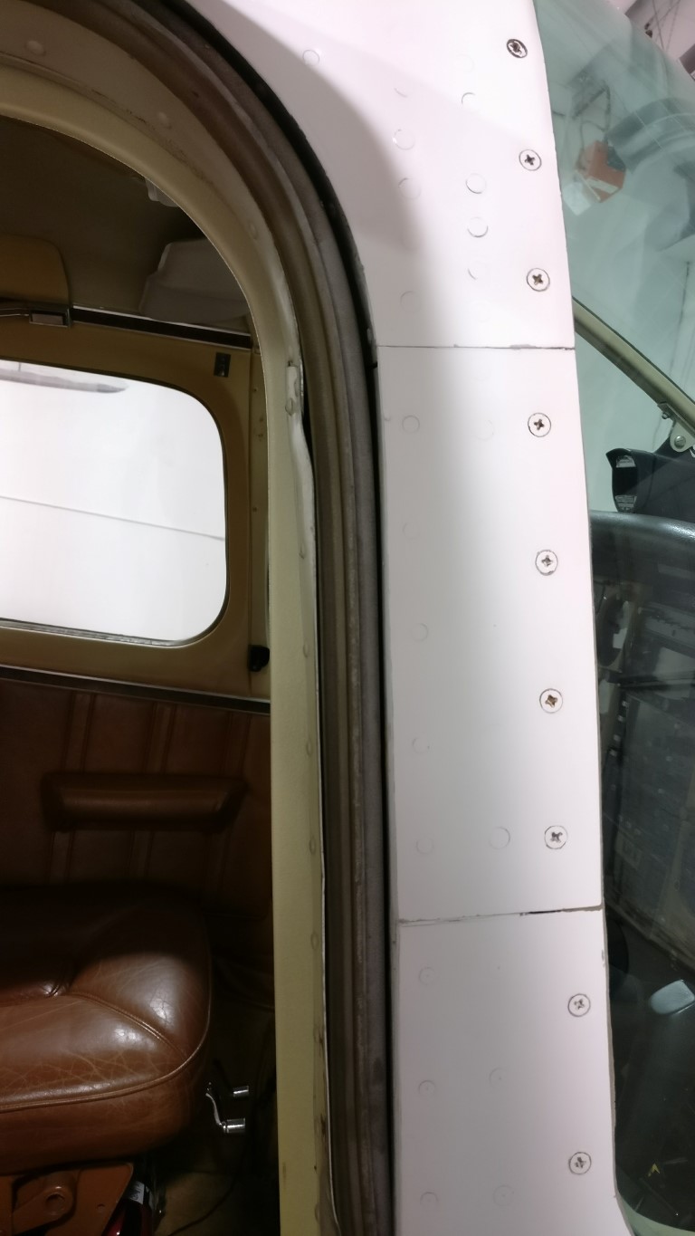

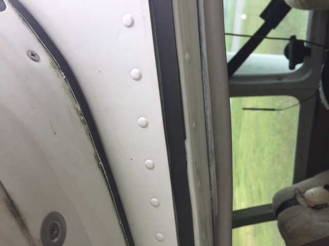

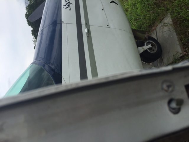

Unread 08-08-16, 05:09 PM
bigcheese
Posts: 348
Talking See images below
I have attached four photos.
The tape is neoprene 1/16th x 1/2 with one side adhesive,
'closed cell' which can be found on ebay.
Of course my photos are out by 90 degrees, ...but 'work with me people..'
Easy!
The sticky side forms a good seal with the door frame and door.
When you press the two halves together, they forma good seal with each other.
I even found an original Cessna door seal new in bag on ebay.
But this works just fine, and is easy to fix as well.
D

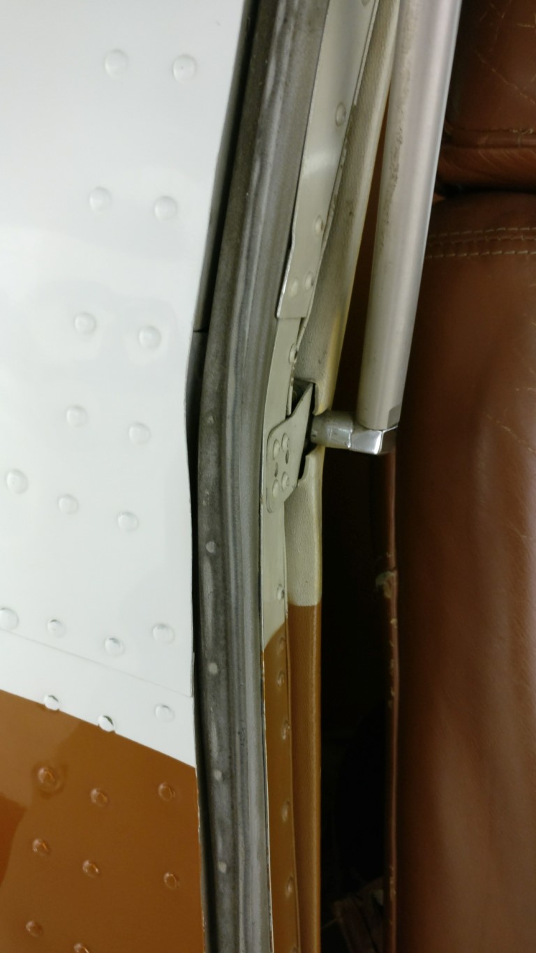

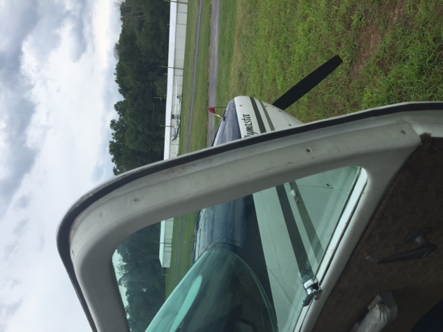

Unread 03-16-17, 02:38 PM
kilr4d's Avatar
kilr4d kilr4d is offline
Join Date: Mar 2016
Location: CNC3
I'm looking to replace the door seals on my G model with the airstair door.
Suggestions?
John
Edit: Added pics.
