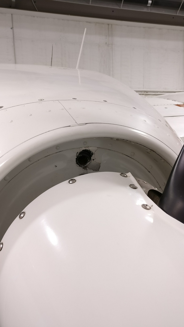

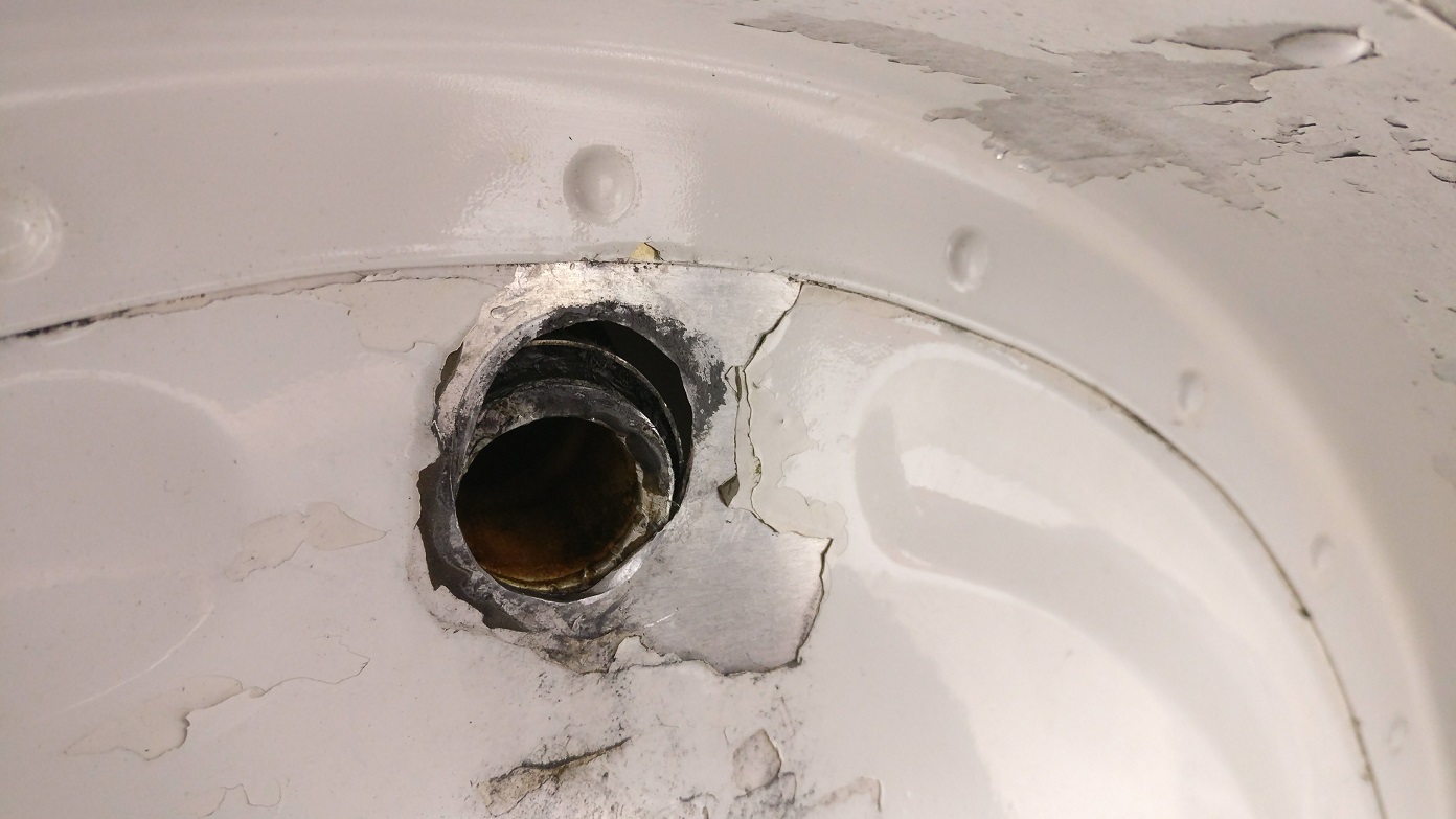

As per the attached pics mine is broken and I can't find one anywhere; neither can Don Nieser. Cessna part# 1250101-6
Can someone post a couple pics of theirs? My mechanic might have to fabricate one.
John

It's just a tube nipple made of aluminum. Maybe for like 3/4 inch hose I would guess. If you have a good welder that you work with they should be able to work it out. The longer part is on the inside of the cowl with a tapered end to allow the breather tube to slide on. It also has a ridge all the way around that will keep the hose clamp from coming off. Try McMaster Carr they may have a nipple similar to what you need of aluminum and then clean up the cowling and weld in the new one. The original may have been pressed in.
I have a photo that I think is on the forum of a mod that someone did that took the breather out the bottom of the engine nacelle instead of all over the prop. You might search breather on the site
Thanks Herb. There's still part of mine in the hose. I'm going to pull it out and see what it looks like.
