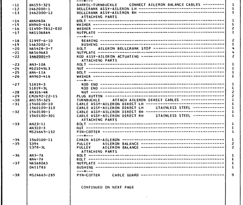

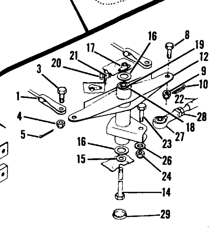

Unread 06-25-15, 02:55 PM
Try this to Chris. Don is a great source but this may be an option44
Power Packs Plus shows a used unit. Their phone number is (775)209-9001
http://www.controller.com/list/parts...1-5&pst=starts
Nice PHOTO of one here http://www.texasairsalvage.com/main_...?editid1=68324 $575.00 used
For the benefit of others attached is the breakdown of the part #22 on the figure
Cheers
