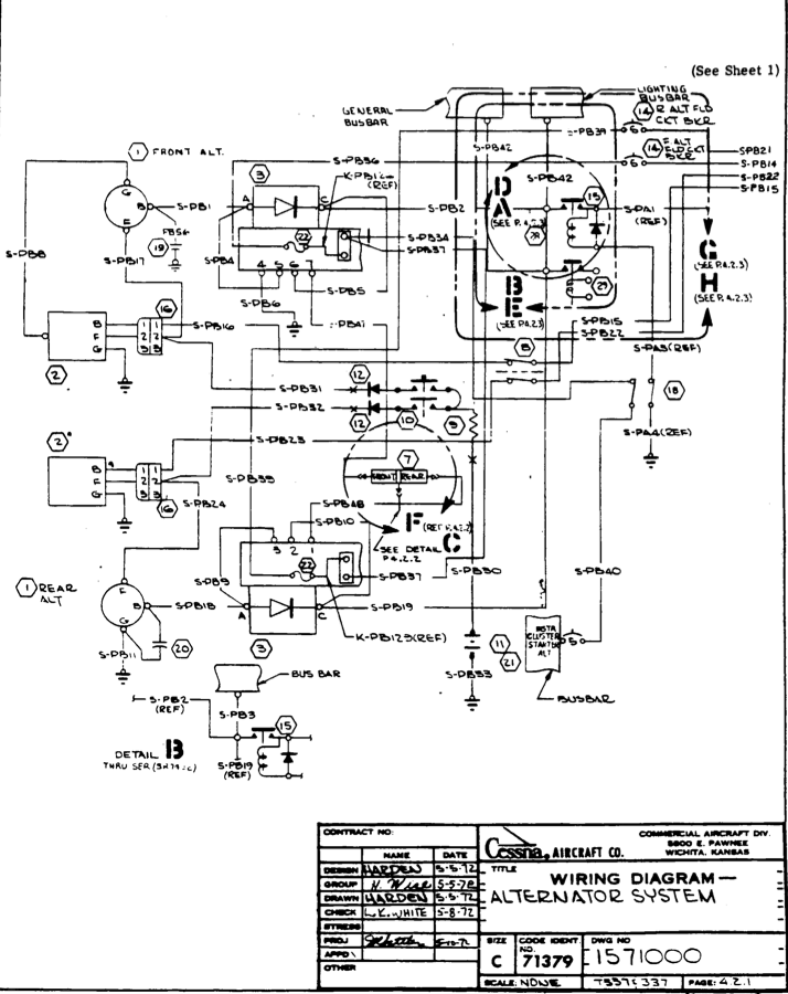

Looking for a wiring diagram for the dual alternator control on my 1974G. Any assistance appreciated.

Do you have the diagrams from the Service Manual? What do you need that is not in the SM?
Name:	Screenshot 2014-10-13 14.40.01.png

I have been through the service manual recently and have not been able to locate this particular drawing, I have found and used other drawings within the SM, but his one eludes me.
I'm in the US at the moment and not able to get my hands on the SM, The dual alternator control had been removed prior to me obtaining the old girl for repairs, which were done but never re-installed. I have purchased another unit and have installed it based on some hand drawings provided when the original unit was removed for repair, needless to say I want to double check.
