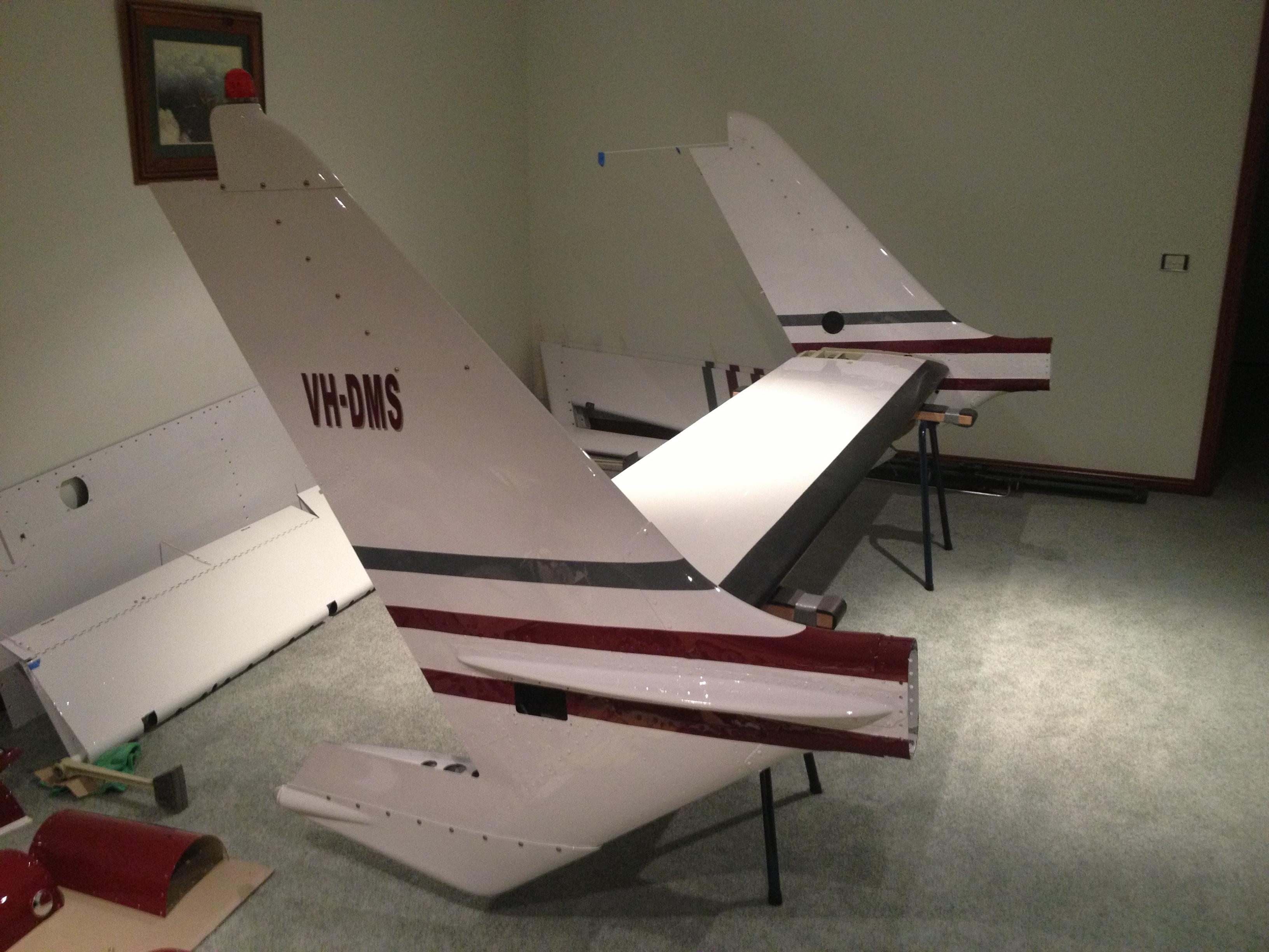

Ps: Guys almost finished the tail, just need to replace the pins in the elevator arms, then re-assemble the rear, aim is for this weekend - any guidance on removing the pins?

Cheers Dave, that's really helpful information. That wee pic gives a glimpse of what promises to be a good looking ship! Well done!
