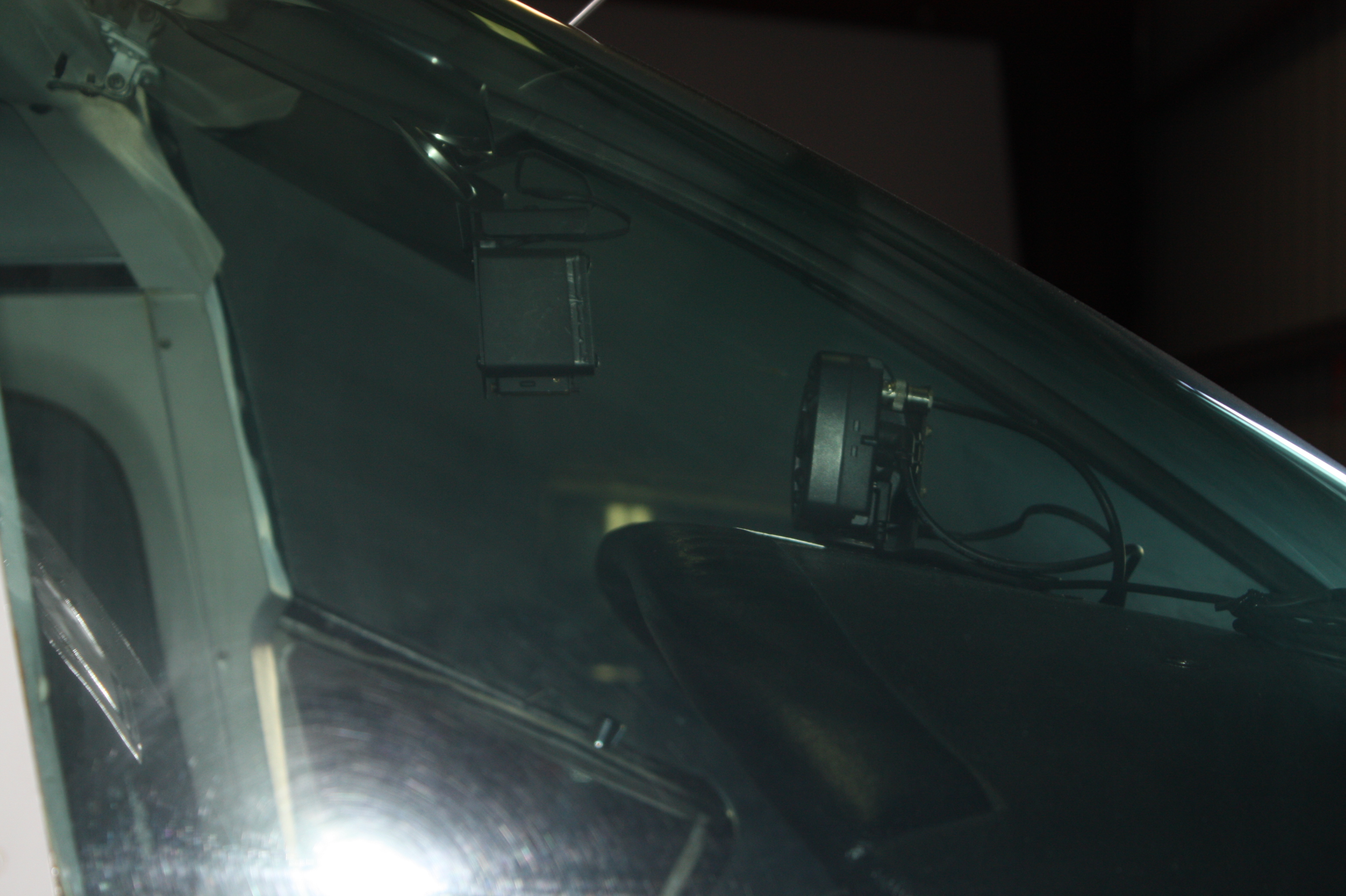

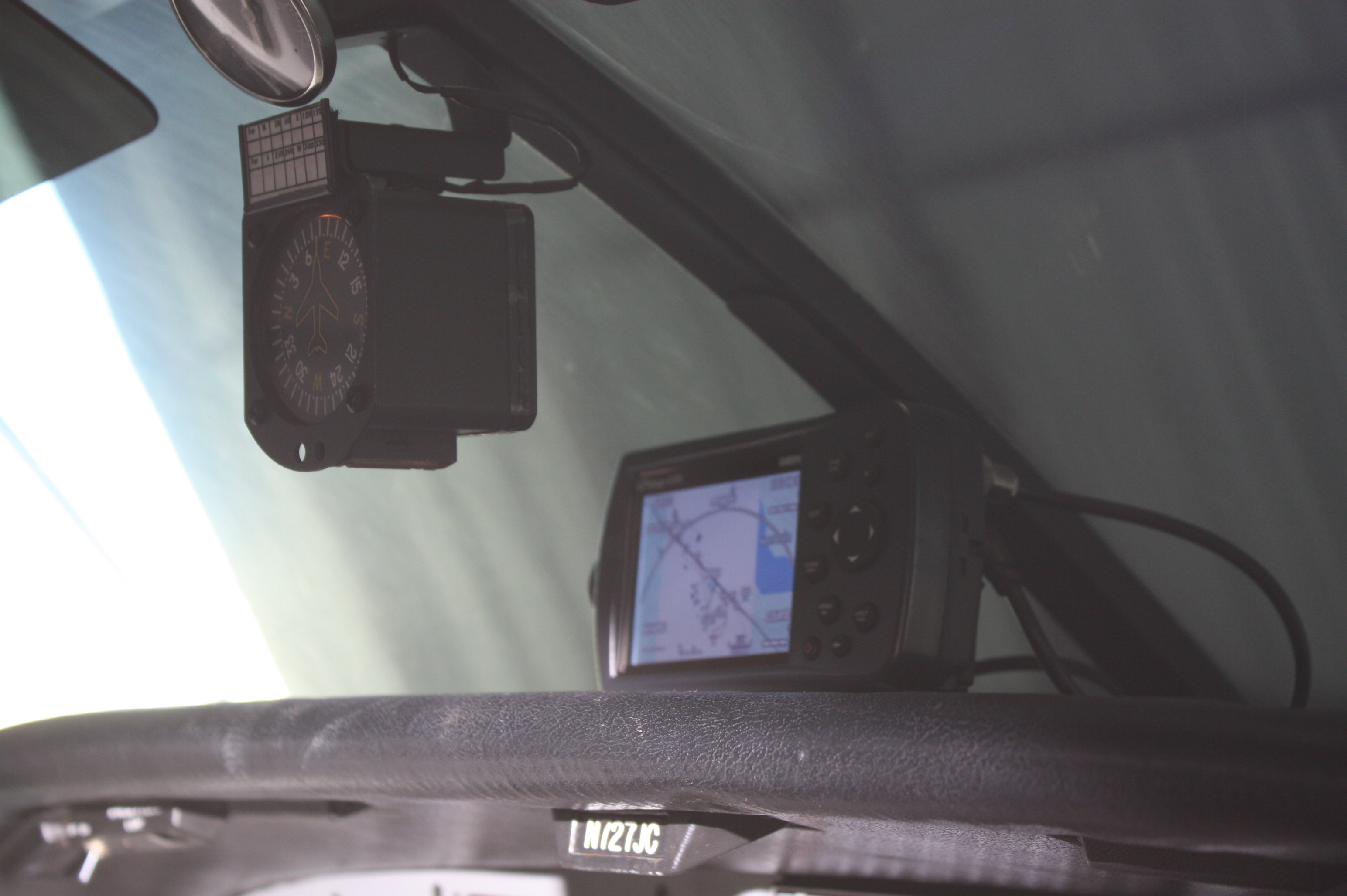

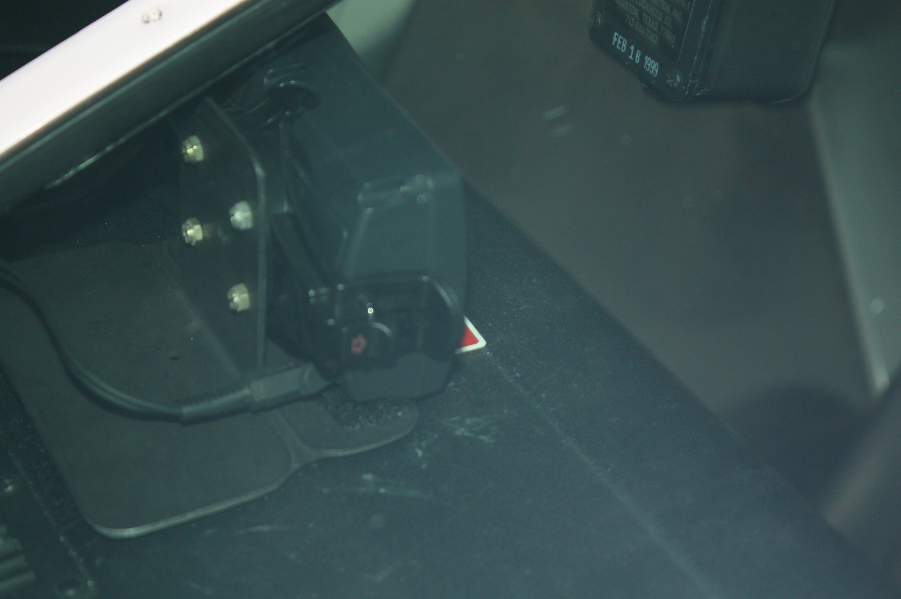

I made my own bracket which I velcro to the top of the glare shield. I used the clip from the yoke mount that came with the GPS to attach to my bracket. I also made a bracket to move my compass off the glare shield, and it hangs from the OAT. Permanent antenna installed on the roof, with wire running up through the trim on the windshild center. You can see a pic of it from the front on the post of my metal panel. If you need better pics let me know .
