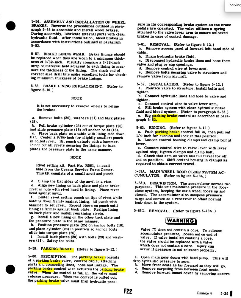

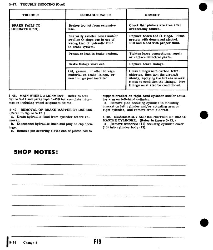

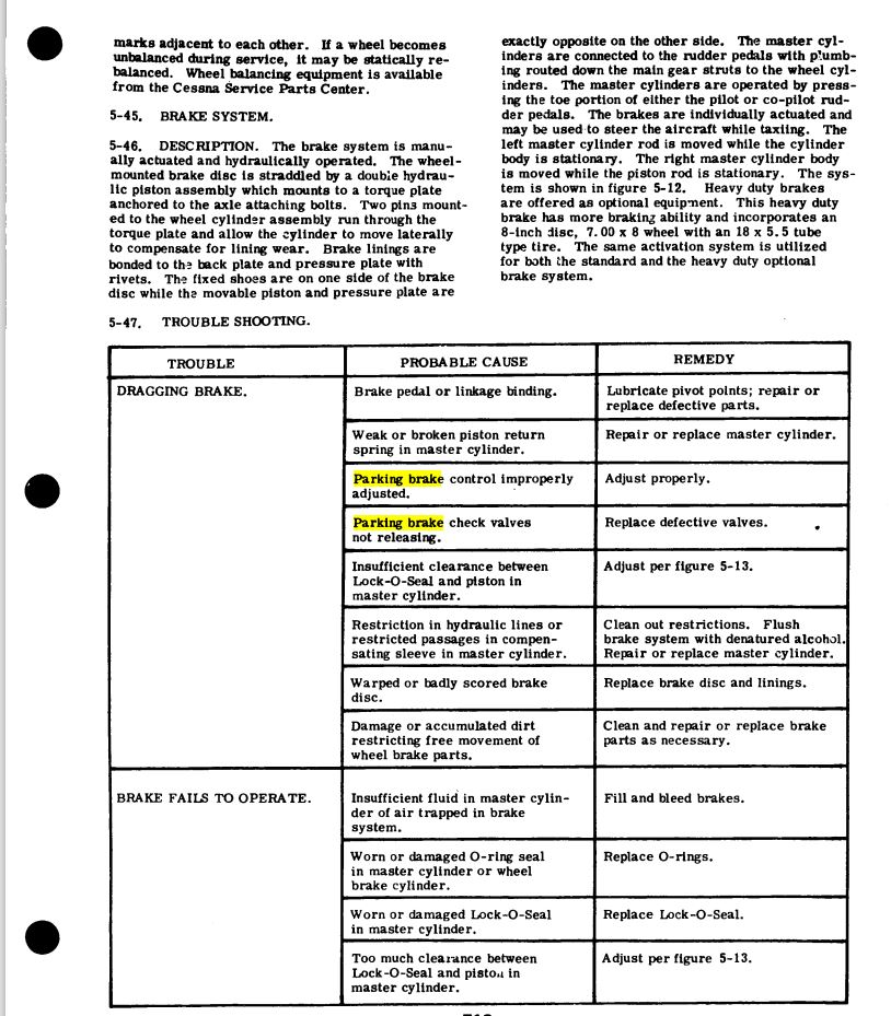

My understanding is the parking brake valve closes the brake line while pressure is held on the brakes, allowing the brakes to stay "set", with the pressure remaining in the line.
A failed parking brake valve would potentially keep you from setting the parking brake, but unless its also leaking fluid, I don't see how it could affect your brakes.
Attached are a few relevant pages from the P337H service manual:
Attachment 2905
Attachment 2906
Attachment 2907

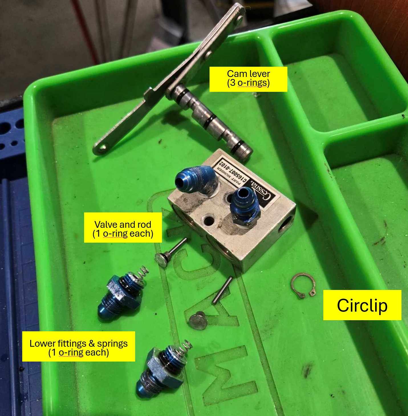

Parking Break valve service (G/H models)
1 Attachment(s)
This is applicable to 337 G & H models with the lever-type parking brake handle.
The service manual and the parts manual have no procedures to rebuild the parking brake valve. So my buddy dared me to open it up and see if it's rebuild-able. It is, with standard o-rings suitable for 5606 fluid.
Use Service manual procedures to remove the valve from the aircraft.
Remove two lower hydraulic fittings, exposing valves, rods and springs. Remove circlip from cam lever and pull cam out. Replace 7 o-rings and re-assemble in reverse order, then reinstall in aircraft per service manual.
Good wrenching!
Attachment 3100
