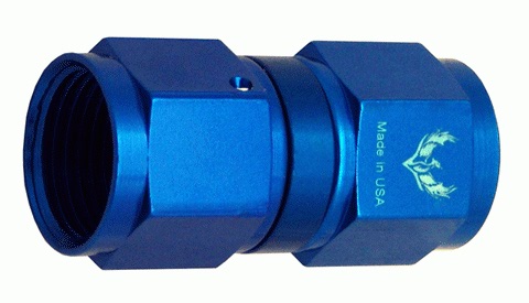

GAdams 04-14-23 01:49 PM
My brake line swivel has seen better days. Someone previously beat the crap out of it and it is no longer serviceable or repairable. I found a replacement part which is a Phoenix C6-4-6. Cost about $10 plus shipping. Using FAR 43.13 to install. Far better replacement part than the original. Early serial number Skymasters had no brake swivels. I don't know the history on the swivel but I assume it was an improvement done by Service Bulletin in the early days. Then incorporated into later production airplane.

mshac 04-15-23 12:46 PM
1 Attachment(s)
$8.75 - https://www.aircraftspruce.com/catal...s/04-02145.php
Attachment 2914

It appears that the fitting is rigid when you tighten it up, if so that is entirely different than the ones in the P models
wslade2 04-16-23 11:54 PM
This swivel only has rotational movement in one axis. The OEM swivel not only twists on the long axis but flexes angularly all around the compass. It was mentioned that originally earlier models didn’t have it. Probably added to reduce torsional and flexing stresses on the line (which can lead to line failure). This Phenix swivel may not be an acceptable substitute.

GAdams 04-17-23 08:04 PM
We did a gear swing with the swivel removed and confirmed there was no interference or stress on the line. The line we have is teflon and the IA would be more comfortable changing the line back to the original material if we were going to eliminate the swivel. I wanted the swivel and so we installed the swivel and confirmed proper operation of the gear with no brake line stress, wear points or interference. The IA is happy and the aircraft has been returned to service.

wslade2 04-18-23 10:23 PM
Confirming that the substitute swivel by Phenix works is some pretty awesome news. Solves a major conundrum for 337 mankind.
GAdams 04-19-23 07:39 PM
Eating Crow
Hey Skymaster People, After further investigation it has been determined that the aforementioned swivel does not swivel quite enough when tightened down. I owe you all a big APOLOGY. We cannot find a OEM swivel nor a suitable substitute so we are going to install a new teflon/cotton/rubber hose as per the original parts catalog for older 337's and proceed with that fix. We will inspect frequently for wear and report back. Again I jumped the gun from enthusiasm and was too quick to post my findings. So Sorry. BBQ crow tonight for dinner.
