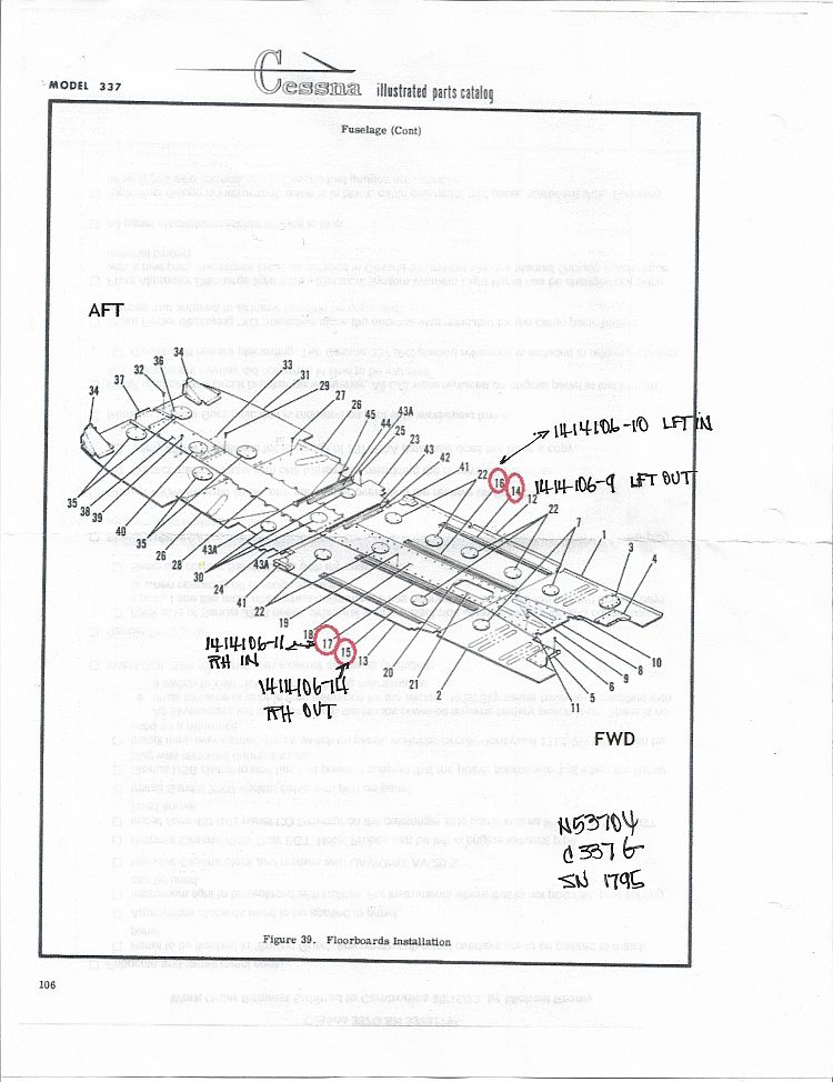

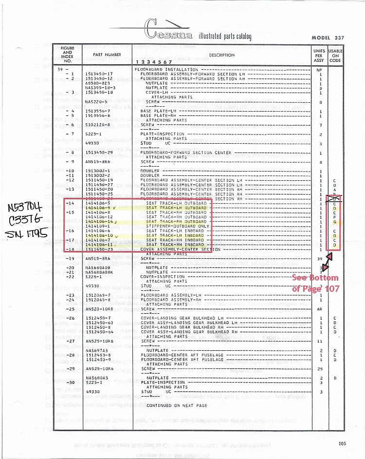

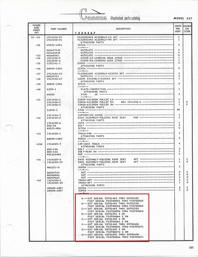

I'm back on this for my "G," SN 1795. In the parts catalog, you need to pay close attention to the column on the far right side of the page--"Useable On Code" and the code table at the bottom!
Overall the part numbers for all the various seat rails are the same (1414106); the "dash" is what is important if we could order an OEM part. This is all probably a moot point as there is no part source, but it will be an important note on the drawings and for McFarlane as they asked for the same so that they might help another avoid the measurements.
For other "G" owners, I've attached three pages from the illustrated part catalog for reference. As soon as I have drawings, I will post those as well. I might be a bit; I just had rotator cuff surgery.

Here are the pages from the '77G Illustrated Parts Catalog, along with my notes.
Attachment 2840
Attachment 2841
Attachment 2842
This reference indicates that four different rails are used in the airplane. This is not what I found in SN 1795. On the Left side, both the inboard and outboard are identical. On the Right side, both the inboard and outboard are identical. The left and right sides are different, but not the in and outboard tracks for the seat position.

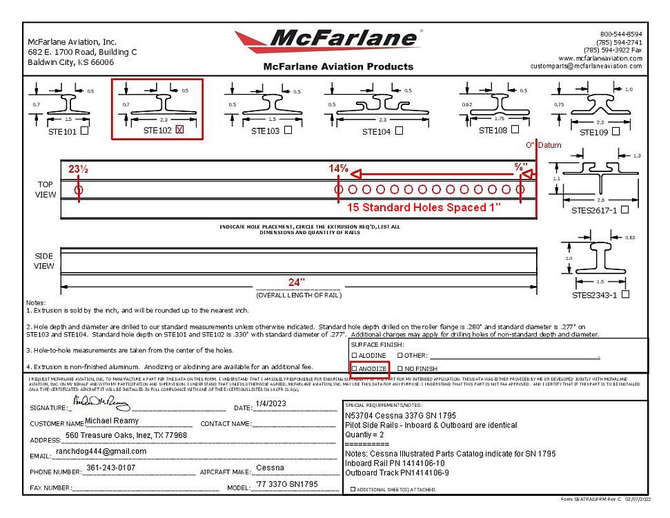

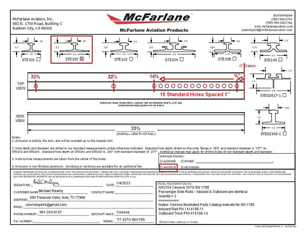

Here is what I ordered. I did the measurements first, and then a mechanic confirmed the measurements I made.
Attachment 2851
Attachment 2852
My only speculation is that the seat rails have been replaced sometime in the past, and these length pairs were used in place of individual rails. I went with what I measured as I have no basis for further measurement.
I'm glad I didn't delay the order any further, as I had a tough time getting them ordered. As it turns out, my order will be the last custom order they fill for rails. Custom cuts will no longer be filled.
I'm not sure what we do from here are where we would find the stock available. There are eight different seat rails used in the 337, all models. I don't think we will see replacements.
The four rails were $2500 without shipping.
Please note that I left out a hole in the order form drawings. The measurements and 15 hole count are correct.
