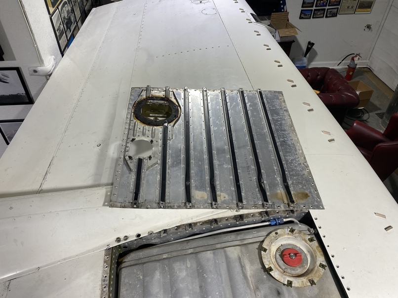

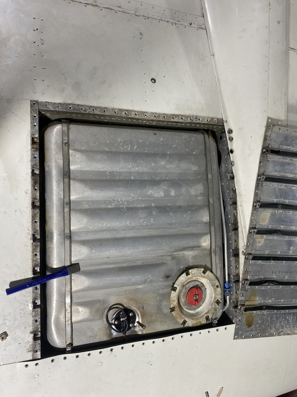

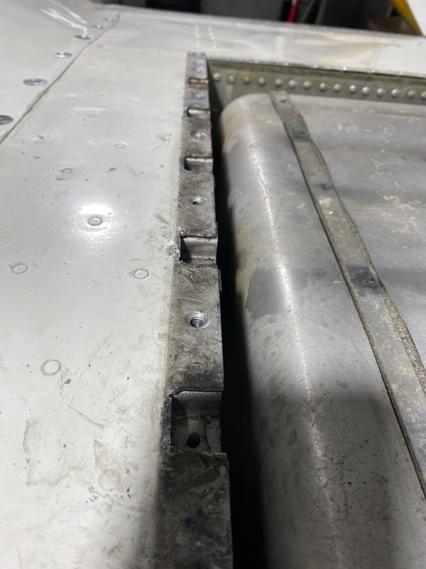

Jhogan0101 12-27-21 02:00 PM
5 Attachment(s)
Looks like aux tank needs to be removed to get to the sump tank.
Here are some photos of the cover removed and applicable pages from service manual.
Pick up a service manual they are very helpful.
