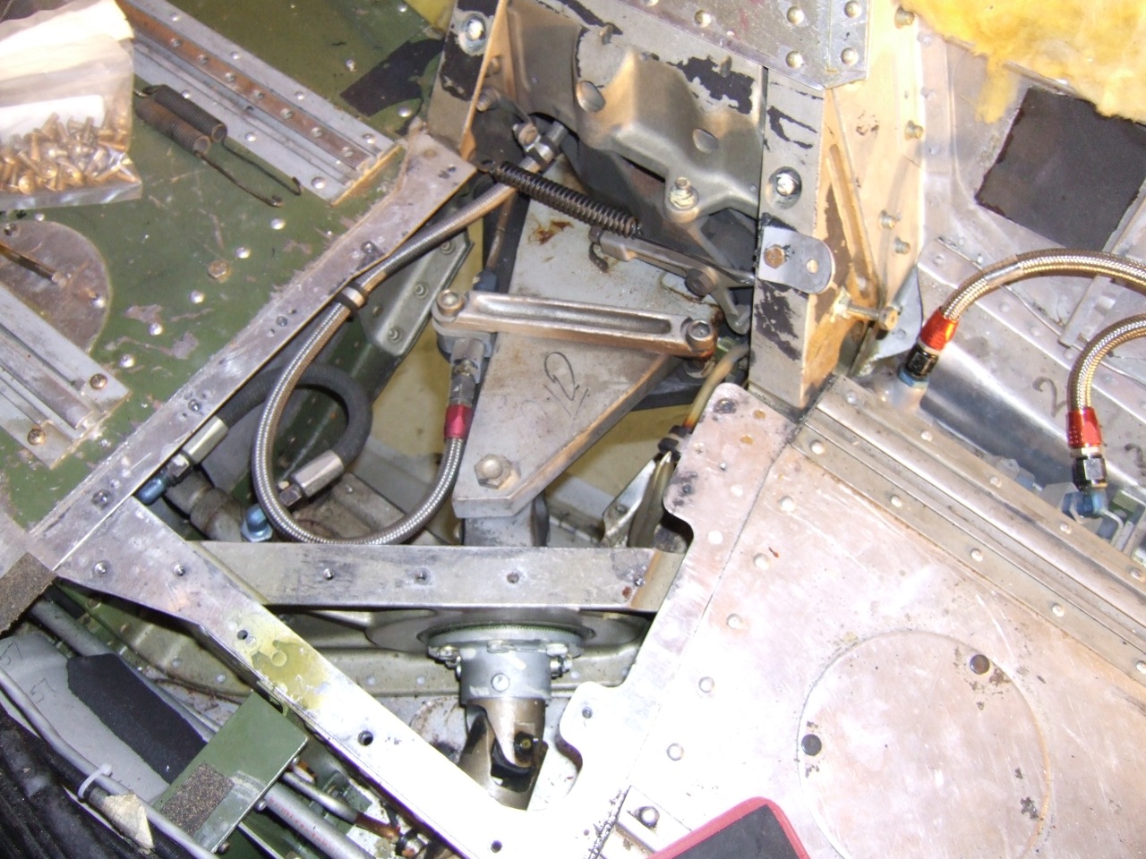

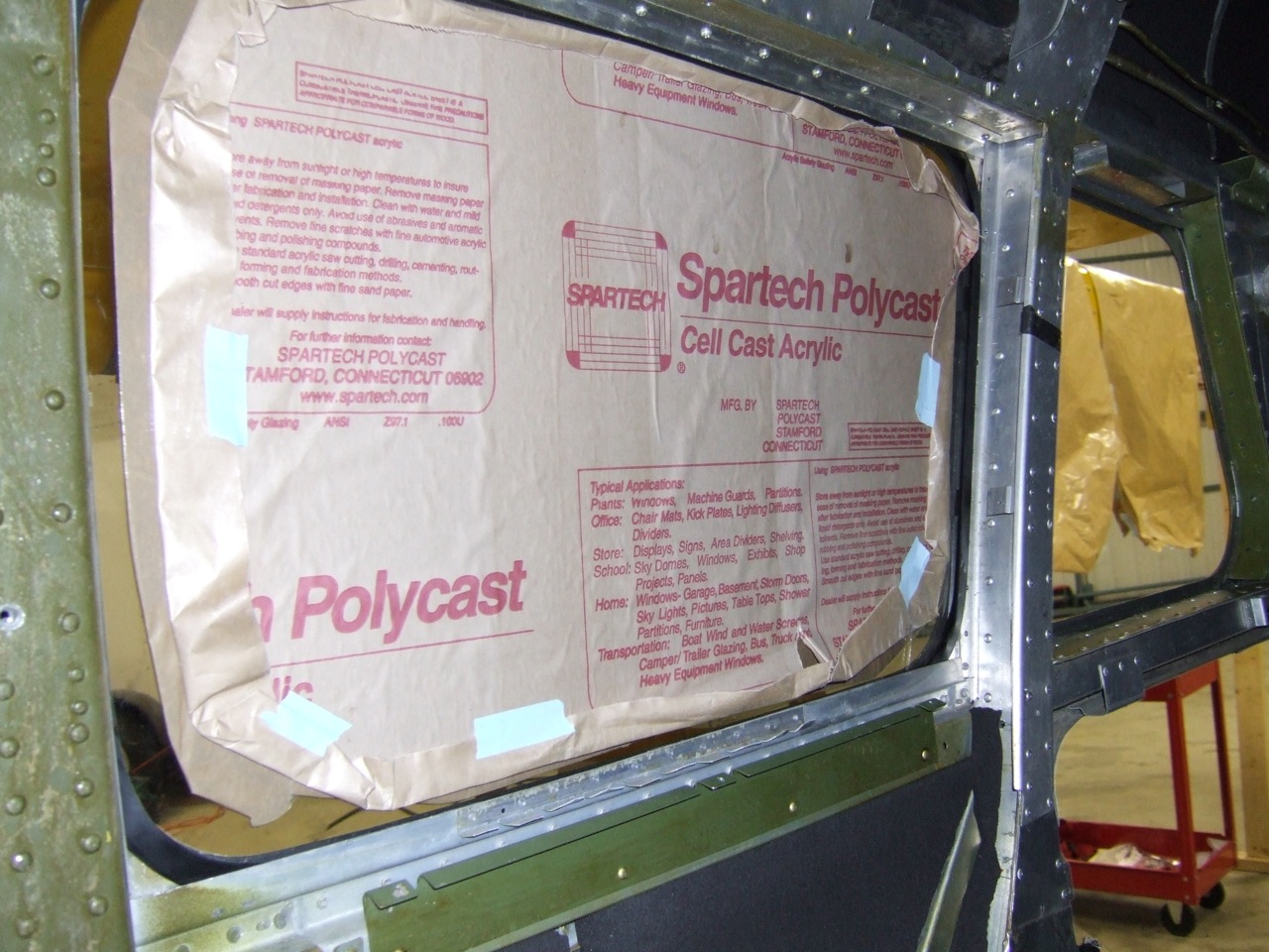

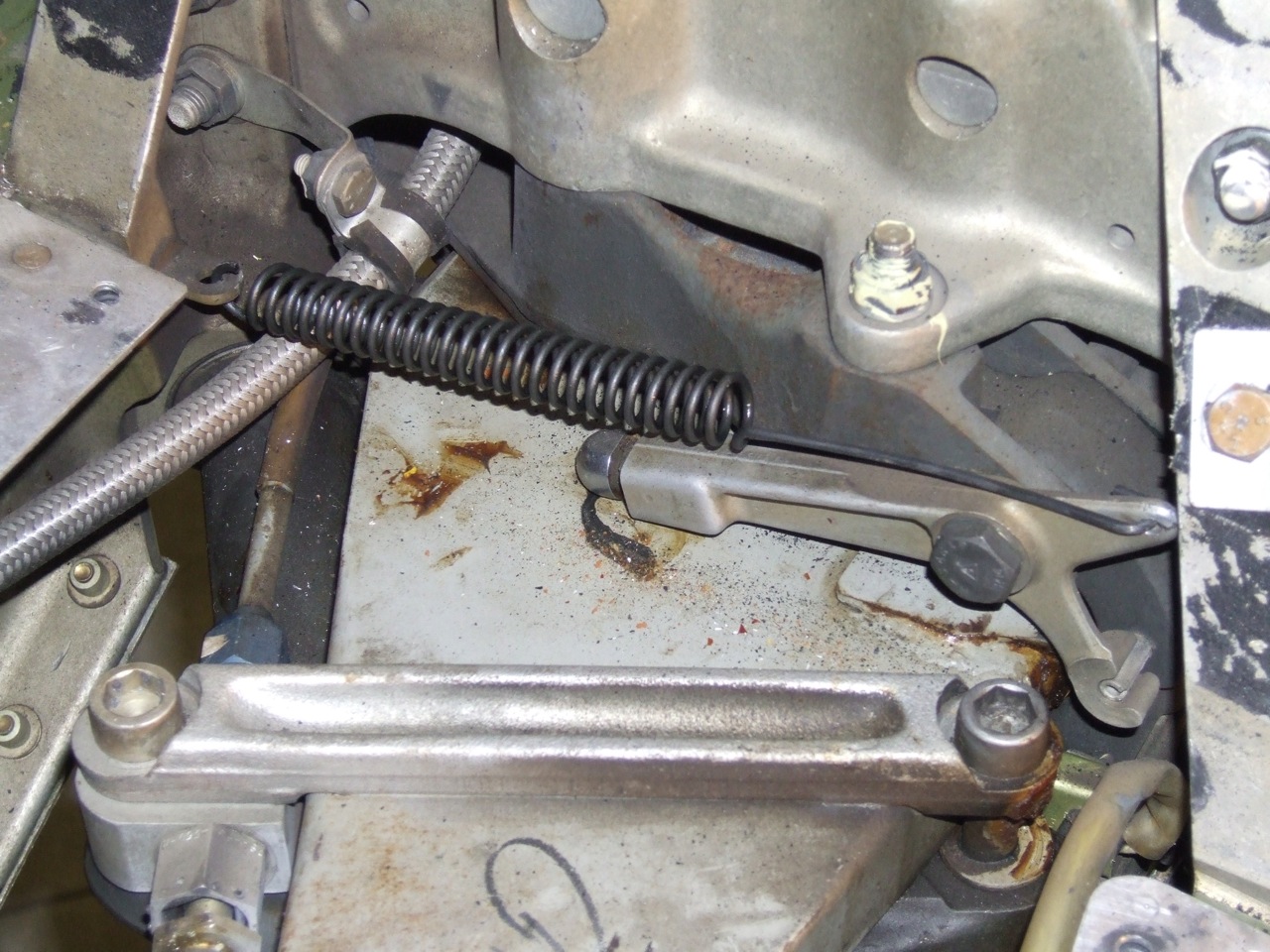

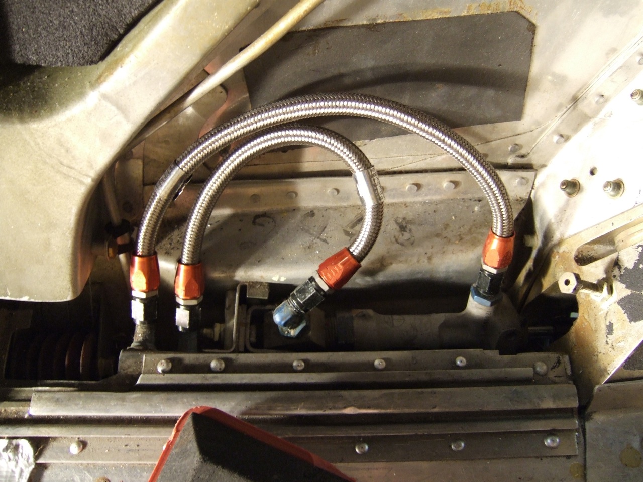

Side windows with rubber channel
Main Gear hoses

Click image for larger version
Name:	2JF side wnd inst.jpg
ID:	746   Click image for larger version
Name:	2JF side wnd rub chnl.jpg
ID:	747   Click image for larger version
Name:	2JF Main Gear hose.jpg
ID:	748   Click image for larger version
Name:	2JF main gear opn.jpg
ID:	749   Click image for larger version
Name:	2JF Gear lock spring.jpg

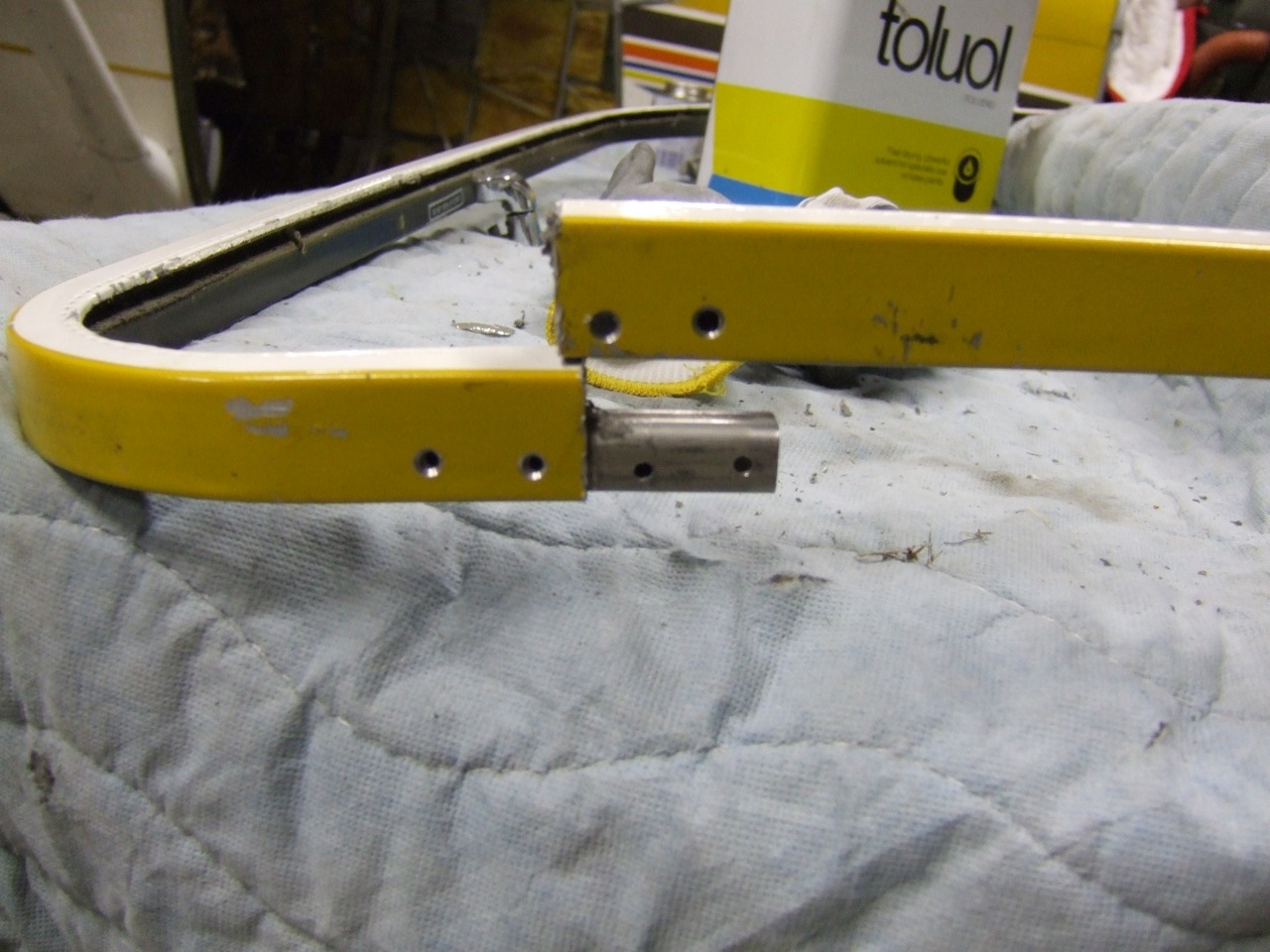

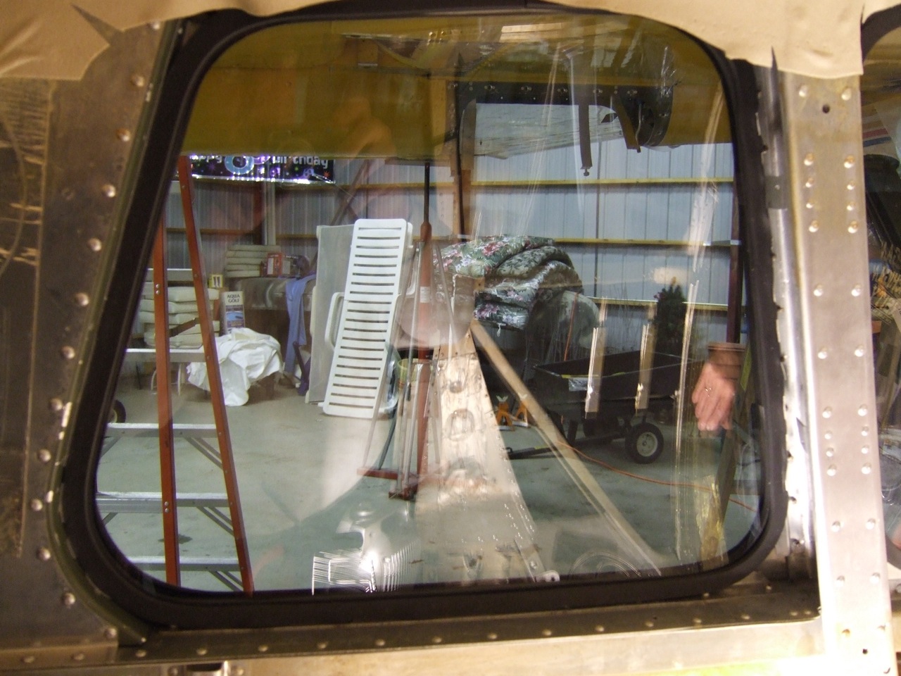

Pain in the A_ _ entry door window

Name:	2JF Door Wnd frm.jpg
ID:	751   Click image for larger version
Name:	2JF Door Wnd.jpg

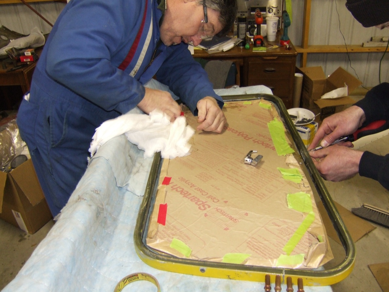

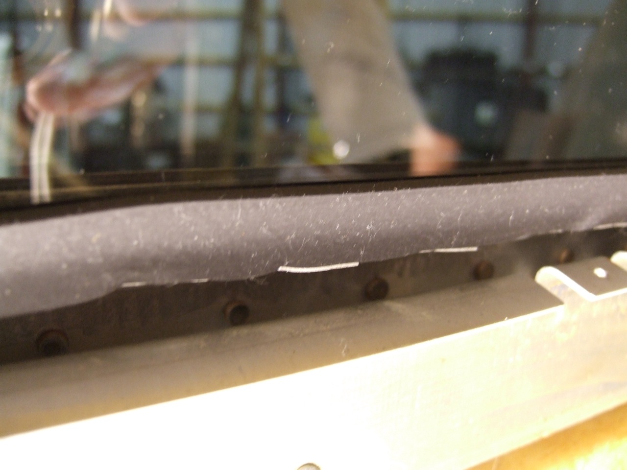

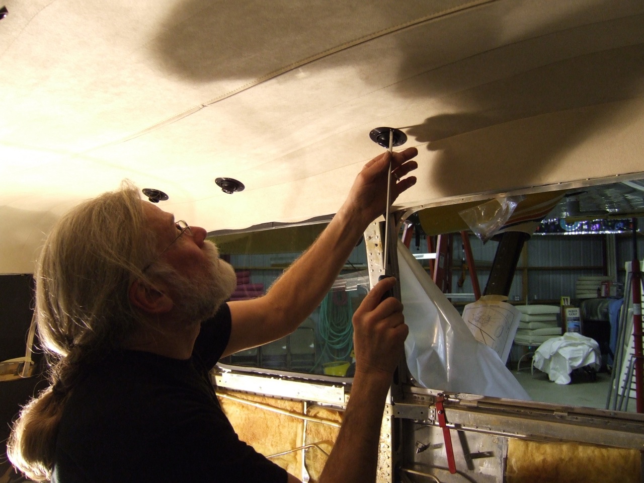

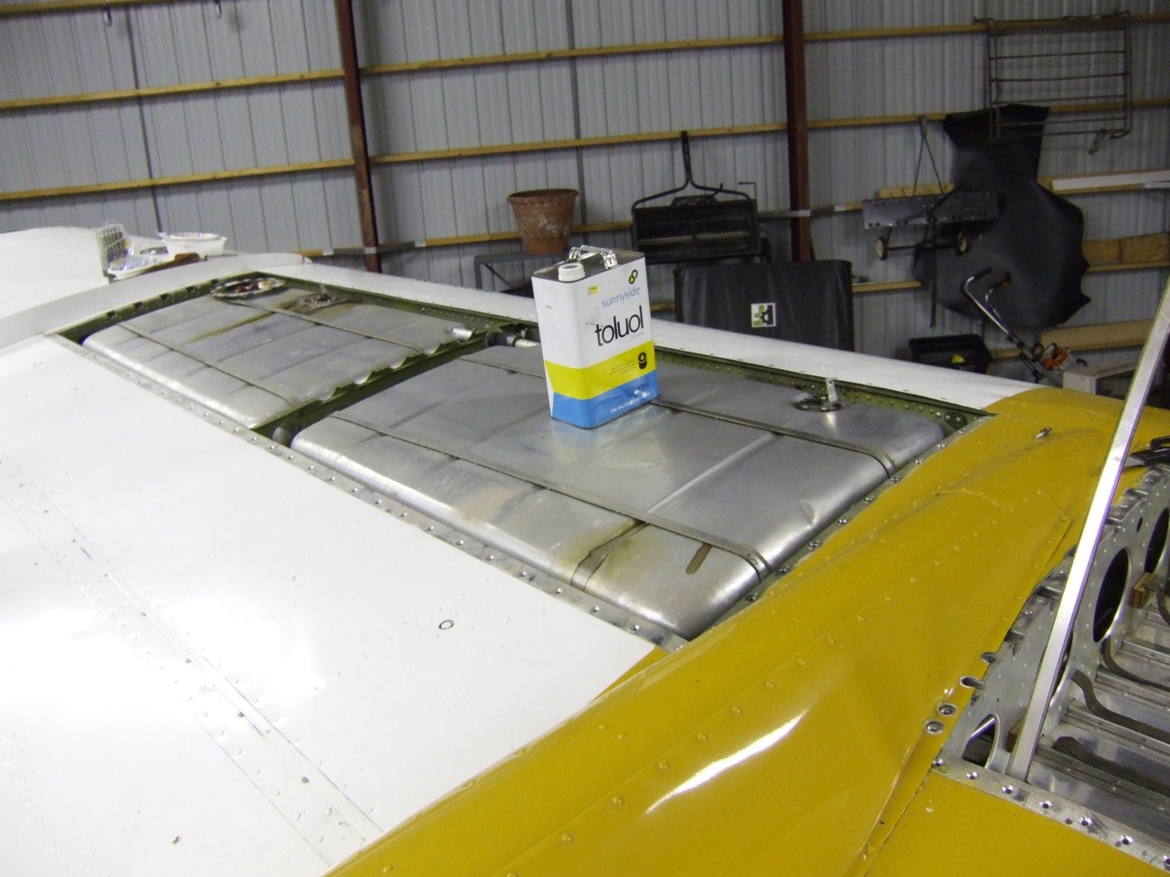

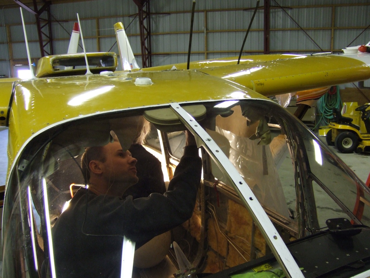

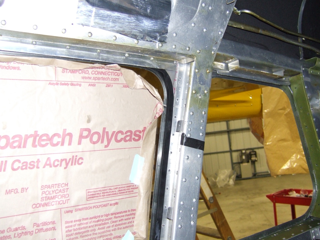

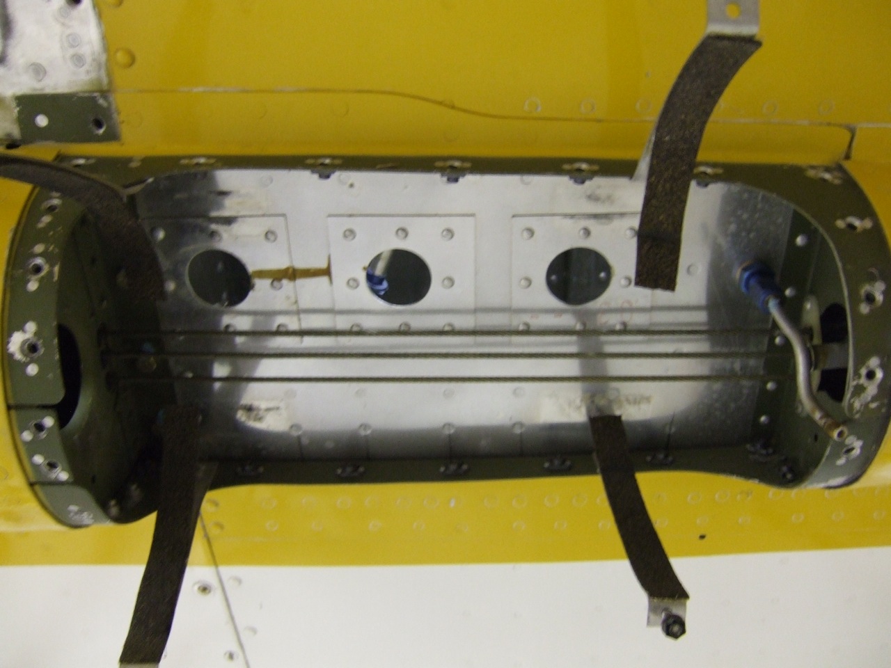

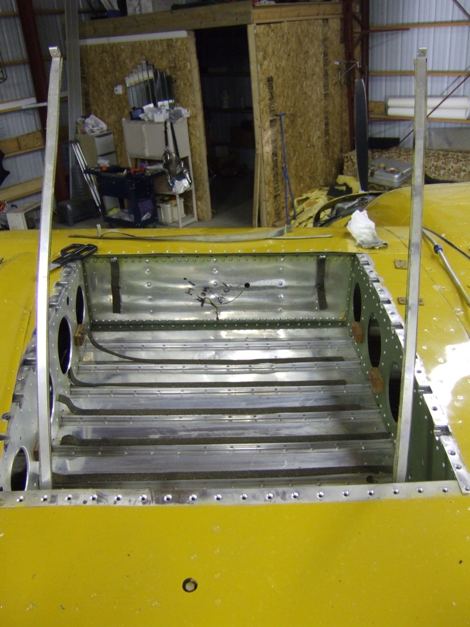

Back to work in Kalamazoo

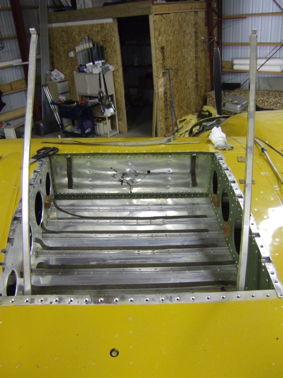

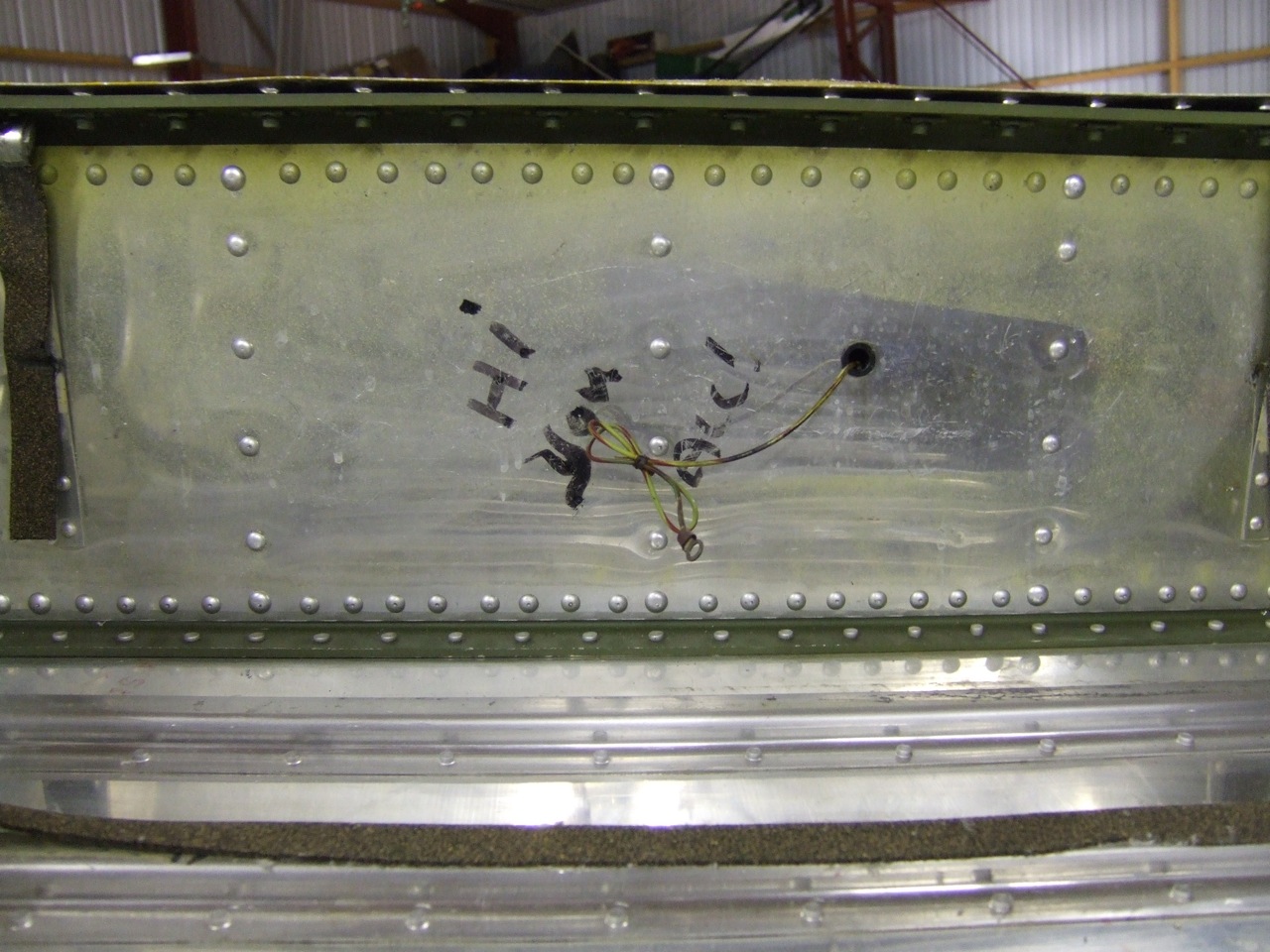

It's back to work, now that I am back. Larry took good care of 2JF while I was out West in mountain country, thanks Larry. Progress is starting to become a meaningful word. It sure seems like it has taken a while but good work takes time. Especially part-timers. But I have some good part-timers. Larry continues to provide security on the grounds. Last week he saw strange foot prints in the snow around the hanger and back yard. Ok, it's time to lock her down! Everyone has a key and the hanger is locked, thanks again Larry.
Yesterday I finished the interior windows, that was really frustrating. Trying to be satisfied with brand new windows and eliminating dust between the outer and inner was grueling. Just about the time I would think it was clean with one last wipe, boom, another streak or too much static and here comes the dust. I tried several types of cleaner, anti-stat, cloths and finally used warm water with just a titch of soap. Yes, finally something that I am satisfied with, not 100% perfect, but acceptable. I was working on installing the two middle and two rear inners. I spent a good 3 hours and then re-did the first attempt window this morning. Now I think I am ok with them. Wow, does it look nice. I am so glad I went with the grey tint. The inners are clear and the outers are grey. The windshield and pilot / co-pilot have the UV/sun control. No reason for the middle and rear because they are under the wing. It costs about 20 to 30% more for the UV control but because I don't plan to do this again for a while I thought I would do the UV control. As indicated in previous posts this feat of installing the windshield was intimidating because of all the advice that everyone offered. Even the windshield manufacturer said that those Skymasters are a bugger. Well, I decided to take the old w/s to the manufacturer, just 120 miles away in Flint, MI, and they made some adjustments to the new one based on what Cessna put in 40 years ago. I can only figure that this little gesture helped because it installed very painlessly. Side windows, not too bad. Door window, pain in the butt. Inner windows, easy but tedious because I wanted it perfect.
The right wing is all back to normal after inspecting all fuel cells and finding a leaky fitting that had to be removed and welded. Fuel is back in the main cells and panels are buttoned up tight. Now the left wing is open, we removed the left auxiliary cell to gain access for a strobe cable to the rear left tail. Thanks again to Larry and Craig for their time they spent removing the tank and sump (big pain) to just satisfy my silly desire for another strobe light. But we started down that road and just couldn't stop. Left side of the brain kinda thing. Well the cable is in and now we have a problem with the fitting on the sump tank that will need repaired. All the wing panels are off on the left side right now and all looks good. Some typical staining around the gauge senders so those will receive new gaskets. I had to straighten up the cork padding strips under the aux tank. GMAS suggested that I just use the same material, it doesn't wear out. He is right, the stuff is like new just needs to be re-attached in a couple spots. Stick it down with some Pliobond (thanks GMAS) and your good to go. We will pressure (carefully) check the tank before it goes back in even though there was no indication of a problem (thanks Jim). What is interesting was finding some notes, in the wing, where the left aux and mains are. One says "Hi you all" written with a marker. Figured it was one shift leaving messages for the next shift. The photo below of the aux tank bay shows the writing. Another interesting bit of info was that on several structural pieces in the cabin and on the wing panels it is stamped M-337. Lots of parts are marked that way, I think 2JF is part O-2. Cool!
Name:	2JF inner wdw.jpg
ID:	755   Click image for larger version
Name:	2JF inner seal.jpg

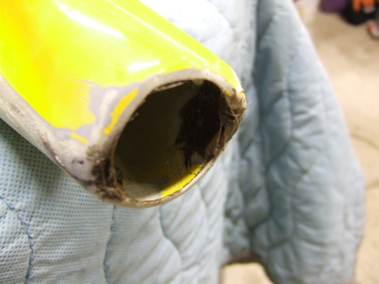

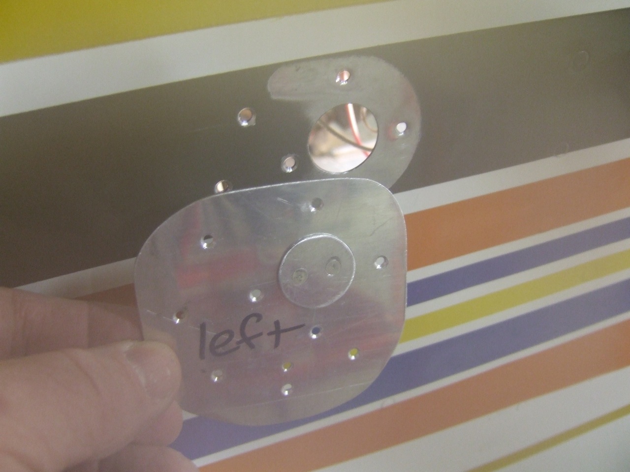

In a earlier post I had discussed the original radio vents on the outside of the cabin. I wanted to remove them because I had a powered avionics fan that had been installed several years ago to provide direct cooling to the avionics. Well the original vents were not even plumbed to the radios anymore and I thought why have these ugly little openings when the aircraft is going to paint. Now is the time to remove these if I can. I had one response concerning the removal and made me think a little more about going through with this. Then I decided to call a major avionics shop and asked them about the vents. They said remove them, they are nothing, just allowing moisture to migrate into areas you don't want moisture. With the powered avionics fan there is no need for these exterior vents. I did find one duct that was not attached to the fan that fed air to the engine / fuel gauge cluster. I figured it would be best to attach this to the powered fan. I had two fittings off the fan not being used so it is now attached. We made some real nice patches for the old vent areas that will be almost invisible with the new paint. Because the rivets that Cessna used for the original vents had to be dimpled, it required the patch holes to be countersunk just enough to fit flush to the inside skin. The original skin is .024 but we had to use .032 for the circle hole to fit flush to the outer skin. The circle was sanded just a little to allow a clean smooth finish. The paint shop will do the rest.
The tail cone for the new strobe needed TLC. This side of the tail has never had a light in it. The opposite side holds the clear nav light and I have had issues with it before too. Well a little Bondo and fiber will bring this back into shape to hold the new strobe light powered by the 2 day run the cable :-) Should look good at night.
The center strap is back on the new windshield and along with the components that live attached to the center. My interior tech did a great job on the center strap trim. It has new life with the new paint and color. Re-install the glideslope antenna and the pilot and co-pilot vent manifold.

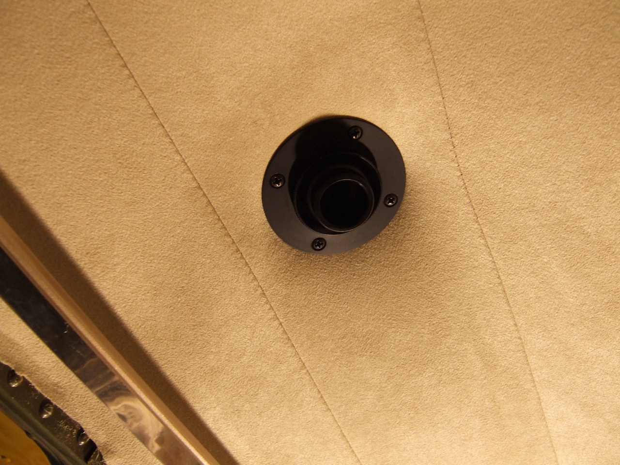

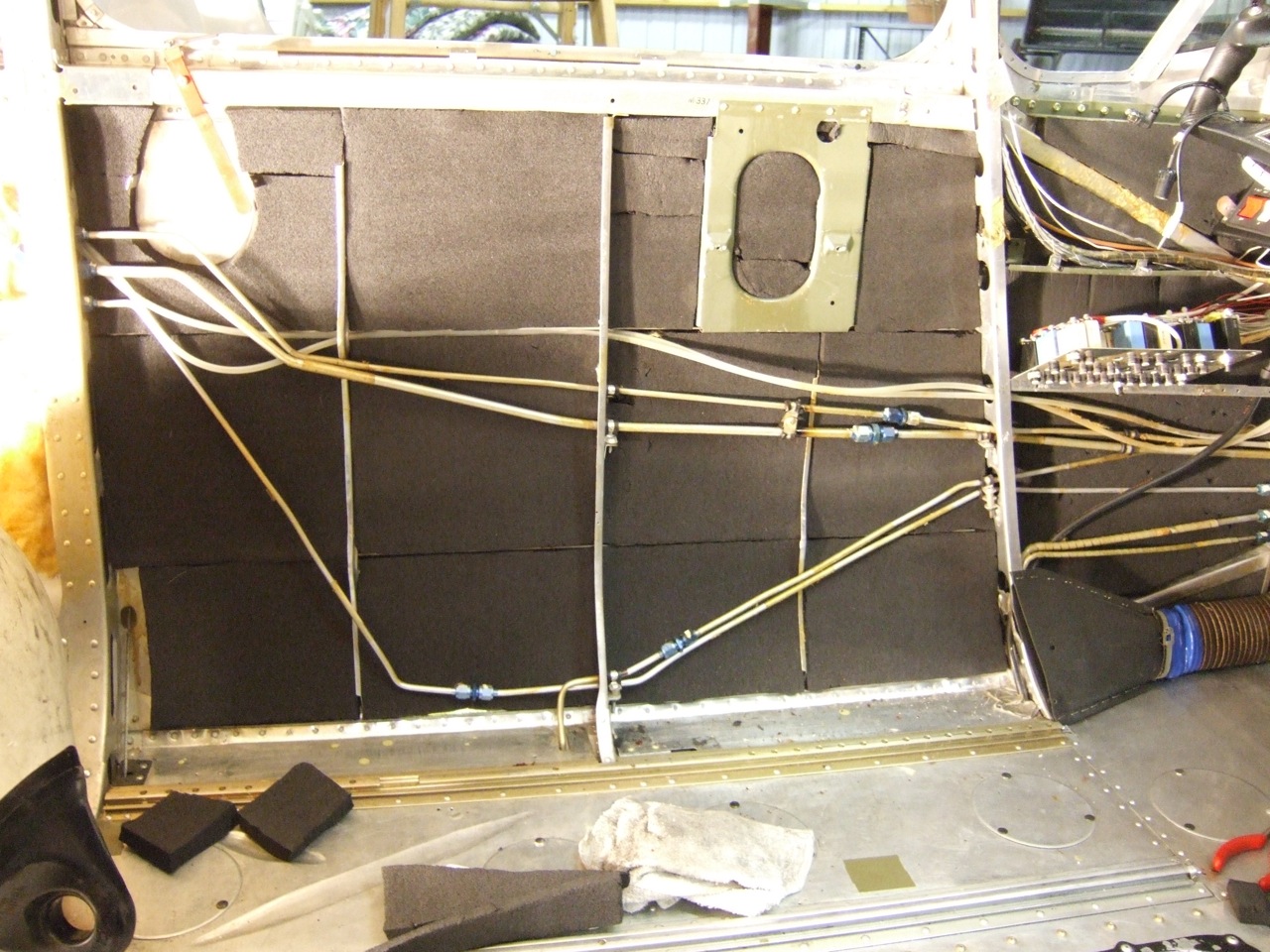

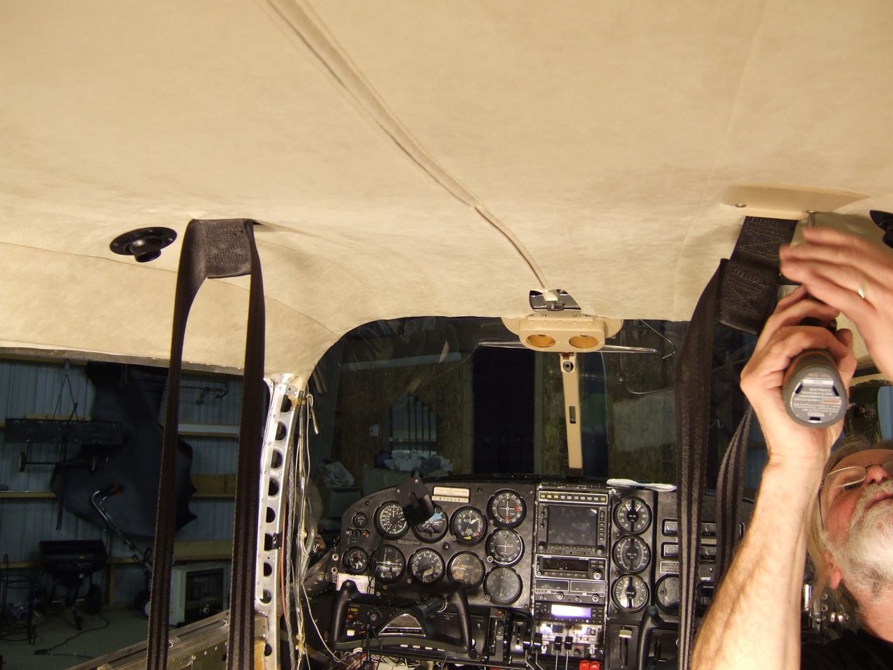

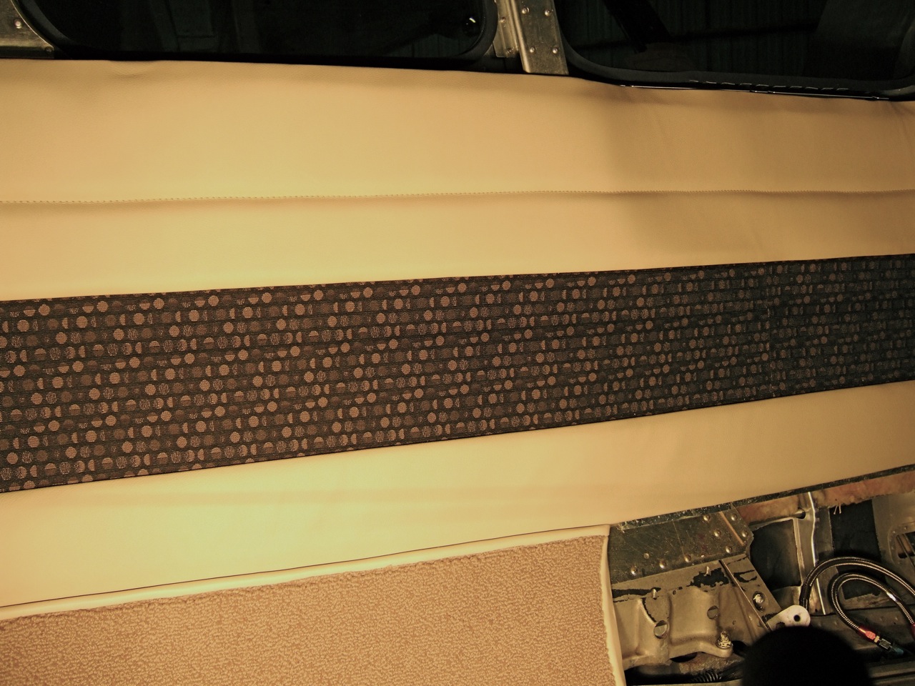

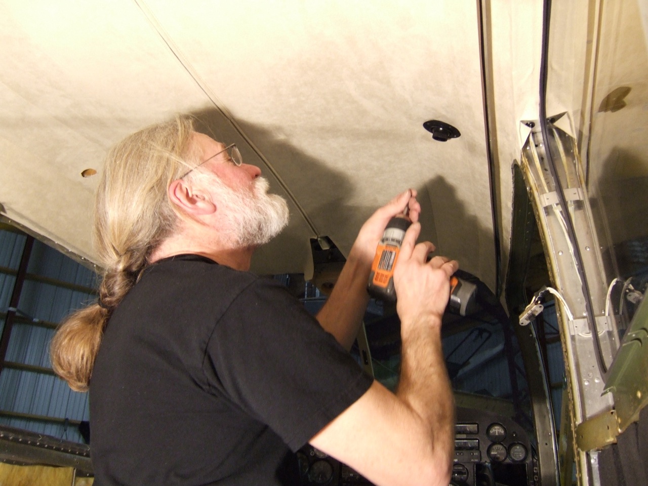

The interior is starting to take shape. It is really nice to see some progress that is really noticeable. The headliner is Ultra Suede and will be a huge improvement over the original Cessna vinyl. The new eyeball vents and lights add a touch of class and modern look to the interior. The side panels are started and this is just a first glance at what is in store for the exquisite design with the materials that were chosen. This is exciting, more to come, stay tuned.

Name:	2JF Hd linr vnt.jpg
ID:	768   Click image for larger version
ID:	769   Click image for larger version
Name:	2JF hdlner vnt lgt.jpg
ID:	770   Click image for larger version
Name:	2JF bas hdl.jpg
ID:	771   Click image for larger version
Name:	2JF sde pnl.jpg

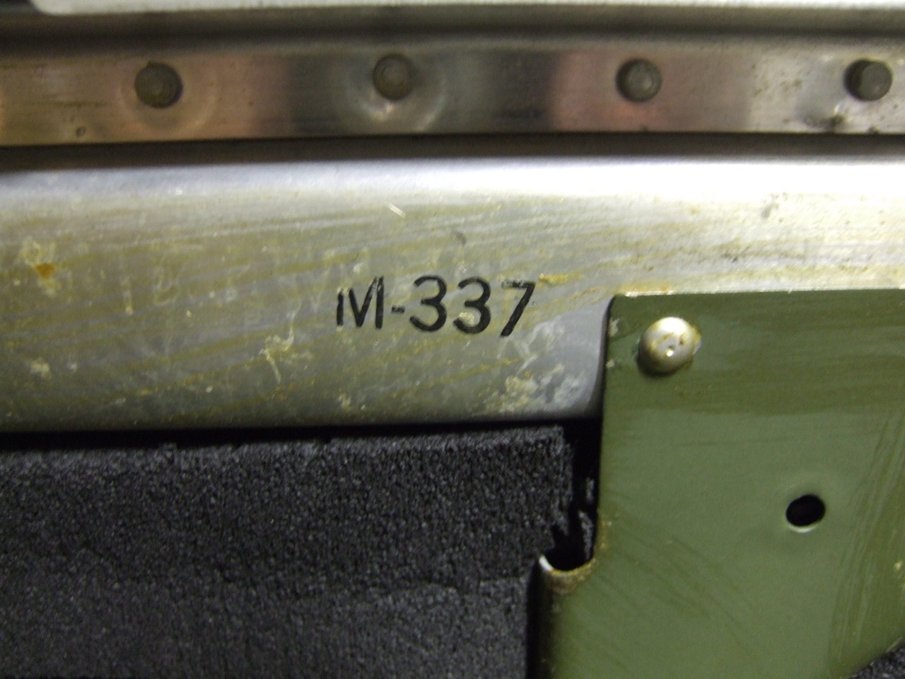

All of the sheet metal parts on the O-2 airplanes are the same part number with a "CP" suffix. The "CP" means that these parts were etched, alodined and primed. The "CP" stands for corrosion proofed according to a friend that used to work at the Cessna Wallace plant. This is also true with airplanes built with the seaplane option (180's and 185's).

That would make sense, because all the parts stamped M-337 are primed. Were all the Skymasters built in the Wallace Plant? Was that the only plant they were assembled?
As you carefully look at this aircraft it leaves a lot to be desired in the streamline, finesse arena. In some places it looks like they had some last minute thoughts on some straps and patches here and there. It's definitely a aircraft that was built for utility and not looks or speed. It's airframe strength was tested with the military use and I like the idea of how strong the whole frame is rather than built for speed and looks like Bo's or Moo's.

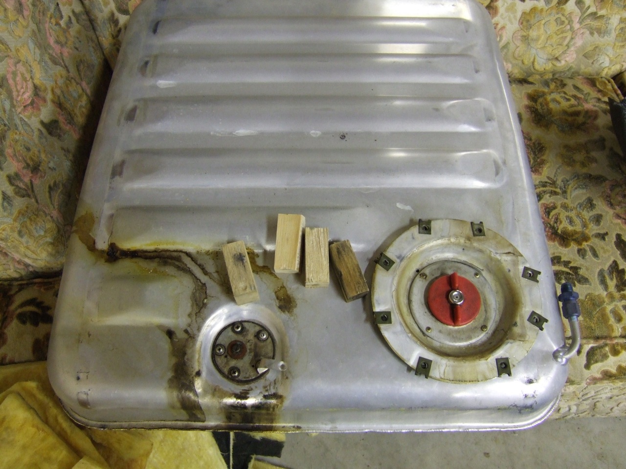

There were very few places of corrosion, most of what you see has not even been wiped off. This aircraft is really clean and in good shape. Those few areas that had some noticable corrosion were cleaned and treated as indicated in earlier posts. I will be treating the aircraft with Boeshield before the paint. http://www.chiefaircraft.com/airsec/...onControl.html Boeshield was developed by Boeing. Goes on with air in a fine mist or fog. Doesn't leave a mess like some of the other products and drys to a waxy film quickly. Come on out, Larry has an extra bedroom and we will put you to work.
Here are some more photos, left wing panel, the M337 stamp in the cabin, left boom sump tank (what a pain to remove), sound control in the cabin, left aux tank.
