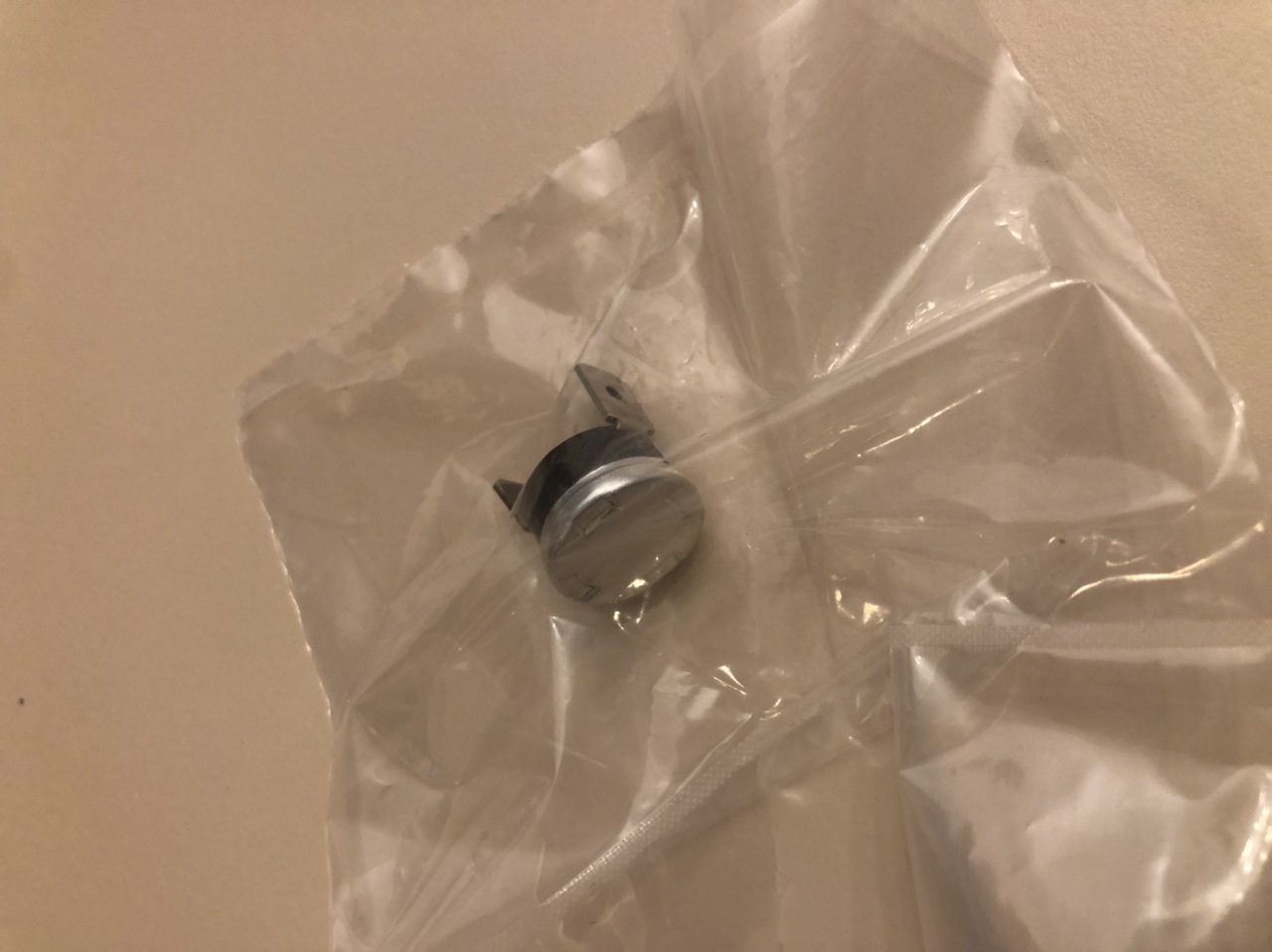

Thermostat for Pitot Heat
For those interested, I also will have new thermostat's available. 39 plus shipping.
Dan
File Type: jpeg 717FEB49-67EE-46CC-BA82-0F83CDCFF9ED.jpeg (164.7 KB, 2268 views)
