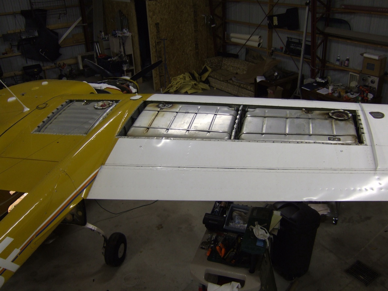

Unread 02-24-10, 08:18 AM
Here is a photo of the right wing panel skin removed. As Larry indicated my aircraft has screws on the lead edge so removal was pretty straight froward. Be sure to follow the Service Manual and support the wing and boom before removal. Re-installing is the fun part.
