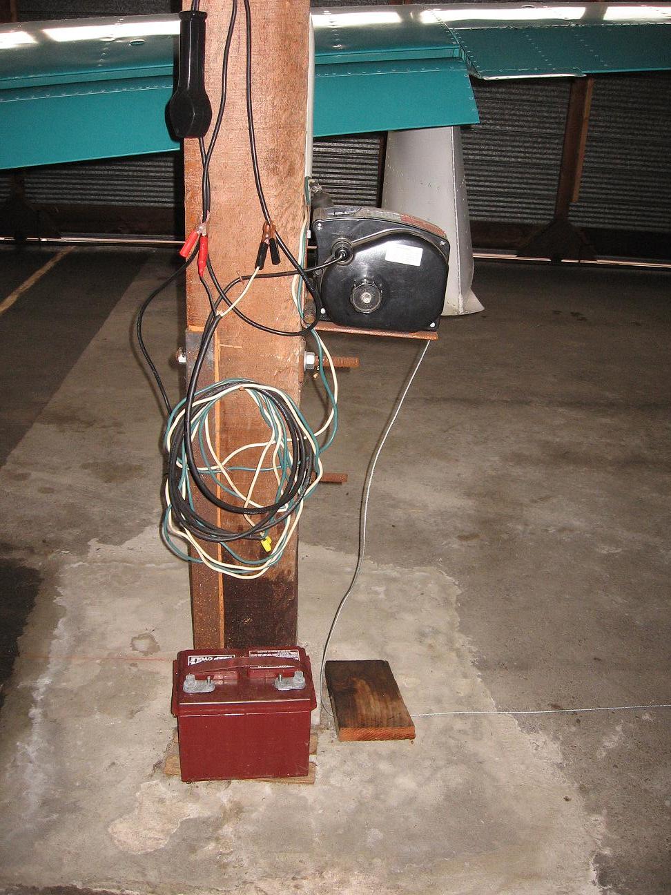

You can use a 12 volt boat winch . Down fall is that you will have to keep battery charged. It comes with a handle so you can manually winch the plane in

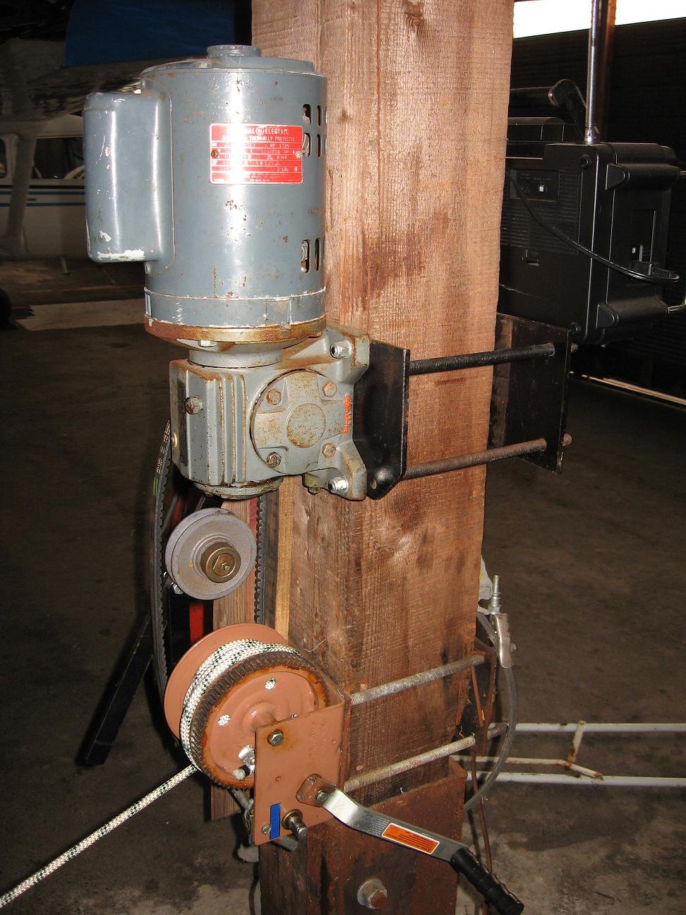

I took a 110 volt gear motor and put a pully on it. Then I took a boat winch and extended the shaft and put a pully on it and made a tension arm with pully to connected the two. I can use the gear motor or if the power goes out I can mannully winch the plane in

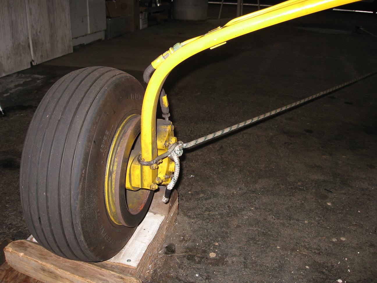

How i ran the rope from the plane to the winch
