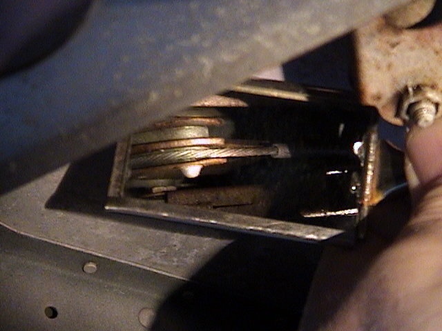

Post Flap Cable
The other day I was over at Don Nieser's hanger (one of them) and recieved some information from him that I would like to pass on to you.
First: Broken Flap Cable
I will attach a picture I took of the cable and bell crank on my aircraft (337B). It is the inboard bell crank just outside the boom. Using a mirror and light I feel you can inspect the cable very well.

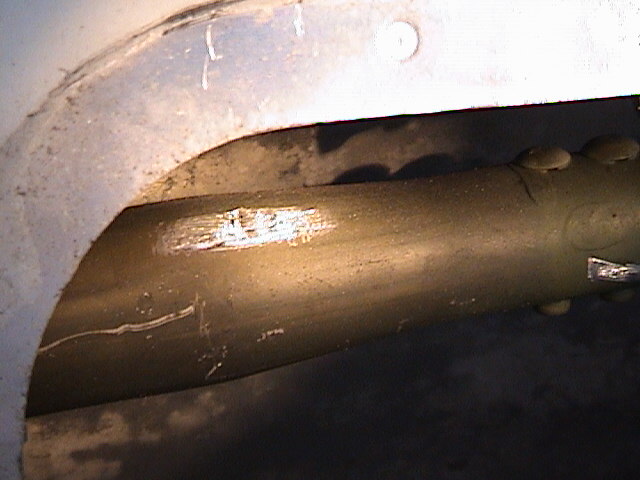

Second: Long Inspection Plate Screws
Don also showed me a possiable trouble area with long screws in the inspection plate for the push-pull flap rod. When you inspect it the flaps are extened and the rod is a long way away from the screws, but when the flaps are up the rod comes very close to the screws. I believe a 3/8" blunt end screw will be long enough to hold the plate. I will attach pictures taken of my airplane (I had the problem).

Unhappy Push-Pull Rod
Here is the first picture of the Rod, look at the shinny part where the screw was draging, it cut grooves in the rod, I will be watching it very closely.

As flap cables seem to be a hot topic I can affer the following (my CPA post)
Just had a 337 arrive at the door with a broken left hand flap operating cable. The cable snapped just at the bellcrank and resulted in one flap up and one fully down on final, nearly causing a serious accident.
At the flap bellcrank in a 337 the cable takes a very sharp bend. We pulled the opposing operating cable even though it looked ok in situ, this cable when bent revealed that the heart strands were broken and also heading for a failure.
Cables look as if they have been there for a long time, dont have the logs at the moment so cant confirm that.
Suggest that operators of higher time 337's look at this area by undoing the operating cable at the bellcrank.
Would be interested if anyone else has experienced this in a 337, cable was gal and does not show signs of corrosion. As a precaution we have replaced all of the flap cables, removed and greased the bellcrank bushes, rod ends and flap rollers.
The picture on 337 site of Freds flap cable show that it is worn and could be heading for a failure. I strongly suggest that 337 owners of higher time (5k+) undo the cable at this location and inspect it. Because of the bend in the cable the wear is in the heart strand and inside of the cable and not visible in situ. Freds pic shows that the cable is not wound as tight in one location indicating that the heart strand could have serious wear and possible break. For those not up on cables these are 7x19 superflex 1/8 cable, this means the cable is made up of 7 bundles of 19 strands. At a sharp bend like this the middle or heart strand cops most of the wear and will eventually break, this accelerates the wear on the bellcrank side as now only 6 of the 7 bundles takes the load.
I can send photos that I sent to the CPA to show the cables if you are interested.
Fred if you are out there please e mail me to discuss your cable as I believe it is defective.

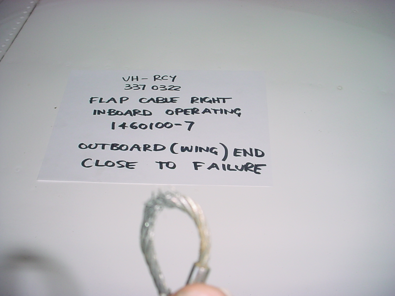

Unread 02-24-03, 04:52 PM
Flap Cable
Here is a little more info on our broken cable
p/n 1460100-7 Cable Assembly - Flap Actuator Inboard. 337 has one of these each side and it is the operating cable between the motor and inboard bellcrank. If you have stainless steel the p/n is -307. These cable is 1/8. This is the cable that fails. 2 per a/c
p/n 1460100-8 Cable Assembly - Flap Actuator Outboard. Again one each side and runs from the inboard to the outboard bellcrank. If you have stainless steel the p/n is -308. These cables are 1/8.
p/n 1460100-34 cable Assembly - Flap return. One each side runs from the outboard bellcrank back to the motor. If you have stainless steel the p/n is - 334. This is a 3/32 cable.
TTIS on this aircraft was 7504 hours. S/N 3370322
Pictures are attached of ;
Broken cable.
Location of broken cable (new cable fitted)
Opposing operating cable (close to failure this looked like Freds when it was in the aircraft)

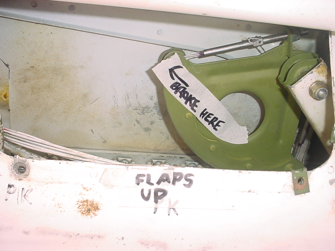

Unread 02-24-03, 05:07 PM
location of break
See pic
