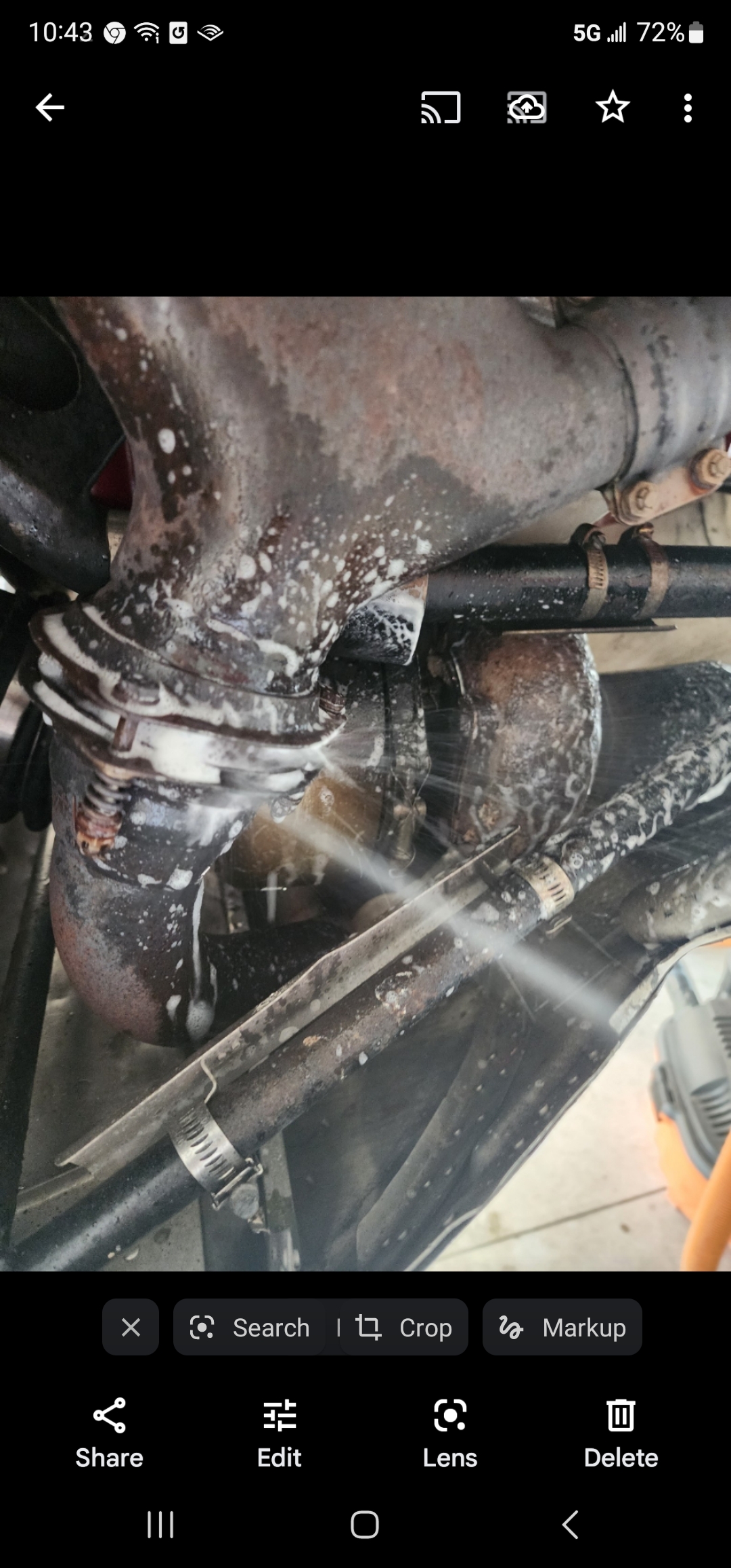

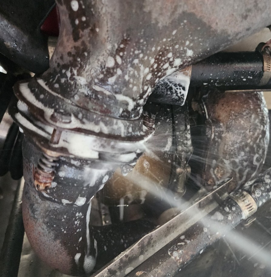

Found the leak! After pressurizing the compresor and the exhaust system I found a massive leak at the collector/ball assembly. Also just a few minor leaks on the injector o-rings. Thanks for all the input from the past and present. Joe

Would you mind posting a photo of the exact location of the leak? As close-up as possible? TY!

Here ya go
File Type: jpg Screenshot_20230712_104232_Photos~2.jpg (205.1 KB, 6006 views)
How did you pressurize the system?

Originally Posted by Joes View Post
Here ya go
Great pictures!!!

On the compressor side just remove the air filter and construct a plug made of high density foam with hole for a shop vac hose. The same for the exhaust side thru the exhaust pipe. Best to use a high pressure vacuum reversed. Joe
