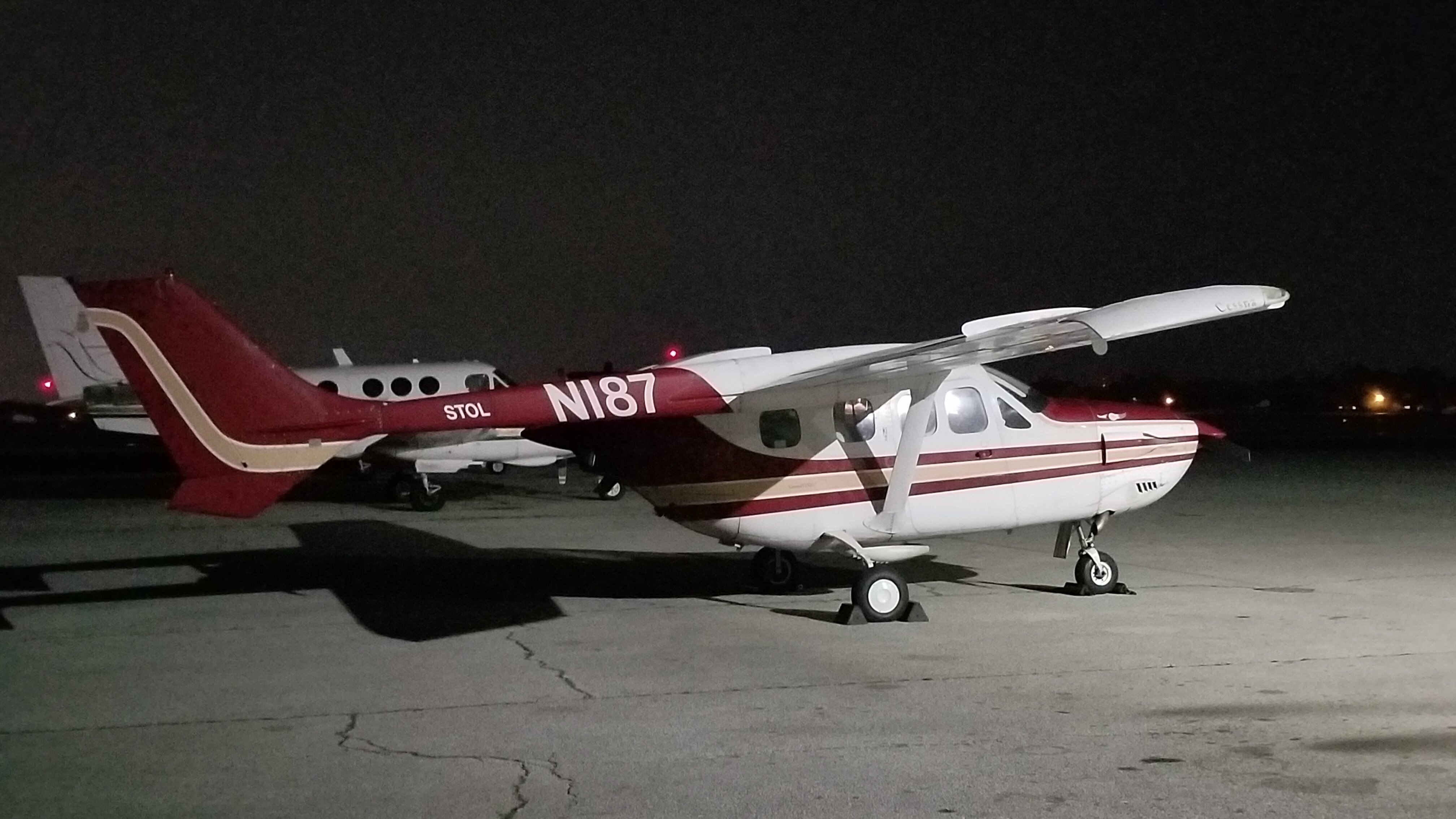

Here she is after my flight home.
Unread 04-12-22, 03:59 PM
Nice!
Looks like it has intercoolers. You're gonna want to check all that intake piping for leaks on the front engine.
I attached the flight records from last night. Your speed claims are backed up by the data. Looks like you didn't get out of there until pretty late. I guess you got to test out all the lighting!
