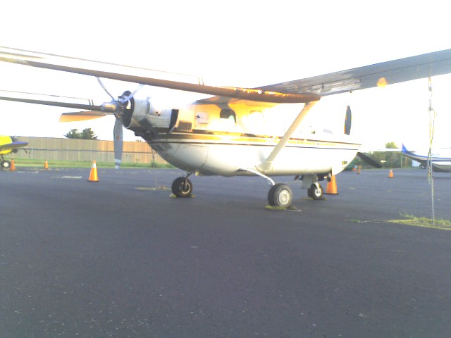

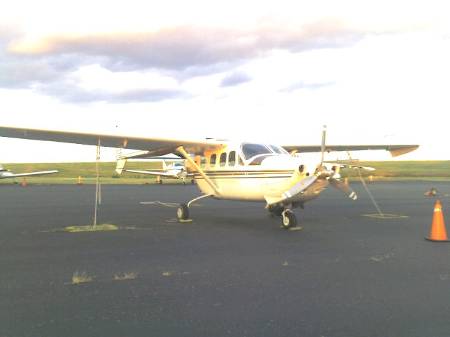

Here is a photo of my plane with a 150 gal drop tank installed.
