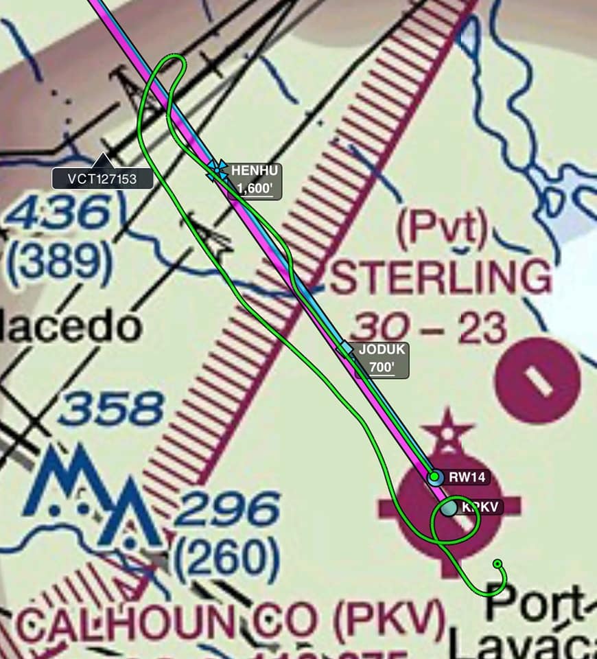

About a week and a half ago, I experienced a total loss of electrical power just as I leveled off at 2000'. There was a powerful electrical smell in the cabin; I saw a puff of smoke go through the vent window (it was open because the temp and humidity were unbearable). As I reached for the master switch, never quite touching it, the airplane experienced a total electrical failure. I turned around, ran the "Electrical Fire In Flight" checklist, and then got busy pumping the gear down. While pumping the gear down, I called my mechanic via my phone (bluetoothed to my headset) to come out and give me a visual check on the landing gear and to see if I was trailing any smoke. I had added mirrors for both situations, but it's great to hear a "you're good."
