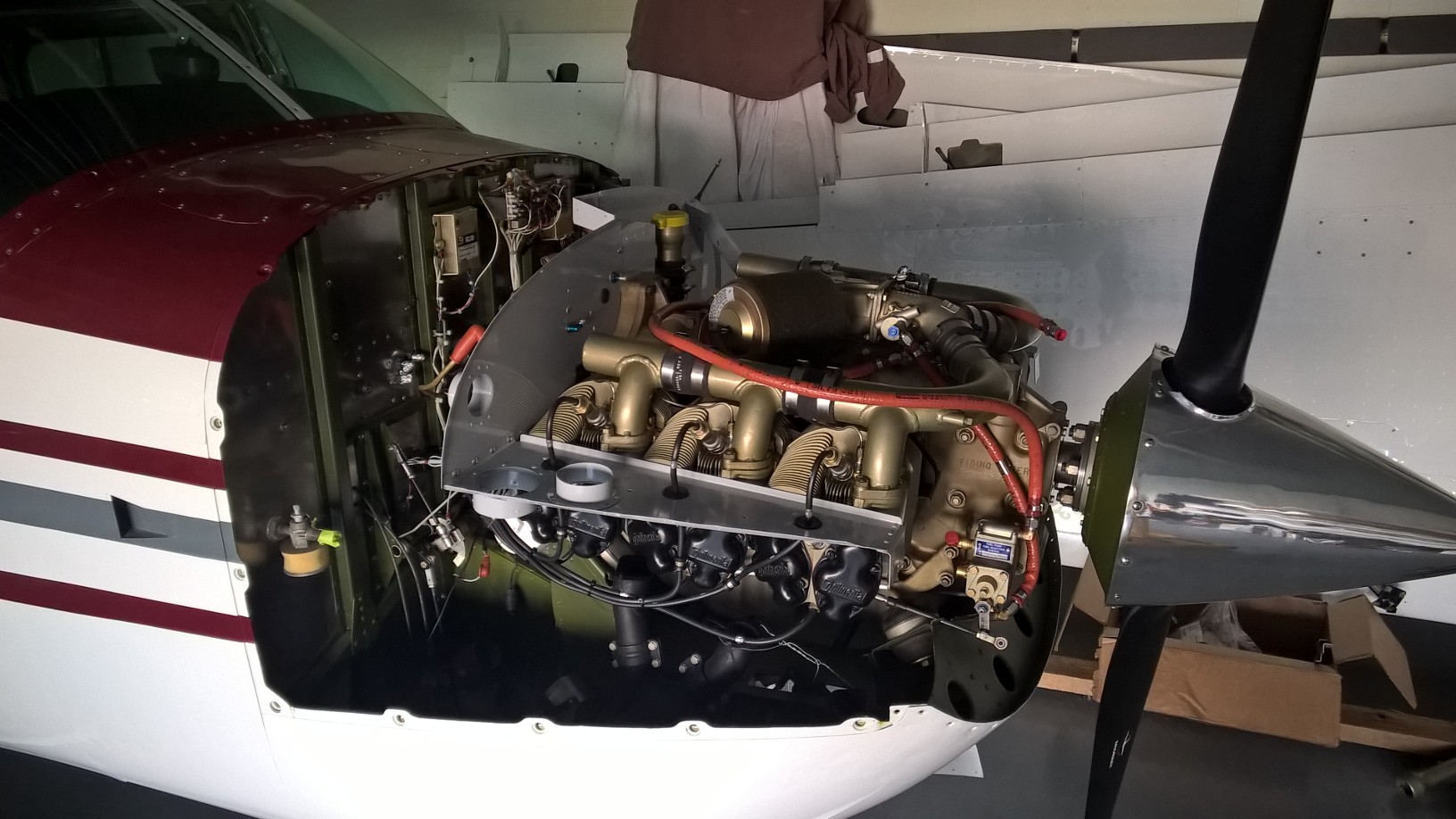

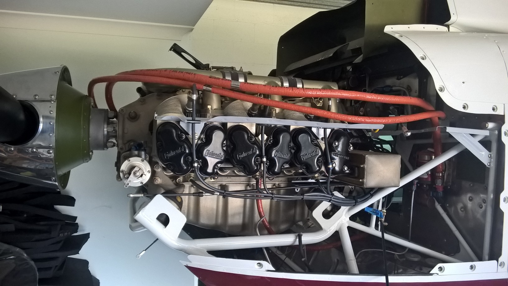

So a couple of photo's of the engines installed this week.
Aircraft details
Reg:VH-DMS
1974G SN337-1575
Airframe TT 1953hrs
FE IO- 360G 553 SFRM - Calender 12 years to go (Just been bulk stripped and freshened up, rings, bearing etc)
FP 227 S O/H - Including Gov
RE IO-360GB1B 589 SFRM - Calender 8 years to go
RP 227 s O/H - Including Gov
Everything else is new.
