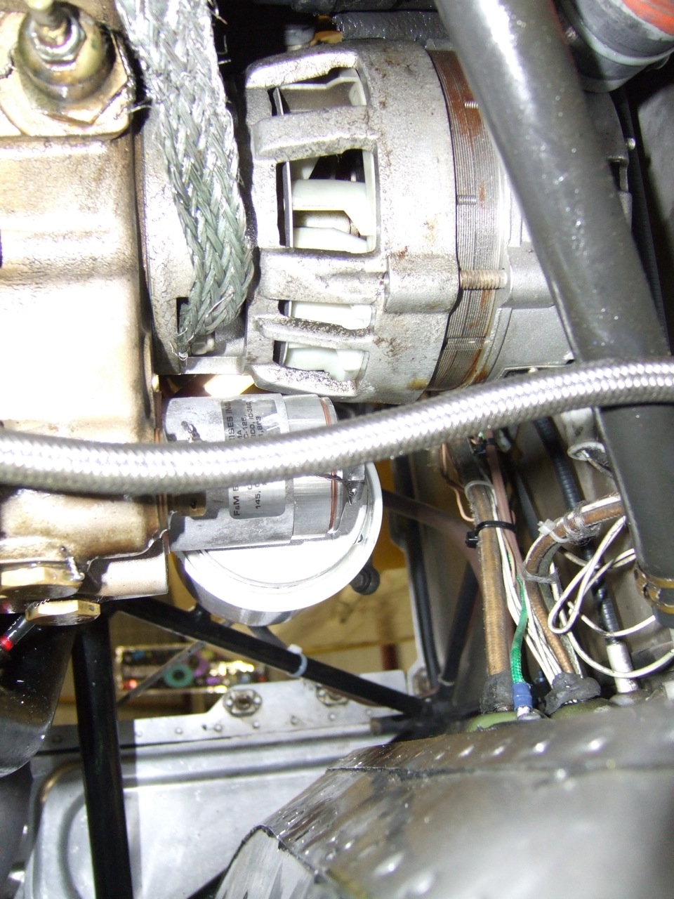

Here is the progress report for the last couple of days, rear engine mounts are replaced, rear engine oil filter is installed, all inspection plates on the left wing, booms and tail are back on. The new tail strobe is installed. I had to rebuild the mount on the tip of the bottom tail cone as over the years this has been compromised. I have the white nav light on the starboard side as original and so now added a tip strobe to the port side.

Name:	2JF rear eng mounts.jpg
ID:	778   Click image for larger version
Name:	2JF rear ol filtr.jpg
ID:	779   Click image for larger version
Name:	2JF FM ol fltr comp.jpg
ID:	780   Click image for larger version
Name:	2JF ol ftr.jpg
ID:	781   Click image for larger version
Name:	2JF rear oil fltr.jpg
