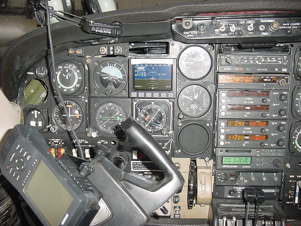

N1049D Panel
Here is the panel without the plastic cover, if anyone has a drawing for the metal panel, it can save me a lot of effort

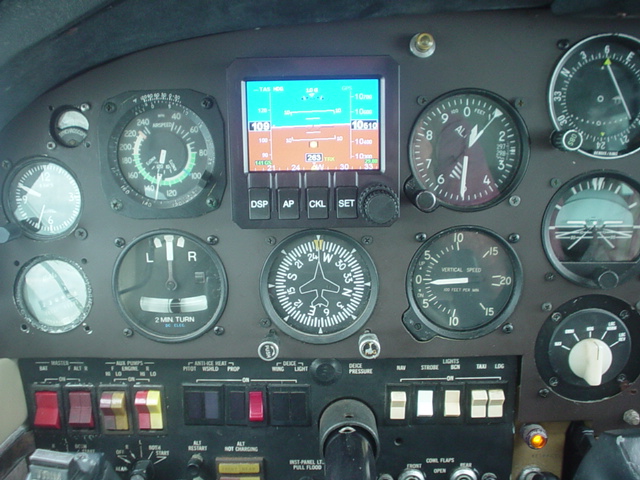

This is the Blue Mountain efis lite installed in HP-669

I am curious to see if any other members succeeded in applying for approval on the EFIS installation?
I asked my mechanic shortly after receiving the 337 forms, and he tells me he requested approval from the visiting FAA inspector, but the inspector said this is not approved. When he was shown the paperwork - he said he would look into it..... that was 3 months ago.... and I have never heard another word...
Frustrated (unused) EFIS owner....
  #41
Unread 10-14-05, 08:50 AM
wybenga wybenga is offline
Join Date: Feb 2005
Location: T31
Posts: 21
wybenga is an unknown quantity at this point
Pat this is one that you probably cannot leave to you mechanic alone. Best to call an avionics inspector at your FSDO, no the maintenance or airworthiness inspector you mechanic would probably deal with. Then send him the paperwork, then call him to see when he can make it out for an inspection. If he balks, there are currently more than a dozen installations in the US that I am aware of, including a maintenance inspector in the Anchorage Alaska FSDO.
