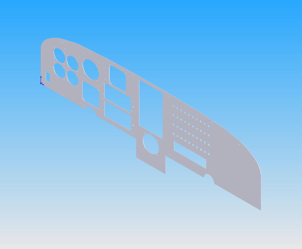

An idea of panel redesign.

Another thought, Richard, is that I remember reading that when they did the Chelton EFIS in a Citation (which was a 4 tube display, all the AHRS stuff, GPS, etc), they were able to reduce weight by 30 pounds. It seems to me the best increase in functionality and reduction in weight can be tackled at the panel, depending of course with what you are starting with. Fortunately, it is relatively near the CG.
