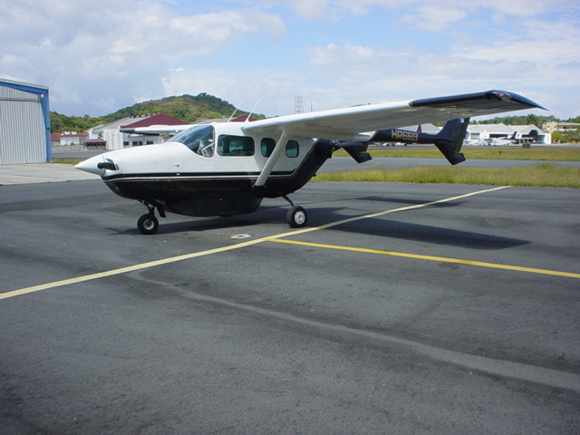

The pod mounts to the bottom of the airplane, and since you seal the floor, it should be doable. I know that Chachi has a pod on his '73, which is the same configuration as your pressurized model.

Larry, yes as you can see mine has the pod but it is a normally aspirated 75, 337G. Never heard of, or saw a P337. Chachi

Fabulous paint job!! My pod has a lighter color paint and I am constantly scrubbing exhaust remnants from it. I suspect repainting the pod would save alot of elbow grease.

Pat, with the dark color on the pot and the rear engine you do not have to worry about how clean it looks after every flight. I used a dark green
