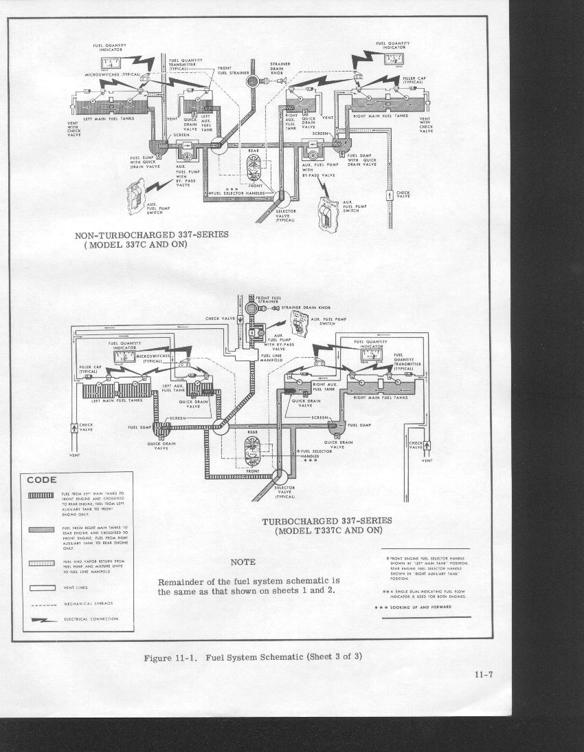

I just purchased a 1969 T337. A debate is brewing as to how the aux tanks function. The articles from the previous site said you can't get the aux fuel from a NORMALLY ASPIRATED ENGINE if you run the mains dry. I have been flying my plane the way it is stated ( after an hour switch one tank and then fifteen later switch the other, etc.).
When you look at the POH from Cessna, it does show a diagram of the fuel system which shows the pumps in a different configuration than the article diagram.
Perhaps GMAS or someone can clarify the difference.

I believe in your aircraft the AUX pump is feed by MAIN or AUX tanks because it is Turbocharged. In my plane (337B) it is only feed by the MAIN tanks because it is normally aspirated. I don't know why they did that.
Fred N358

Jcthomas
Let me try to send a schematic.
Fred N358

I wrote the fuel-management article which you can access from www.SkymasterUS.com, but it's for a normally aspirated 337. My quick analysis of the figure you posted suggests that indeed you can draw fuel from the auxiliary tanks after you run the mains dry in a Turbo model. That's because the auxiliary fuel pump is AFTER the fuel selector switch, so it pulls fuel from whichever tank you've selected. In the normally aspirated models, however, notice in your figure that the aux pump only draws from the main tank. And, as you know, you've got to have the aux pump if there are voids in the line (which, as you know from my article, will occur if you drain one tank dry).

They're right. My turbo is the same way; doesn't have the hangup they're talking about and you can get fuel simply by switching - speeding up the access with the electrical fuel pumps.
