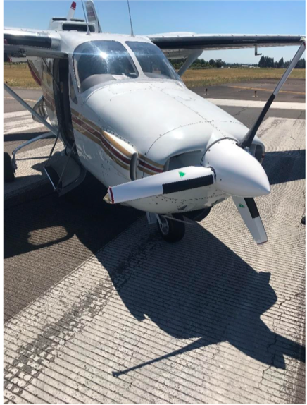

Unfortunately for me, my 1976 P337 suffered a nose gear collapse during taxi tests during its annual :( Fortunately the shop's insurance is paying for all the repairs (new propellor, prop strike engine teardown, sheet metal, etc); the unfortunate aspect is that it's going to be three months (or more) until I get my airplane back...
But I have a question about the incident: the shop wrote up a root cause analysis for their insurance company and I'm curious about it, hence my question for you all: I'm puzzled that the downlocks wouldn't hold even if there is no hydraulic pressure -- I thought the point of downlocks or over-centered construction was to stay down even if there is no hydraulics.
Here's what they said (abbreviated slightly):
Identified circuit breaker ‘LG MTR’ for the ‘Landing Gear Motor’ was ‘tripped’. With the pump motor de-energized, the hydraulic pressure in the landing gear system would not be maintained at operating pressure and would have decayed over time, resulting in the landing gear doors to begin to open and the nose landing gear actuator to unlock during taxi. Once the actuator was unlocked, the movement during taxi caused the nose landing gear to collapse.
... the circuit breaker had been manually pulled to the ‘OFF’ position during maintenance activity four (4) days before the occurrence and not reset. ...
So, in your collective experience and wisdom, is there a problem with the downlocks? I.e. should the downlocks have stayed locked even without hydraulic pressure and thus this collapse should not have happened? I care about the answer because if there's a problem with the downlocks, then the landing gear system has some problem that needs to be fixed (in addition to all the damage).
Thanks for your knowledge and advice,
- Bjorn

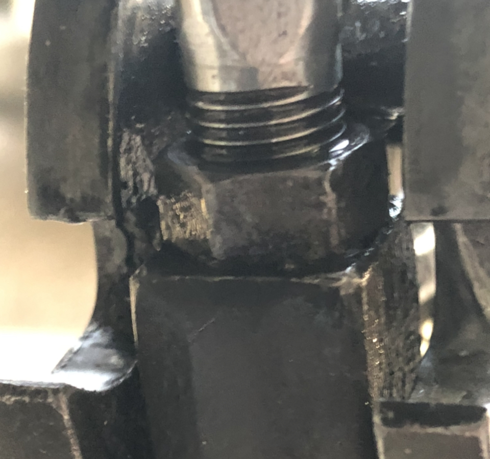

There is an internal locking mechanism inside the nose gear actuator. It can only be released by hydraulic pressure. That’s assuming it was set correctly. The small jam-nut at the end of the actuator rod is all that keeps the internal rigging set correctly. It’s a good design but also intolerant of faulty settings and lack of understanding of its operating principles.
I always check that internal lock when it’s on jacks. Manually push the nose gear down (into locked position) and listen to “click” of it locking. Then check the external down lock hooks ensuring the pins are fully seated.

Jam nut pic.

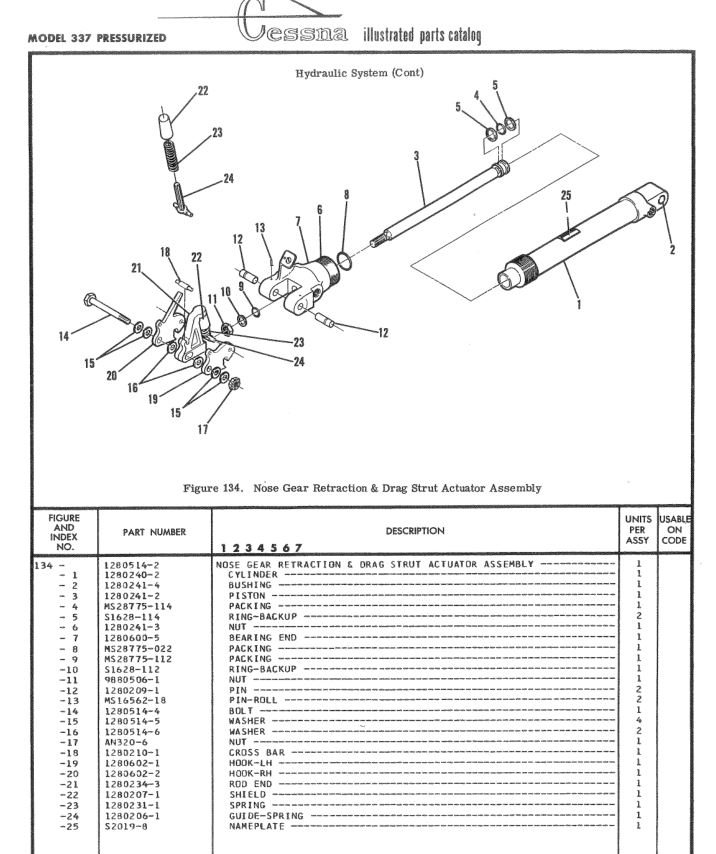

I don't understand how the locking mechanism works. I've attached what I think is the correct diagram. Perhaps you would explain further?
FURTHERMORE drooping gear doors are a symptom of the gear accumulator needing service! It has nothing to do with the actuators (usually).

I purposely used the phrase "interesting geometry spring lock mechanism" as to try and manually operate it, it is not completely straightforward. But it is stout. The locking part is easy enough. The cylinder pulls the top of the trunnion forward. Spring loaded hooks on the end of the rod that ride with the trunnion engage horizontal pins on a "fork" which is part of the end of the actuating cylinder. Since the other end of the cylinder is anchored, this rigidly locks the trunnion in place. "Interesting geometry" comes from I could only get it to unlock by either "the jam nut end" pushing on the mechanism from within or by taking the spring lock mechanism apart, unhinging it from the side with bolt removed, spring flying off and everything. Someone knew what they were doing when they designed it.
Forgive me for using doors (pleural). I did have a drooping door (singular) which was weak cylinder. However, there is only one actuating cylinder operating both of the front wheel well doors. So one bad cylinder there could cause both of those doors to droop. As always, investigate thoroughly and properly. These are just personal experiences and not a repair manual. (But I try to be as correct as possible.)

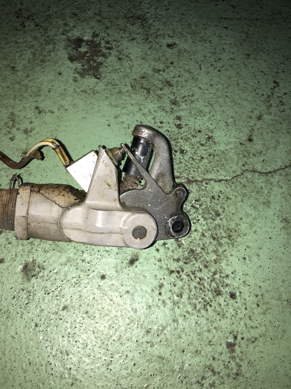

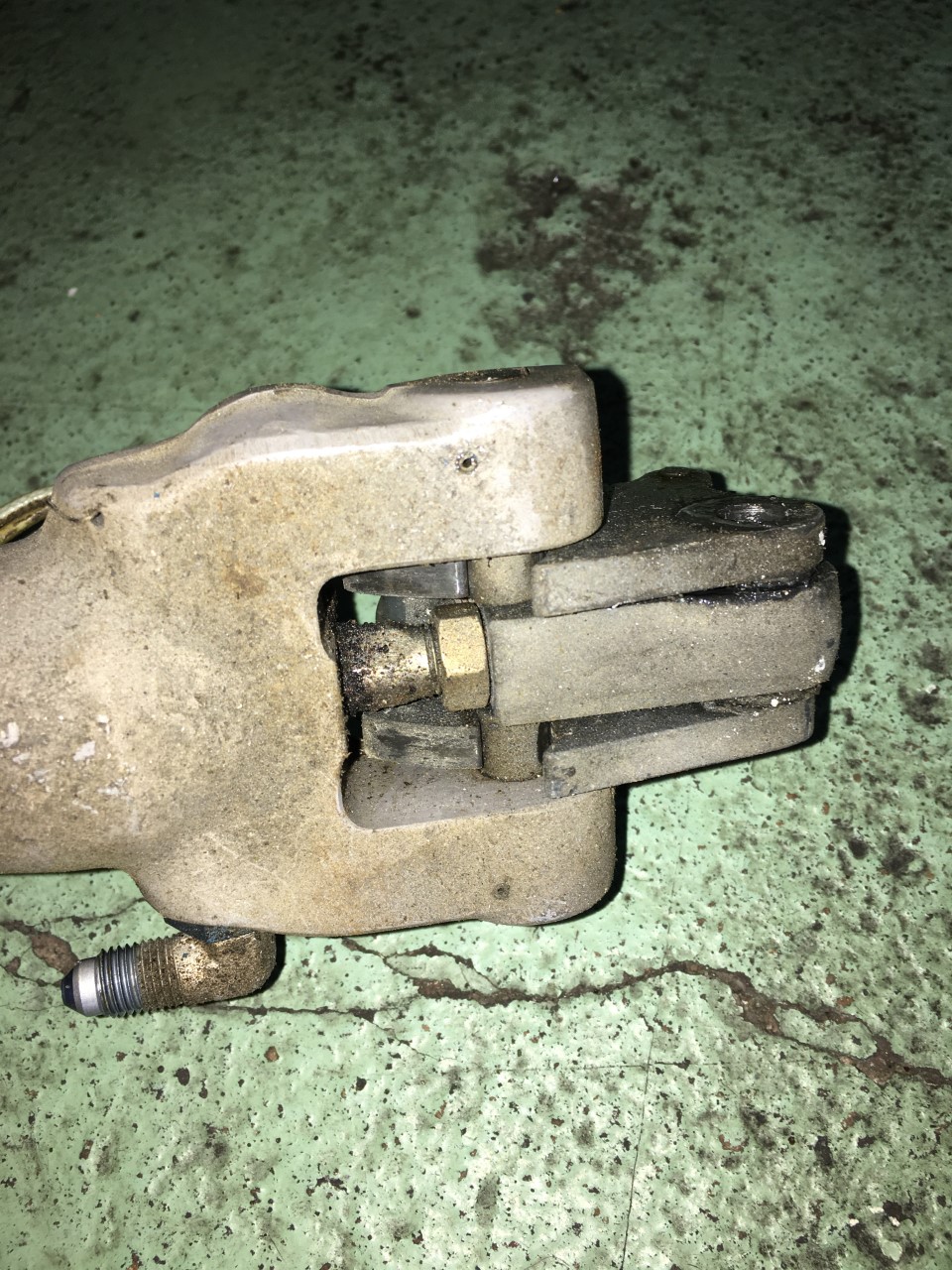

I have tried to upload some pictures. Hopefully it works.
you will see the hook mechanism engaged with the end of actuating cylinder. The bolt hole is for a bolt that goes through the mechanism into and attaching to the trunnion. The rod (with the lock nut) is what moves with the hydraulic pressure. You can see the plastic spring guide.
Even off the airplane with the bolt out it is still locked on. That's what I consider interesting geometry.
