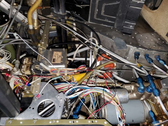

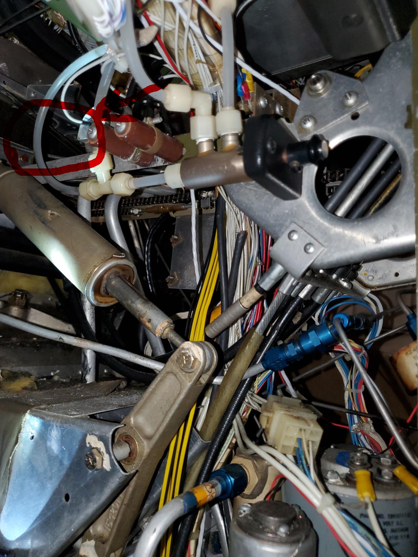

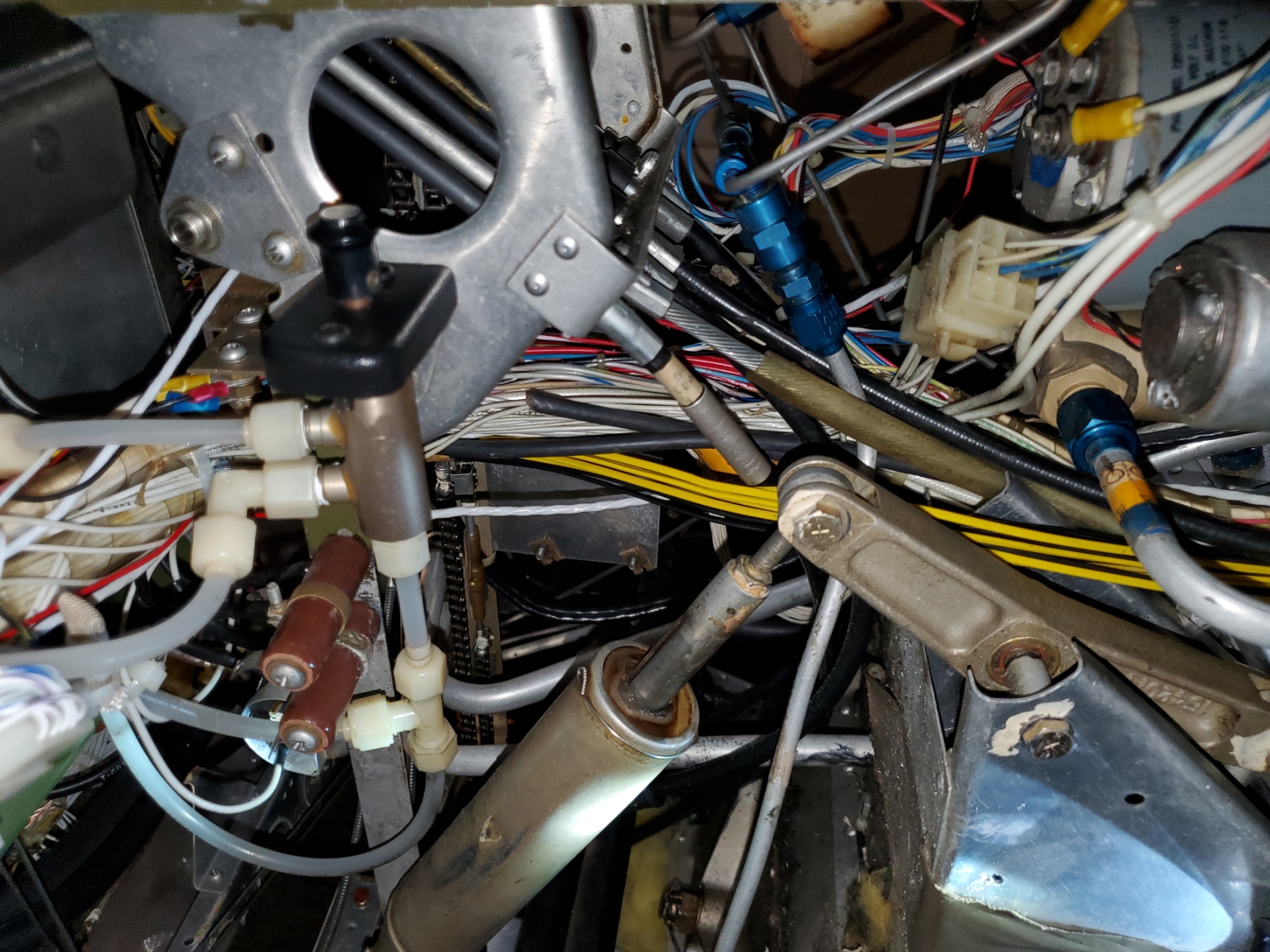

I've been looking for awhile... I don't think the bird has a battery pack (it's supposed to have something) installed anymore. NA 77 G model. I'll post some photos--maybe you eagle-eyed folks can assist a sweaty seeker?

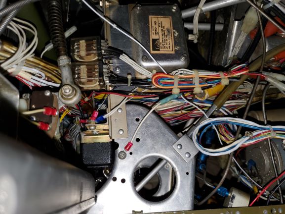

Mine were on the pilot side. More towards the firewall so the picture was not too helpful. Except it may be the black box in the picture on the pilots side too left of the frame, hard to tell from this picture. On mine it was a black cap over the batteries secured with a wire tie.

Battery Pack
Mine is located right here, circled in the picture. Just forward of the shielded resistor on the same support the resistor is on.
