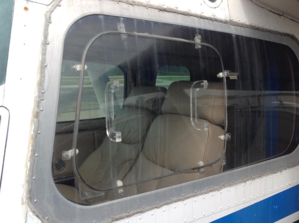

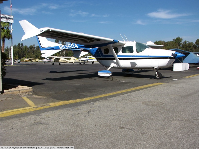

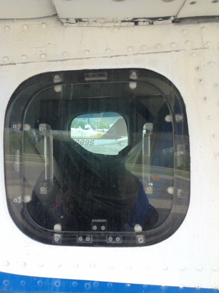

A friend of mine sent me those 2 pictures that he found on internet. Maybe this plane belongs to one of you?
My C337G is finally ready to fly, and I would love to have this Mod on my "G".
Do you know where I could find this STC?

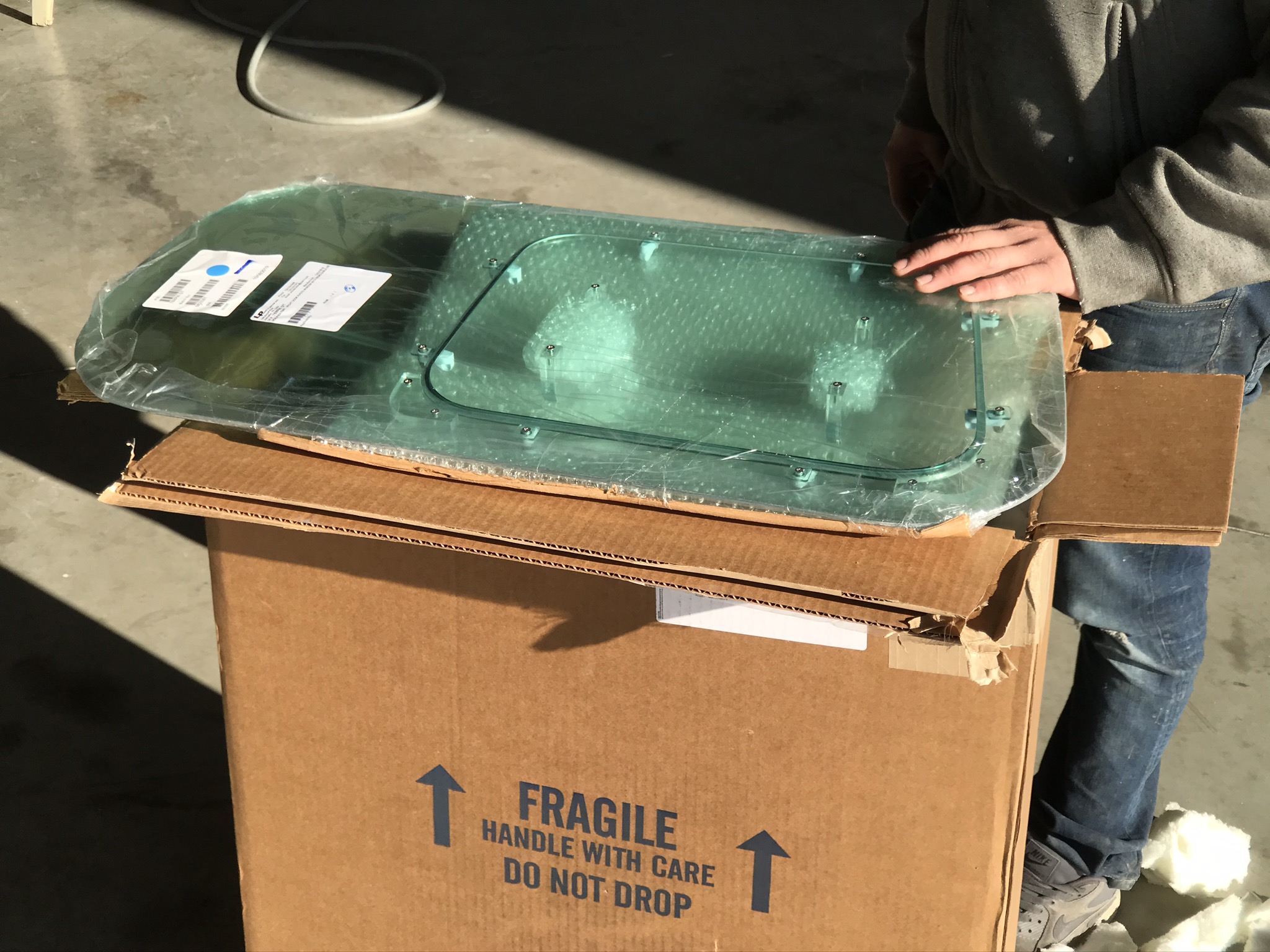

Photo windows
Those are the pictures of my skymaster photo windows. My plane was used as a photo ship and has several mods for it as well as has a restricted aw as well as standard aw.
You also can see on the bottom clamshell door is another camera mount however I don't know any information as to what cameras mounted on it
Hi !
You got a heavily modified 337G.
Mine is almost "stock" (N-5JT), only the Horton STOL kit.
I bought this 337G in France to go on holidays with my wife & Kids, but i also would like to use it as a fast photoship for military jets.
Where & How can I get this MOD? Do I need an STC?

LP aero plastics manufacturers the windows from my understanding
Edward Coffman designed them he is a member on here he may have more insight on then

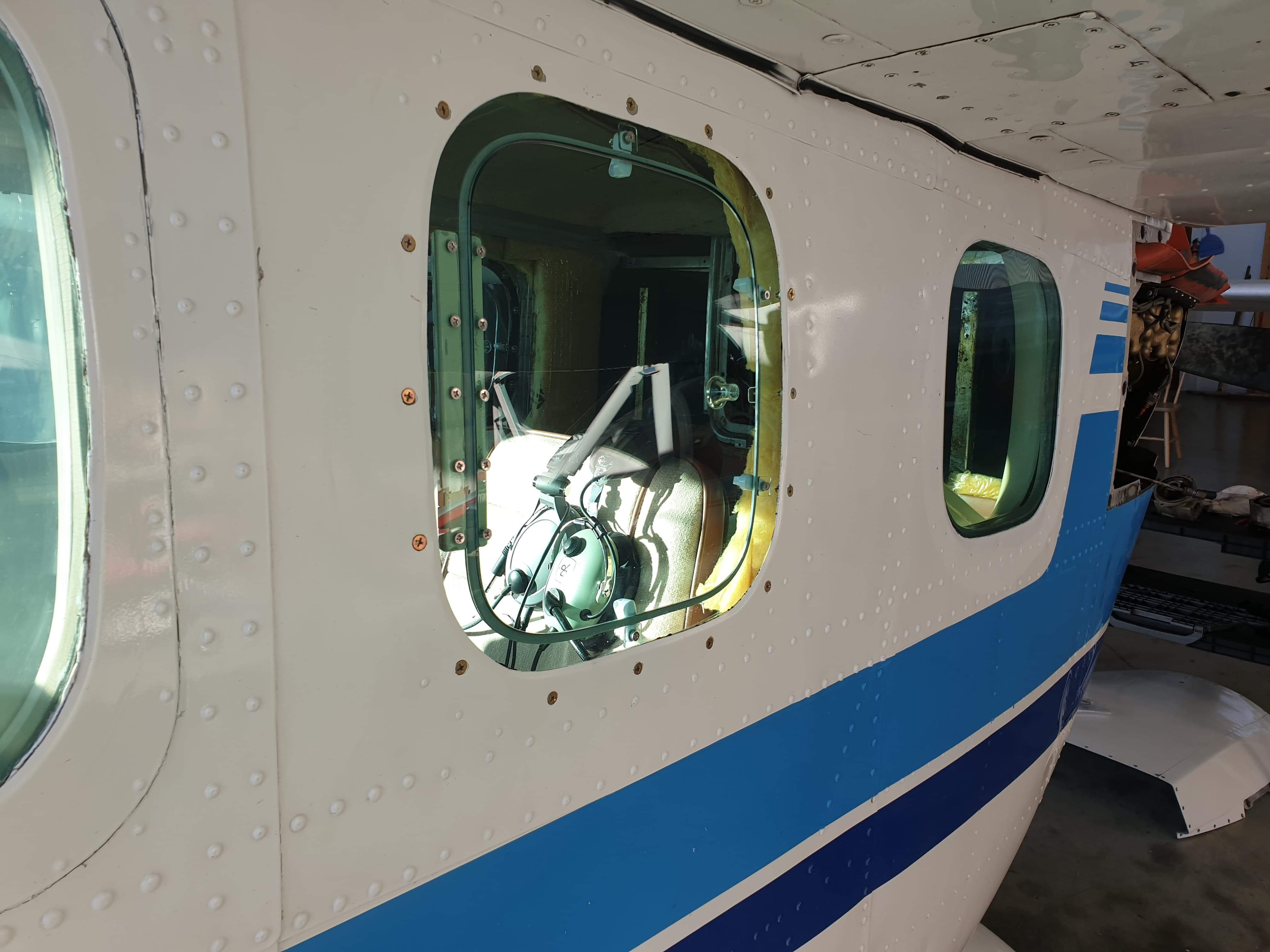

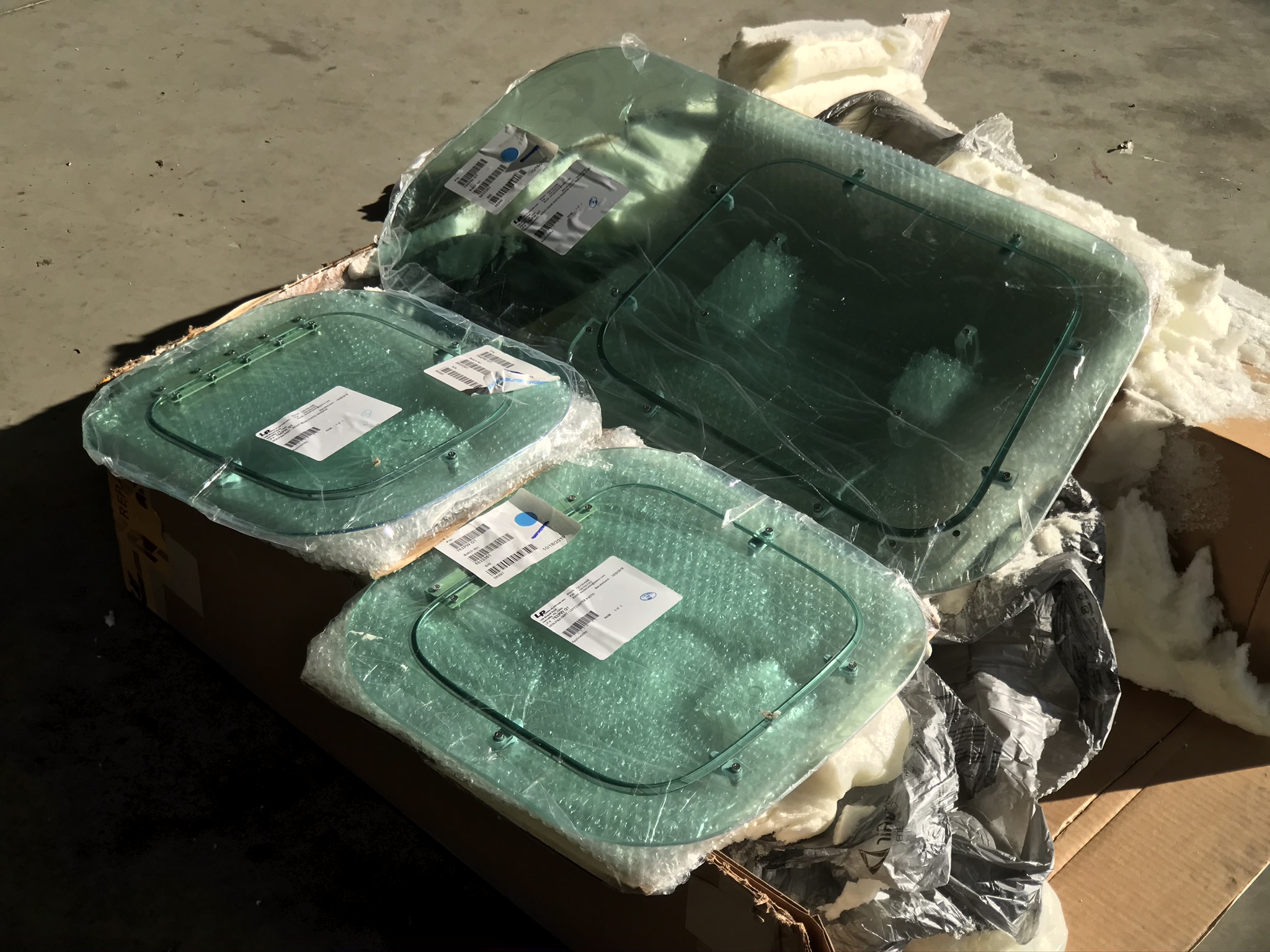

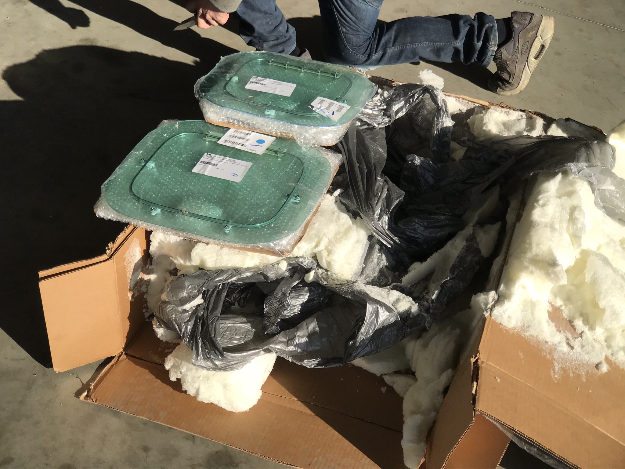

Happy new year 2020 !
My C337G is ready for the 2020 airshow season , as a photoship.
My photo windows from "LP Aero" are perfect.
