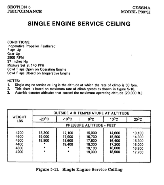

I would add that if you fly above mountains or above clouds with ice or above weather you would not want to be in then it helps to know your single engine service ceiling for 'what if', especially if you are near max gross.

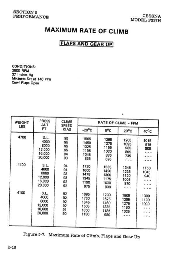

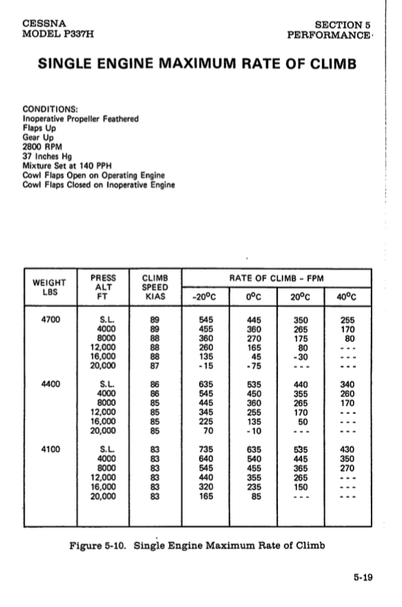

I have attached the single engine service ceiling for the P337H - if someone could post for the non-turbo'd Skymaster it could give you a basis for comparison.
Also have attached numbers for single engine rate of climb because if eg. you are taking off from Sedona airport at +20 degC, can you climb if an engine fails in a non-turbo?
One thing these tables do not include is density altitude. i.e. if you lose an engine at near max gross on a very hot and very humid day, can you even maintain eg. 6000' in a non-turbo?
These guys had a turbo but did not follow the POH and push up the MP into takeoff power ( http://generalaviationnews.com/2012/...l-it-cost-you/ ) i.e. 37"/2800". She left it at the top of the green arc i.e. 33" and crashed. What is the max MP on the non-turbo version? And it goes down 1" for every 1000 ft in a non-turbo.
Food for thought...
Also attached the both engines rate of climb for comparison.

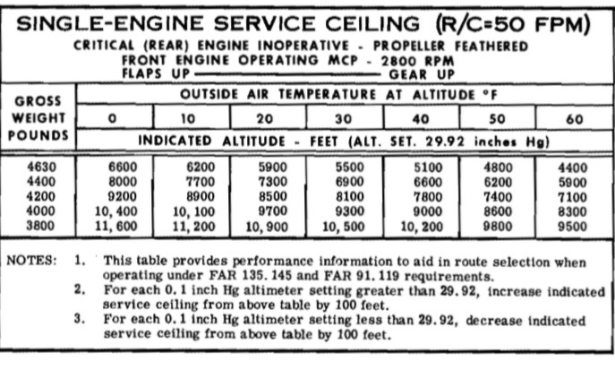

Single engine service ceiling numbers are attached for a 1971 (non-turbo) Skymaster. Just to illustrate as an example, today it is +70 deg F at Sedona airport (4830 ‘ asl) and say an engine fails at max gross after take off. In a turbo model you will be climbing at ~ 240 fpm. According to the attached table, in the 1971 model you will have to descend. Obviously those who fly the non-turbos already know this. This also implies that say it is 80 deg F and humid, you will be lucky to maintain even 4000 feet at max power if an engine fails. Anecdotes re turbo vs non-turbo are entertaining, but the only anecdote that really matters is the one that you got yourself into when those Swiss cheese holes line up.
So like anything in flying you have to weigh the pros and cons (for turbos cons include the weight, the cost of maintenance/repair/overhaul, you have to be more careful with MP settings and treat them right, and it’s another thing that can fail in flight), and make your choice. Personally I chose turbo for all the reasons in the P337H tables attached earlier.
