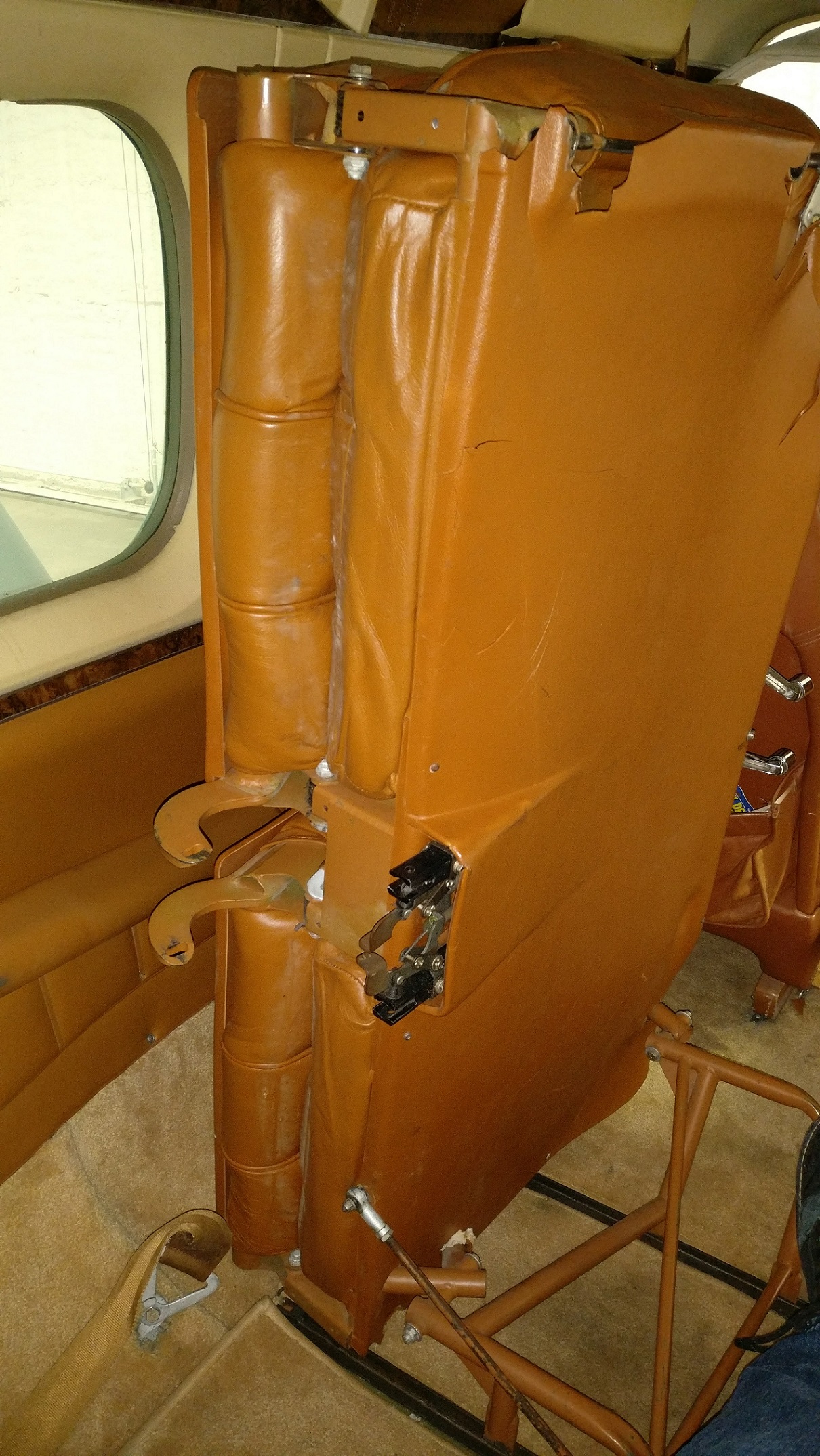

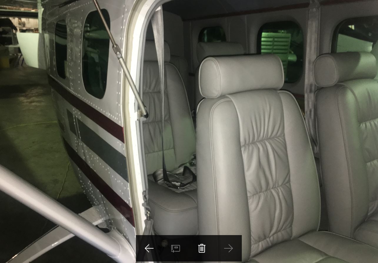

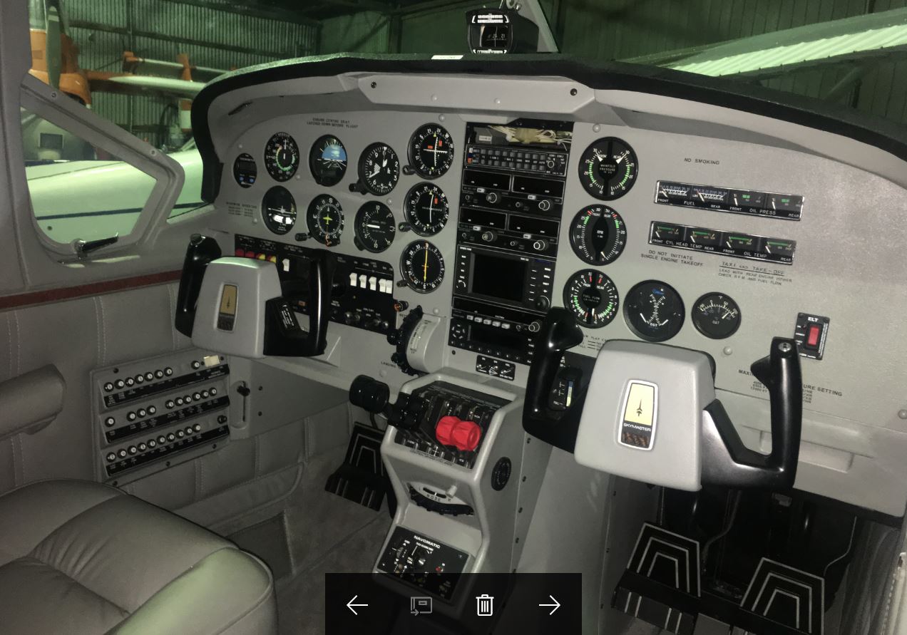

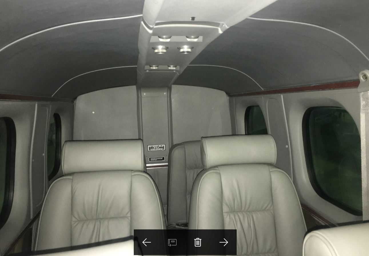

I have a question and an ask, I need help from those having 74G. They are related to the middle seat (been 7 years since it was disassembled) and the manual is just not that specific.
First question: When you move the white knob located on the front lower right of the seat base which releases the back rest's, do they spring forward by themselves?
The ask : Middle seatbelt locations, I am not happy with the location, could I get a photo of the belt mounting on another 74G for the middle seat.
Some photo's of the interior......
Yes they do...I've attached a picture of mine a couple weeks ago prior to interior removal. Not great pic, but....
Send me your email address and I'll send you a link to my album of interior pics prior to taking it apart.
Your aircraft looks just amazing btw.
