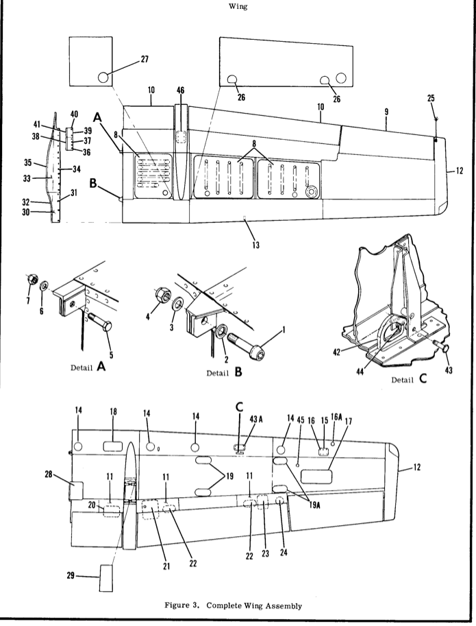

SID's - Front & Rear Spar Eddy Current (bolt hole)
Hi Everyone
I need some thoughts on this matter from other members of the forum, last week all SID's were completed on my plane with the exception of the front and rear spar bolts / screws.
Aircraft is 33701575 (1974)
In my aircraft these two bolts / screws do not exist, they are rivits and are factory. The SID's which my aircraft S/N falls into still specifies the removal of the bolts /screws to complete the stated eddy current inspection of the bolt hole. They even show the photograph of the bolts / screws.
1. Does anyone have information or documentation from Cessna regarding this?
2. Has anyone completed the SID's on their aircraft which has rivits, and what did you do?
A previou post mentioned a discussion with Cessna had taken place regarding this particular issue - the response was remove the rivits and replace with bolts / screws.
I have a window of opportunity to finalise this last remaining SID tomorrow, do I remove the rivits?
Appreciate and assistance with this.
  #155
Unread 01-20-14, 12:08 PM
Posts: 2,267
Are you referring to the bolts that attach the wing, to the fuselage? These points would be the spar attachments
The parts book does not refer to anything other than the bolts.
I am thinking that your airplane already has the wings removed (based on photos I have seen) so you must be referring to some other area?

  #156
Unread 01-20-14, 06:28 PM
Posts: 2,267
From Don Nieser
Herb and Dave, my recommendation is ..,. DO NOT REMOVE THE RIVETS IN THE BOTTOM FRONT SPAR TO DO THE SID INSPECTION!
The problem is Cessna made a mistake when they wrote the SID. The way the SID is written it tells to do a wing spar Eddy Current inspection of the holes in the bottom front spar at the area just outboard of the strut attachment and they made it applicable to all 337 and 0-2 Skymaster serial numbers. This SID inspection is exactly the same as the original Wing Spar AD put out by the FAA, AD 78-09-05. The mistake by Cessna is that they should not have included all serial numbers in the SID!
If one reads the 337 Wing Spar AD 78-09-05, one will find out that it correctly does not include all serial numbers because the 337 aircraft with serial numbers higher than 1852 wings were beefed up (made stronger) and did not have the screw/bolt holes in the bottom front spar. The late model wings had rivets in the location that The AD 78-09-05 and the SID say to Eddy Current the screw/bolt holes. It is absolutely ridiculous for people at Cessna to tell him to drill out the rivets. This is not the first time this issue has come up. I tried to get Cessna to make a correction to the SID, but they don’t listen to me.
My recommendation is to make a note in the log book stating that the AD 78-09-05 has been accomplished on the wings and the SID inspections have been accomplished up to the but not including the Eddy Current inspection of the screw/bolt holes in the bottom front spar because Cessna made an error when they wrote the SID.
Herb, what is Dave’s aircraft serial number? What is his last name? I think Cessna should put out a letter to all 337 owners of aircraft with serial numbers greater than 1852 stating that the SID is not correct.
You can post this on the SOPA web site message board or I will when I get time.
Don Nieser
Commodore Aerospace Corp
405-503-4686
