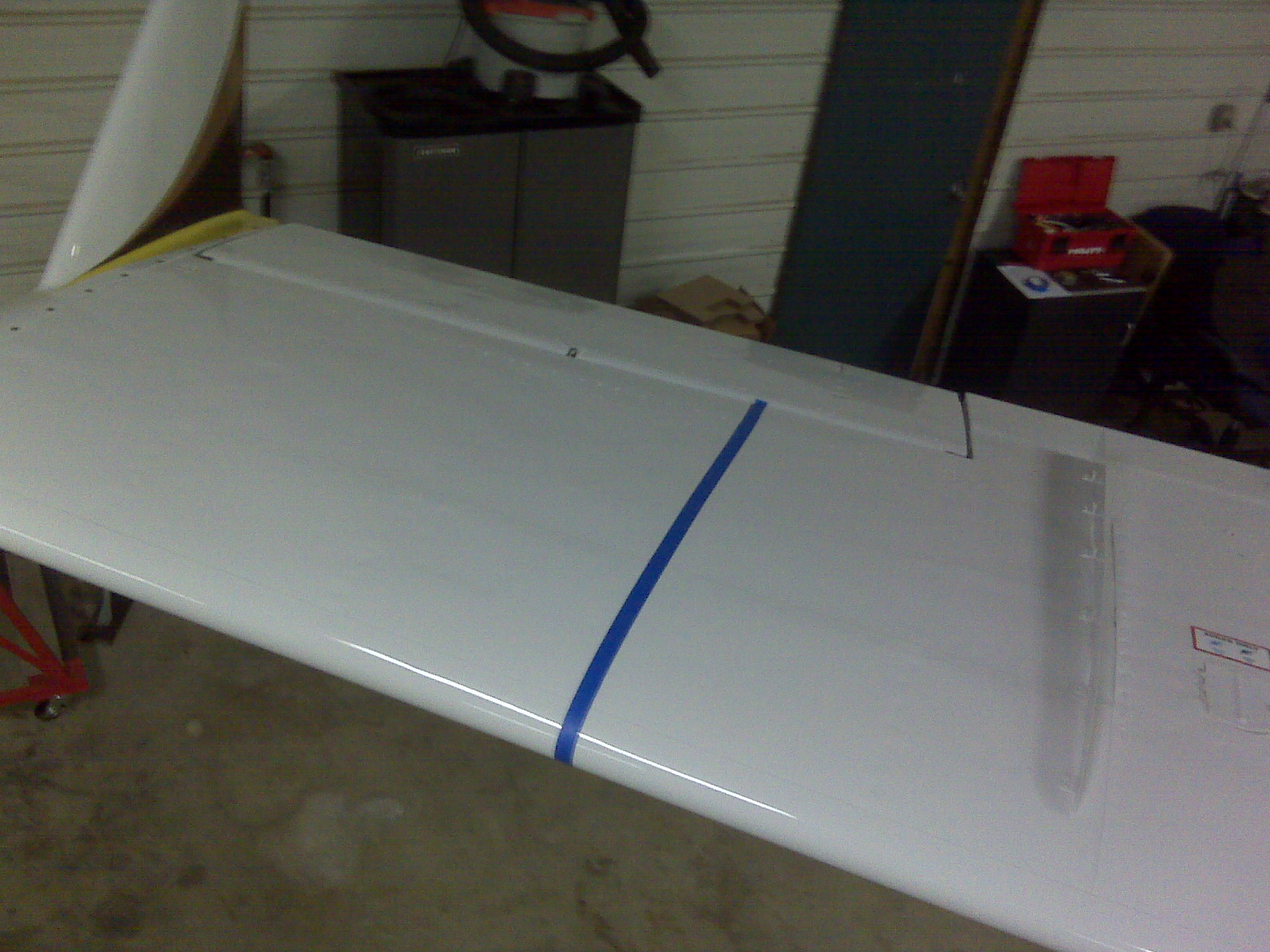

Just for a visual, here is the location of Station 177. It is 46 inches from the end of the wing not counting the wingtip.

Thank You
It is way out on the wing, and the strut held. This should be an argument against the SID, at least the strut inspection.
