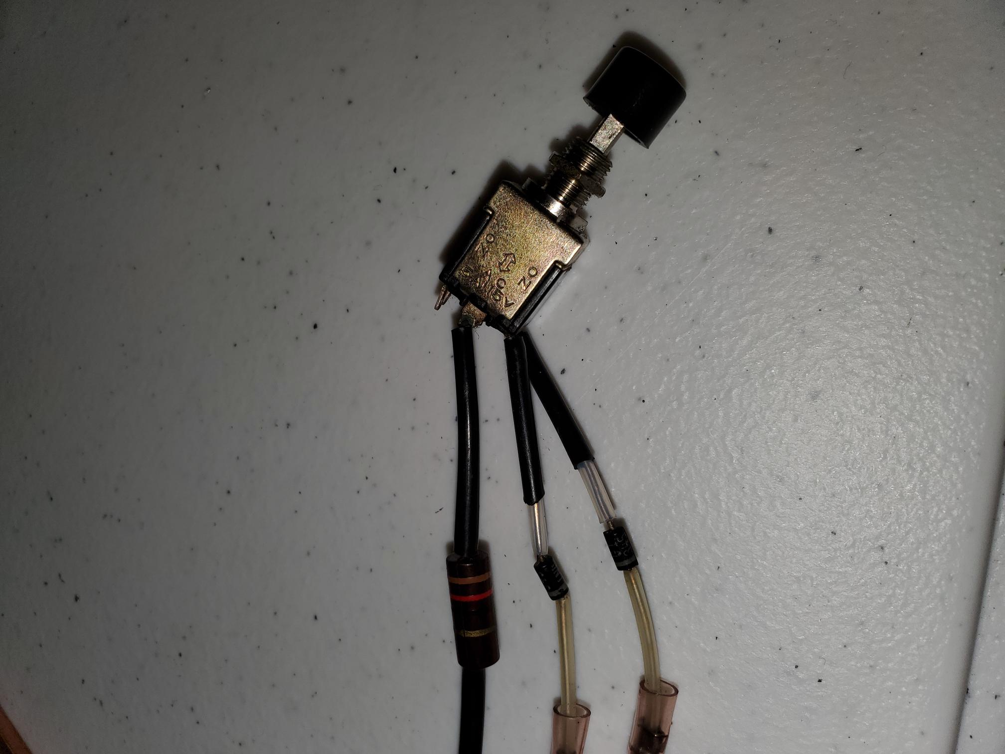

Unread 11-23-21, 07:17 PM
Posts: 293
Rick,
I found the "droids you were looking for!" :-)
Here's a photo of my ALT RESTART switch, as removed from my panel yesterday. A previous owner removed the ALT RESTART battery pack years ago, so during this recent annual, I opted to remove the switch, and will document the removal in the logbook.
Hope this helps!
-LJ
--Upon further reflection, the ALT RESTART switch is going back in the panel. Turns out, there is a no-kidding emergency checklist called TOTAL LOSS OF ELECTRICAL POWER that calls for pressing that button. I guess I'll add the battery pack back in too...but I'll be very reluctant to press that button unless the checklist calls for it (for all the reasons described in other threads).

Unread 11-25-21, 08:47 AM
Join Date: Apr 2019
Location: KLOU
Posts: 194
Rick,
Hope this helps!
-LJ
Learjetter, thank you for posting the pictures.
I did get access to the resistor and the diodes and checked them; they are good.
Even after bypassing the resistor, the switch, and the diodes, (by running a test wire from the dry cell batteries directly to the field terminal on the alternator) the same problem exists. As soon as the wire from the batteries touches the alternator's field terminal, the voltage drops to zero. There must be something in the alternator that's causing this behavior. BTW, the alternators work fine.
I'll tackle this problem again on Monday, and report back when I have anything significant to report.
