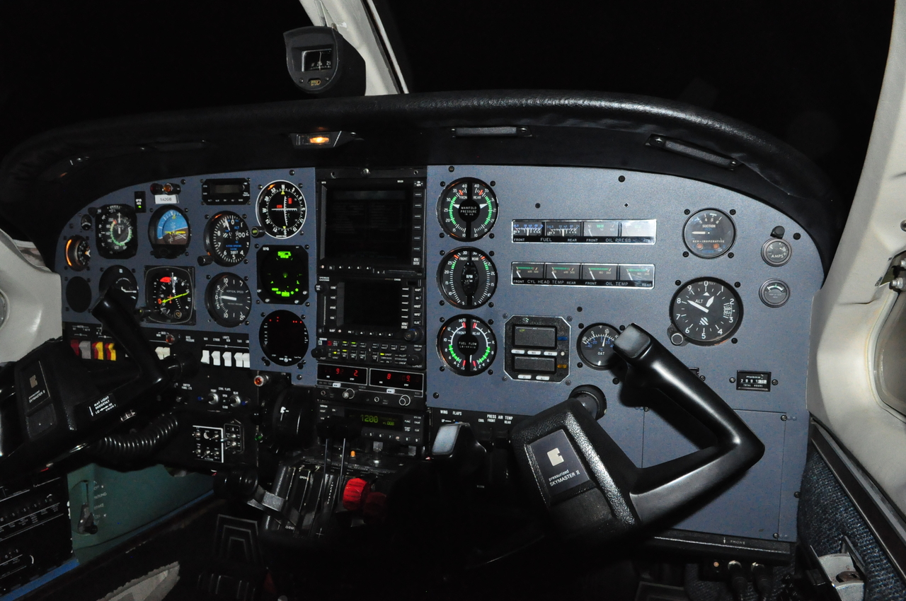

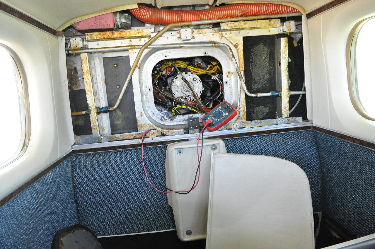

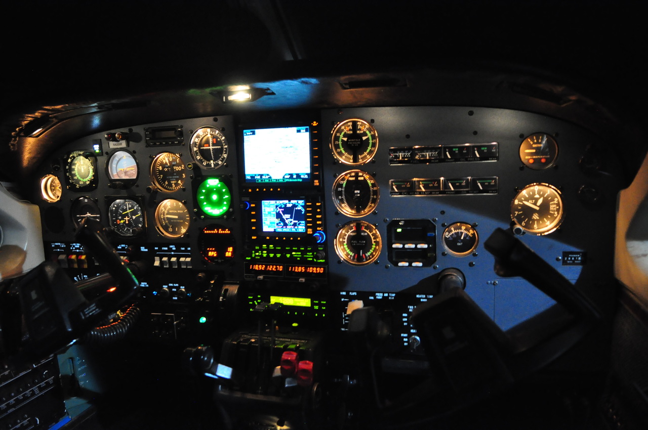

I'll see what I can do about the pics of the courtesy light wiring. Here are some of the new LED, the panel at night, and the rear engine access port. Sorry about the poor focus on the night shot.
Question - why is there a light in the center of the dashboard that shines in your eyes? You can see it in my panel shot. Is there supposed to be a red lens? Because I can't imagine why you'd want it on to kill your night vision.

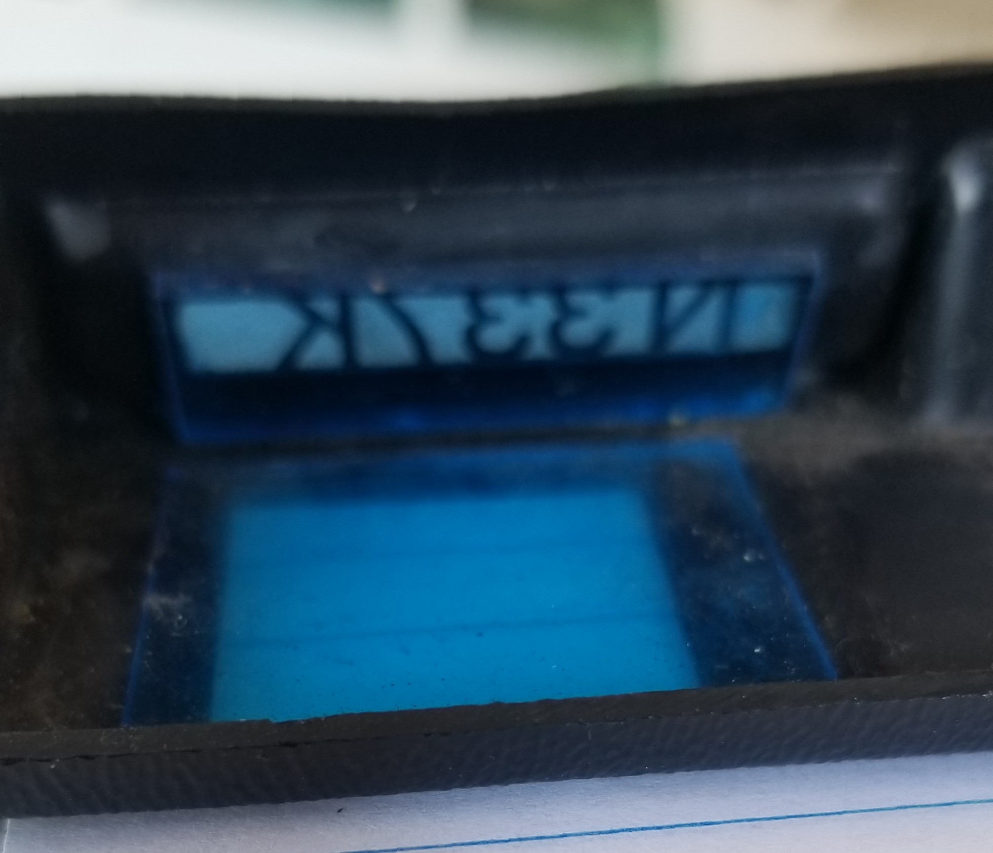

The bright light on my plane is covered by a frosted lens that has the registration number on the lens. I've attached a link to a picture of it to this post. (Don't be confused by the N9KA in the link as it's just part of the link.)
Cool, I guess I can see why they did it now! I looked at some of your other photos, and it would appear your CHTs are a bit warmer in the rear as well.

Here are some pictures of the lens holder with dimensions. The characters need to fit within the frame on the backside so they'll show through.

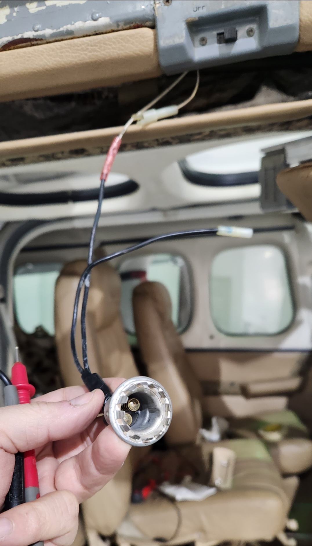

Thanks! I checked the fuse—looks OK. The courtesy lights in the headliner above the 2nd row appear to work, as does the dome light. But no voltage on the wires headed towards the clamshell door, and the pilot map lights are inop.
On the plus side...the panel lighting is terrific!
Today, im on the same mission... Where did they route the positive wire on the door for my courtesy light? I looked all around the piano hindge and for the life of me ai cant see how they routed that wire...also my map light is also not working either...but one thing at a time....
Previous owner hid the courtesy light behind the door panel, why IDK... but im not getting any power to it...i checked the fuse on the firewall fuse holder which is good.

My wires show in the center of the door, right across the piano hinge, then snake down inside the upper door trim past the door lock to the bulb holder. I wired both the overhead MAP light and the courtesy door light to the same power wire from the fuse holder on the firewall. That way I can turn on the map light to see the panel during preflight at night, since the dome light didn’t quite cut it.
You may want to remove the upper door trim, and ceiling panel above copilot seat to gain access to the right wires.
