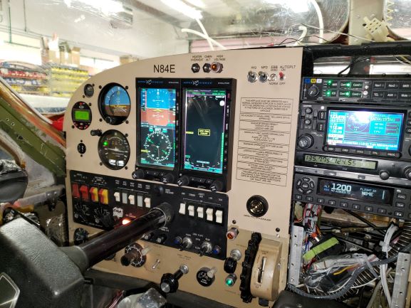

This has been a tough install, but we're almost done. New pics for the new panel. Next up, interior install.
Scott

Unread 04-03-19, 12:05 PM
Join Date: Dec 2017
Location: POLAND
Posts: 71
Scott
Congratulations, your panel looks great;-)
