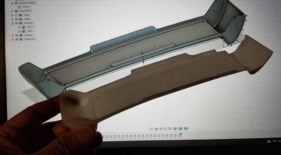

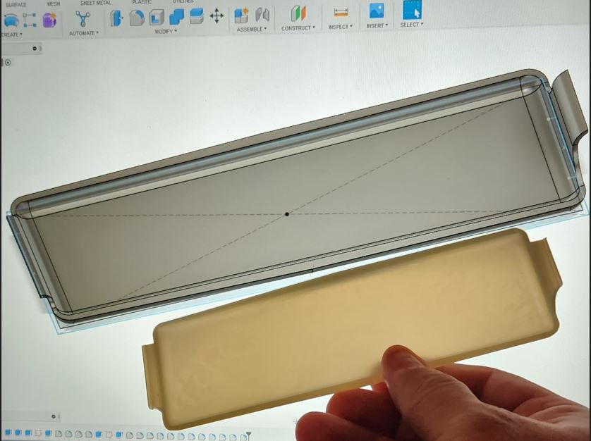

A HUGE THANKS TO DAN FOR SENDING ME THE PART TO REPLICATE!!!
ONE STEP CLOSER...now for the hard part...3D Print to resin cast. This part will take some time as I need to order some materials i.e epoxy resin, silicone mold stuff, etc....
I will try a couple of different opaque white colors to full transparency. I also added some extra material (not much) to where by looking at the part is a bit more fragile or where its more prone to crack.

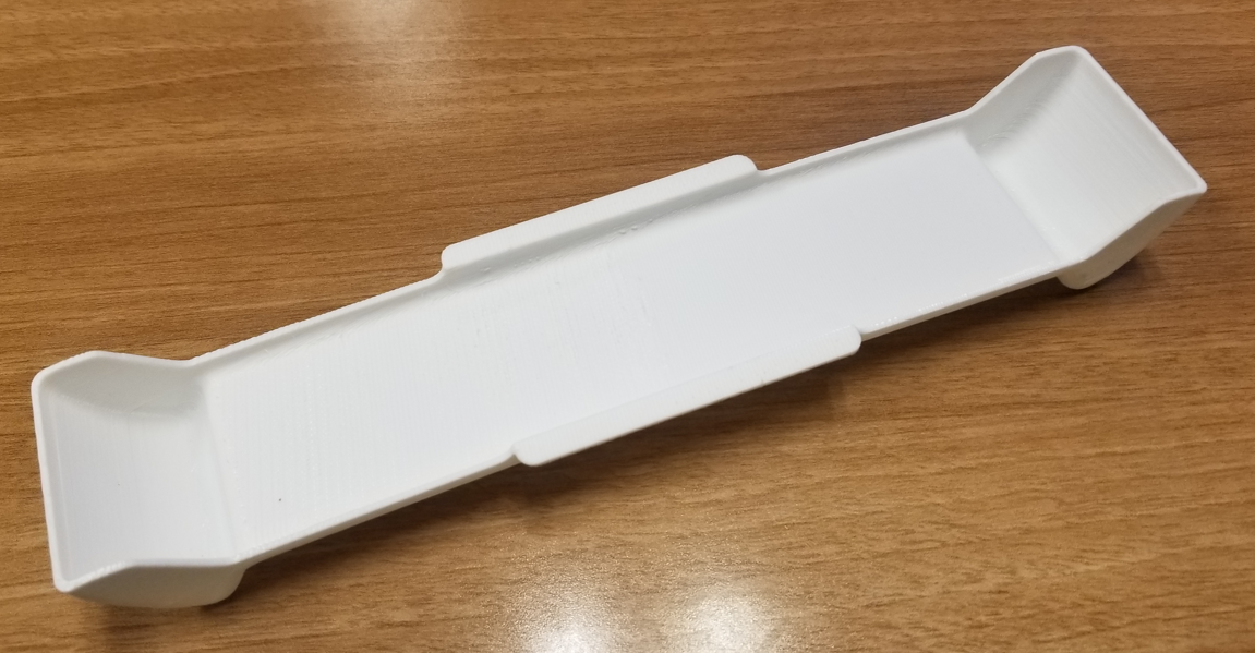

Attached is the first 3d test print to verify measurements, etc...then I will get a clean part done for casting.
Its Progress!

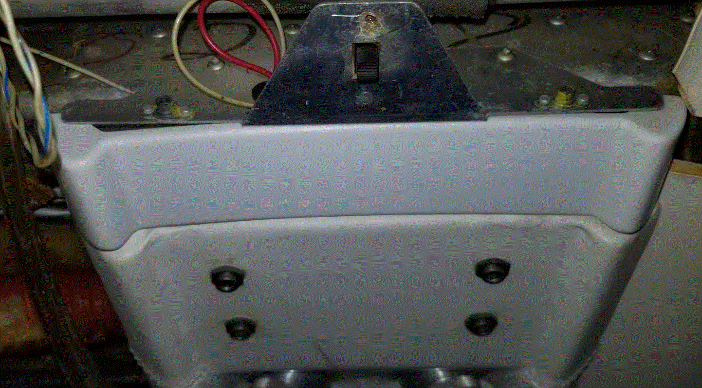

Progress Update
9/13/22 UPDATE:
So I test fitted the dome light before I start casting. The fitment was perfect. I have the silicone on hand, Im waiting for the UV resistant resin to come in. Keep in mind this is just a 3D test print using white PLA filament.
I will experiment the castings to have the same translucent opaque offwhite as the original.
Sorry for the missing panels...my plane is in the shop going through an avionics upgrade.
