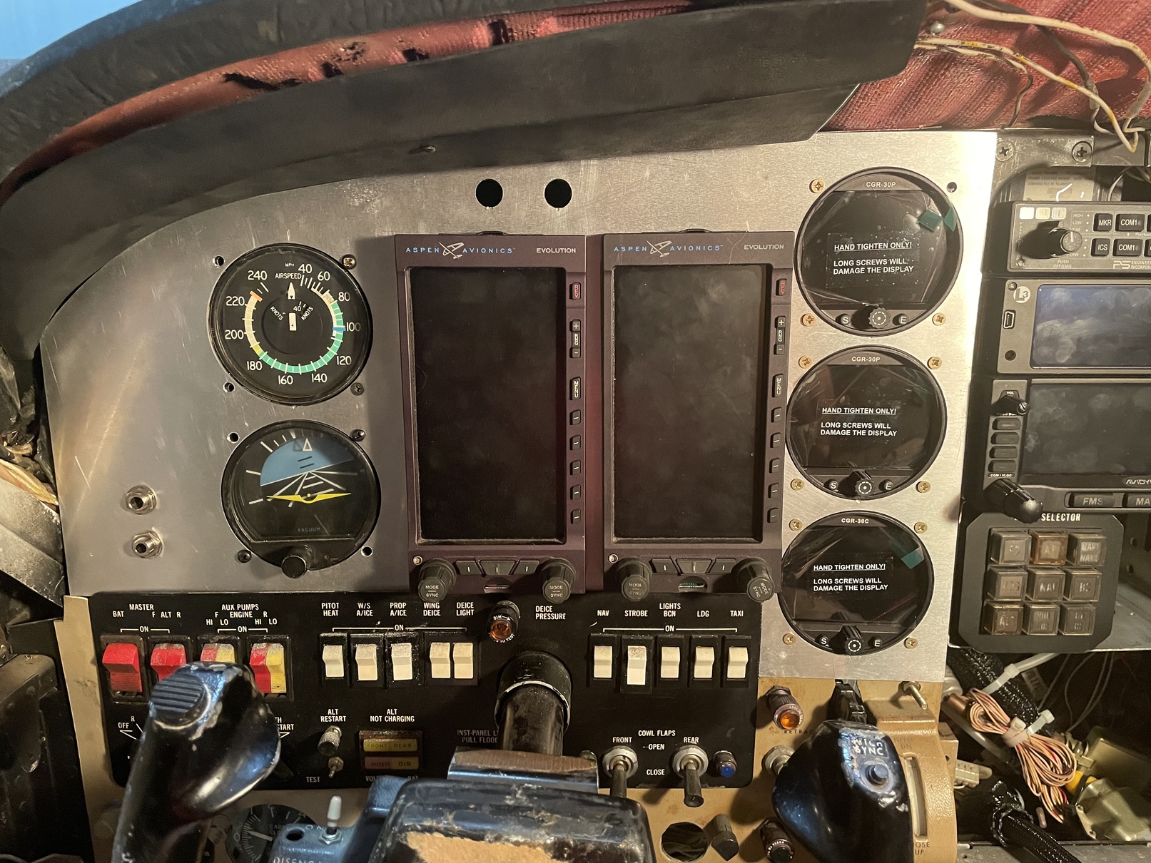

Just got all the instruments situated last night.
Attaching pics after I create the link.
File Type: jpeg 45AE4144-5D9B-417C-BA11-F24D9B23FE68.jpeg (884.8 KB, 2356 views)
