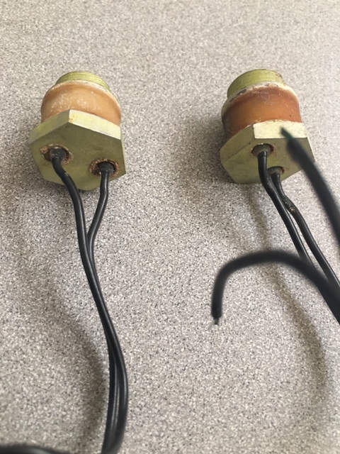

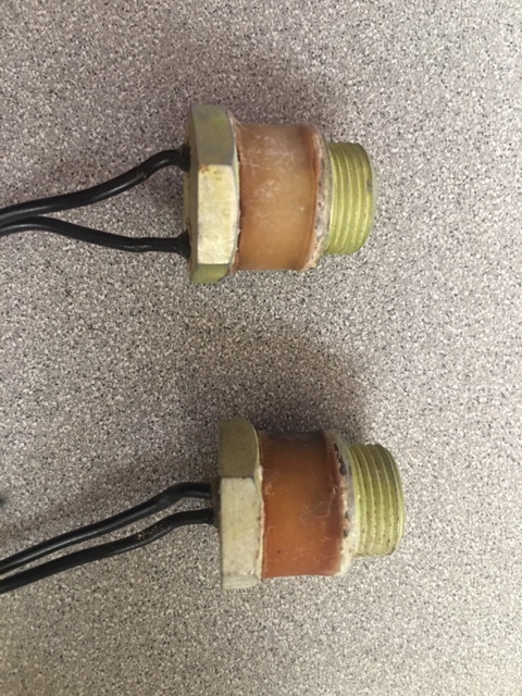

Can you post a picture of this pickup? I might have an extra.
Unread 10-24-20, 02:14 PM
kbecker kbecker is offline
Join Date: Feb 2009
Posts: 118
Is this what you are looking for?
