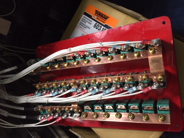

This is the panel I built. I used the Klixon 2TC2 breakers. The 35's are the 3TC2 breakers. It worked out really well. This was a time-consuming project. This will solve myriad of prior electrical deficiencies.

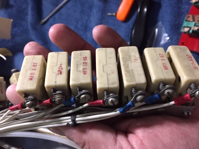

I've included two pictures of Cessna's idea of how to make a circuit panel...
Let me know if I can offer any clarification or assistance.
