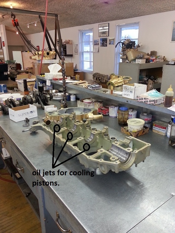

I'm pretty sure the pistons are oil cooled by oil being sprayed on to them via a spray nozzle which is part of the engine case. So it would be a big deal to modify this.
I've attached a picture that shows the nozzles in the crankcase. Hope this helps.
