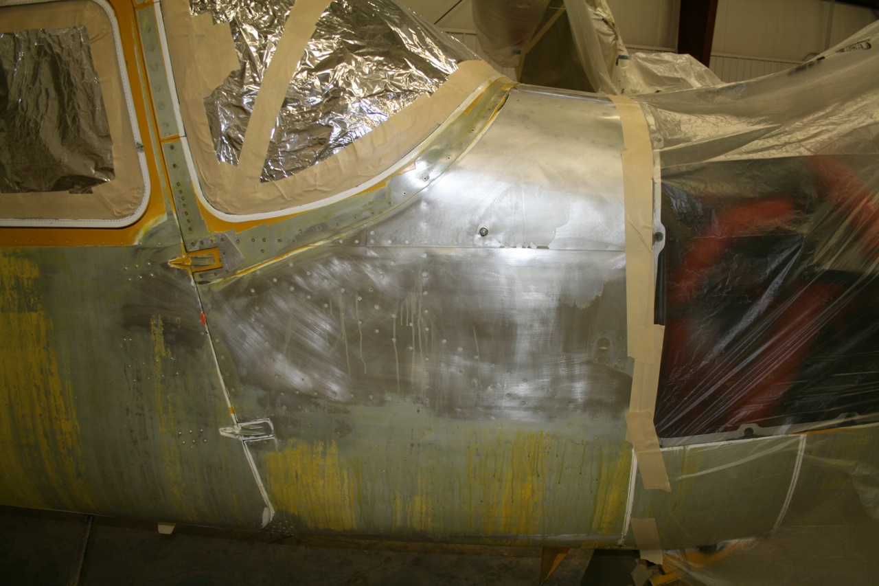

Well it's been 2 weeks and I have not seen the progress I had originally hoped for. I had a Citation in front of me and it's gone. Now the T-6 and it's just starting to get squirted. They have all the controls removed. Cowling is all off and the labor is starting to tackle the original paint. Lacquer. It's a four letter word in a paint shop. The original paint is lacquer from Cessna. It cannot be removed with power tools. It has to come off with good ol' elbow grease. Even though they did the chemical strip, all seams, every seam on the plane was taped to keep the chemical from migrating into the airframe. So the earlier photos above make it look like no big deal but while I was there yesterday it is a big deal. I worked on a couple spots for a long time and not much progress. The use MEK to remove the lacquer. Once the lacquer gets a little soft then it can be scrubbed with a scotch bright pad to help speed up the slow process. I have a deadline date and they promise they will make it with no problem. The new paint will be Polyurethane. The use JetGlo by Sherwin Williams. For some accent and stripes they might use Imron (Dupont) but the JetGlo is the standard. Lots of detail and they know their stuff. It has been a real interesting process so far.

No pictures yet but the aircraft is completely stripped. They really jumped on it last week and removed all that lacquer. The lacquer has to come off because if you spray the polyurethane over lacquer it blisters and bubbles. It's bare bones metal and today they gave it the first shot of primer. Tomorrow I will go down and mount the boom fairings and wingtips so that the second sanding coat of primer can be applied. All the controls are still off and each control is painted independently on it's own. All the little dings and stuff will be filled and a third primer coat will be applied. Then on Wednesday the Matterhorn White will be applied to the entire aircraft. I will have some photos to post tomorrow night. It won't be long now.

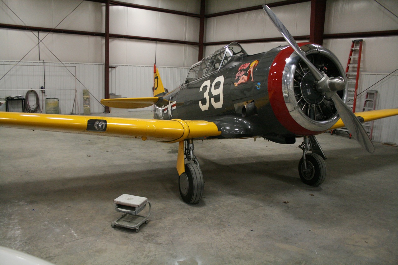

This is another SNJ (not the one above being painted) that was delivered to the shop so they could match the paint on the T6 (soon to be SNJ) that is above. At least 2JF is not lonely, lot's of neat stuff down there.
