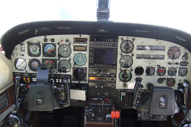

Riley is your best source for ideas. When they were converting the P models to Super Skyrockets they did a spectacular conversion on the panel.
I find that searching the sales sites (TAP, ASO, Controller) you find lots of pictures of ideas including panels.

Yes, that's what I plan to do to mine.
Who is doing the Riley mods now? Do they have a web address?

Riley is out of biz at this time but my suggestion is to talk to some avionics shops in your area and get references to look at and to talk to customers that have had this work done.
Here's even a better idea, come to the SOAPA meeting/convention in June 2008 and you can see these planes in person. This is a 336 that belongs to Walter Simondinger that is a perfect example of restoring an aircraft especially what he has done to the panel. Great job Walter, please come to Michigan in June of 2008 for SOAPA. He even has the Beechcraft control yokes. Sweet.
