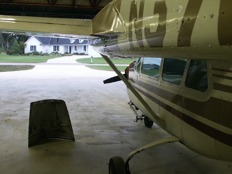

Okay, you are right, it does take a lot of imagination, and examination. So, it was a nice day in the neighborhood.
With the help of a couple of my neighbors, I got it traced out.
Unread 08-22-05, 09:32 PM
You can see, not much traffic in the neighborhood.

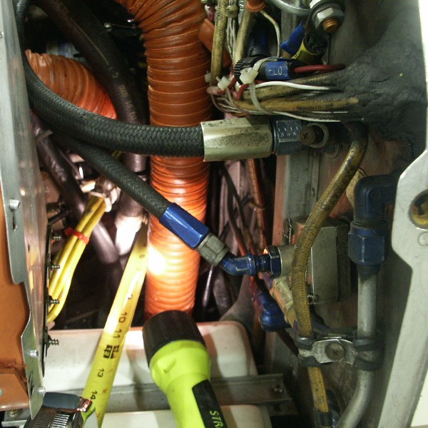

So, the hose, goes under the airplane, up next to the wheel well door, where there are lots of pipes coming out, and connects to one of those pipes. I could not get a picture of the pipe, but this is where the hose goes up into the airplane.
Unread 08-22-05, 09:36 PM
Now, you would think it would be simple from here, but it isn't. The pipe connects to another hose, which runs up to another pipe, before it goes through the baffles.

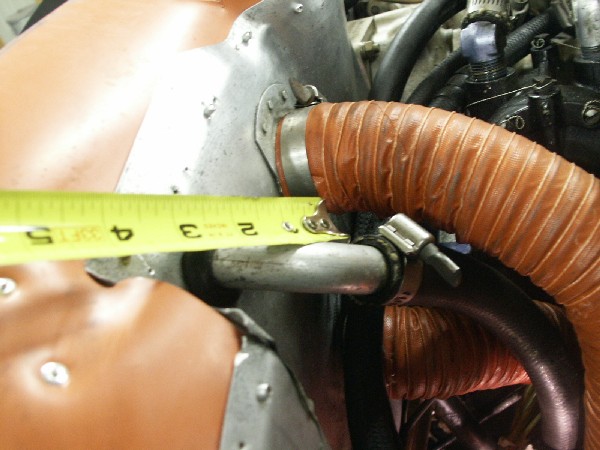

So, here's the pipe going through the baffles
Unread 08-22-05, 09:40 PM
Now, that pipe, when it goes through the baffle, gets properly firesleeved, and goes all the way to the front of the engine, to the crankcase vent. Now, try as I could, I could not get a picture of the vent thing, so use your imagination from this point to the front of the engine. Look for a pipe, hose, like this, and go to where it terminates.
