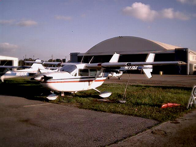

Here is a Picture of 1735Z finally Home afther 2.5 years
