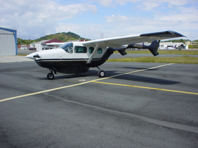

The pod mounts to the bottom of the airplane, and since you seal the floor, it should be doable. I know that Chachi has a pod on his '73, which is the same configuration as your pressurized model.
It should be very doable.
Unread 03-25-03, 07:23 PM
Posts: 59
Larry, yes as you can see mine has the pod but it is a normally aspirated 75, 337G. Never heard of, or saw a P337. Chachi

Fabulous paint job!! My pod has a lighter color paint and I am constantly scrubbing exhaust remnants from it. I suspect repainting the pod would save alot of elbow grease.
Pat
Unread 03-28-03, 11:30 AM
Posts: 59
Pat, with the dark color on the pot and the rear engine you do not have to worry about how clean it looks after every flight. I used a dark green
