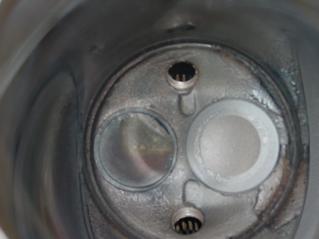

just finished repair and install my s-tec 65 ap. stec says 8000 hours mean time before failure on the tand b . its been broken for three years. looking forward to using the rate based unit. FYI finally got the last two cylinders on rear motor topped. GMAS was probably right recommending replacing all at once. but it took three years . the airplane had been sitting a couple years because previous owner was trying to get his medical returned. Looking at the cylinder valve condition i am not ever going to replace a cylinder with anythin but new. the old ones were o/h . lucky for me they did not spit metal. 73 p. j

turn bank/cylinder
wanted to share the photo of valve damage. J
