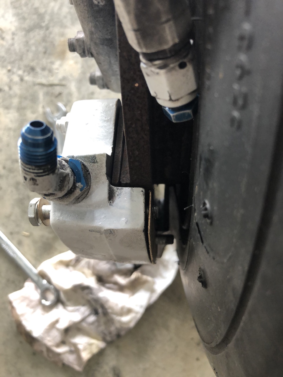

Just resealed my calipers 30-69B heavy duty brakes. Pads are about the same thickness as new not changing those have them though. Putting the calipers back on the wheel, disc thickness is within tolerance above .330, new shim installed and there is about 3/16-1/4 inch that the pistons have to come out of the caliper to take up the space, seems excessive to me, what have you all found with the heavy duty breaks?

Mr. Schultz,
From your picture, after you attach the backplates to the cyl assy, and torque them to spec, you will find you will have to compress the pistons / pucks a little bit to clear the wheel disc. The "excessive space" will go away.

Pistons are flush in the housing. The issue is how far out the pistons will have to come out to take up the clearance.

From what I see in your picture it looks about right. If you finish putting the caliper together and see what you get if the pistons are coming out 1/4 inch something is wrong. I maintained 6 with heavy duty brakes and for the pistons to come out 1/4 inch the pads and disc had to be worn out with new disc and pads the pistons were flush in the housings.
Make sure when you get them back together that the calipers are free to move and not binding and your wheel spins freely

All back together about .080-.090 of clearance that the pistons have to take up rotors are just a few thou below new and pads about 10 thou below new.
Still waiting on Parker, I still think that is a lot for the pistons to come out compared to other comparable installations.

Talking with Parker, with all new parts, pistons will be out of housing .020-.040.
The 07 disc today is the same as the original disc that was welded, new part disc thickness is .365, with a minimum wear down to .330.
All back together works fine
